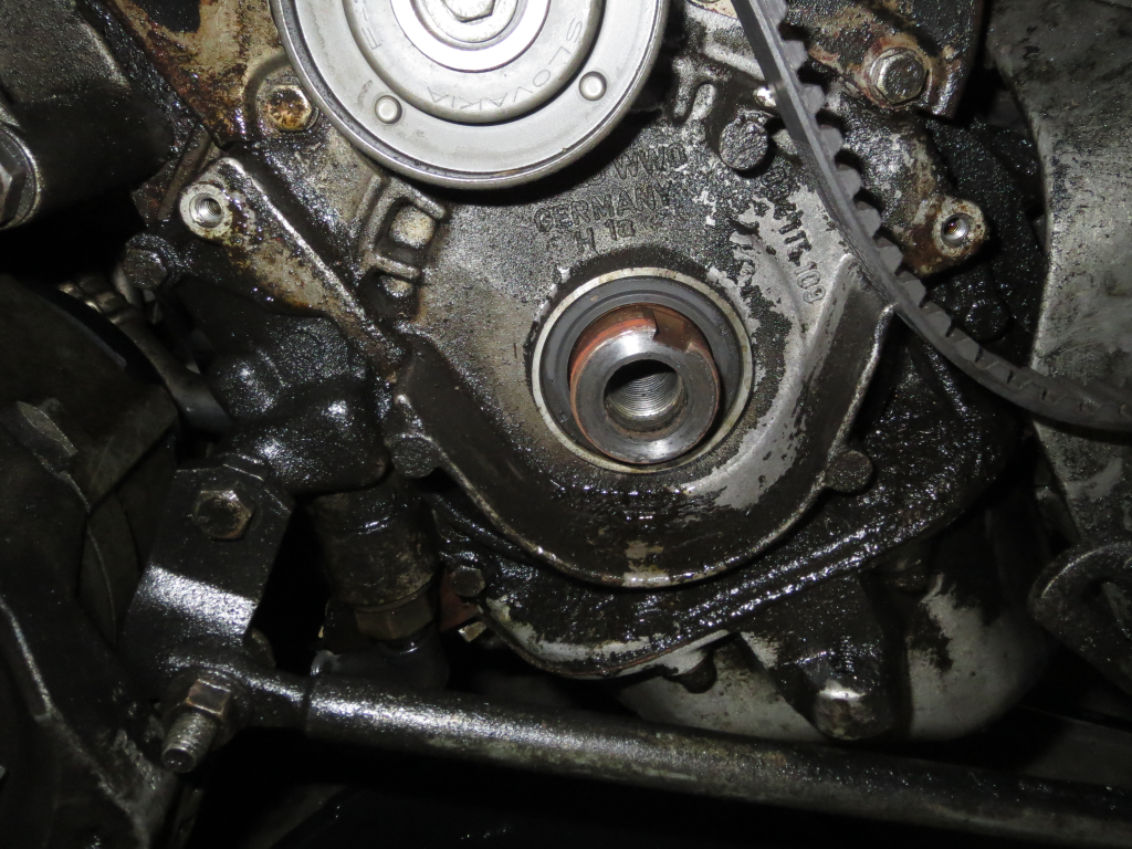

Wow, I'm dumb. For some reason, I couldn't find this while actually working on it: http://aam-europe.contitech.de/pages/pi ... elID=CT926
I'll try it out this weekend. ;)

If you are confident on your parts and work for the:
- Oil pan gasket
- Oil pump gasket
- Crank seal
I would 100% at this point buy a stock OEM cog,tensioner and T-Belt. This could be something as simple as a cover scraping, but until you pull it apart to look you are just guessing.
Have you taken the belts off of the powersteering and a/c to make sure it is indeed coming from the T belt area? If you answered that earlier then ignore this hah.
Re: Kevin's 200 20v + B5
themagellan wrote:If you are confident on your parts and work for the:
- Oil pan gasket
- Oil pump gasket
- Crank seal
That is my advice as well.

Since it was fairly dry, I'm now 97% sure the crank seal wasn't actually bad. I probably just didn't fully tighten the back timing cover bolts when I did the cams - the bolts I've now learned help hold the oil pump to the block. I don't like doing things twice and I had the parts, so I went ahead with the replacement, anyways.
Wooooowwwww, the thing was stubborn. After a weeklong fight with it, trying several different tools and methods, and mutilating the seal beyond recognition, I gave up. The simple seal job ended with me dropping the subframe and resealing the whole lower end. With the oil pump out, I finally pulled the crank seal out with vice grips, and it took a surprising amount of force. It was fused in there.
Upon reassembly, the car ran and there was a noise and blah blah blah, the whole previous page. Despite the (possibly only) snow we had, I had to confine the car to the garage. :wah:
Two things: the noise ended up being entirely unrelated to the timing issues I had. It was simply the back timing cover *barely* touching the cam pulley. I guess the heat is what caused it to come up only after running the car a while. It took about 15 seconds to fix.
Next, I tried my absolute best to get the cams in time with the billet cog installed, but I gave up, inspected the old for cracks, and reinstalled it. Everything lined up on the first go. :) The car has now logged 300 trouble-free miles with no discernible leaks! So now I can finally get started on working on the interior!

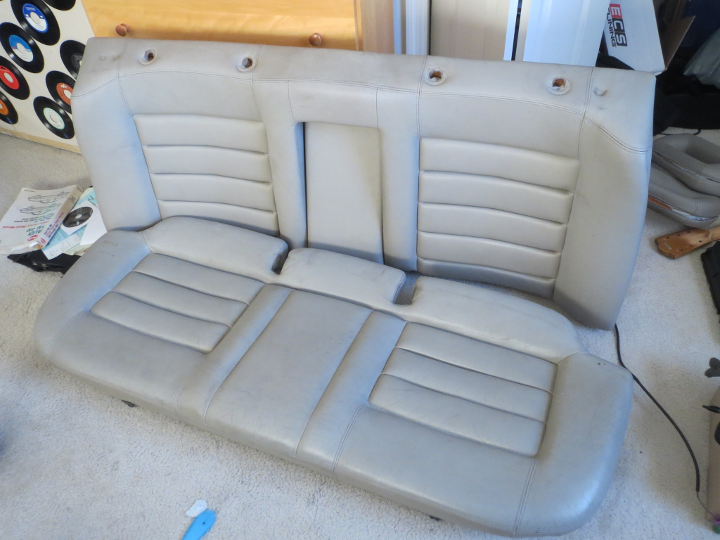

So that's that! I need to sort out the minor fitment issues with the rear UrS seats. I think they look great with the grey, but if I could get ahold of a black interior to contrast more... Mmmmmm.

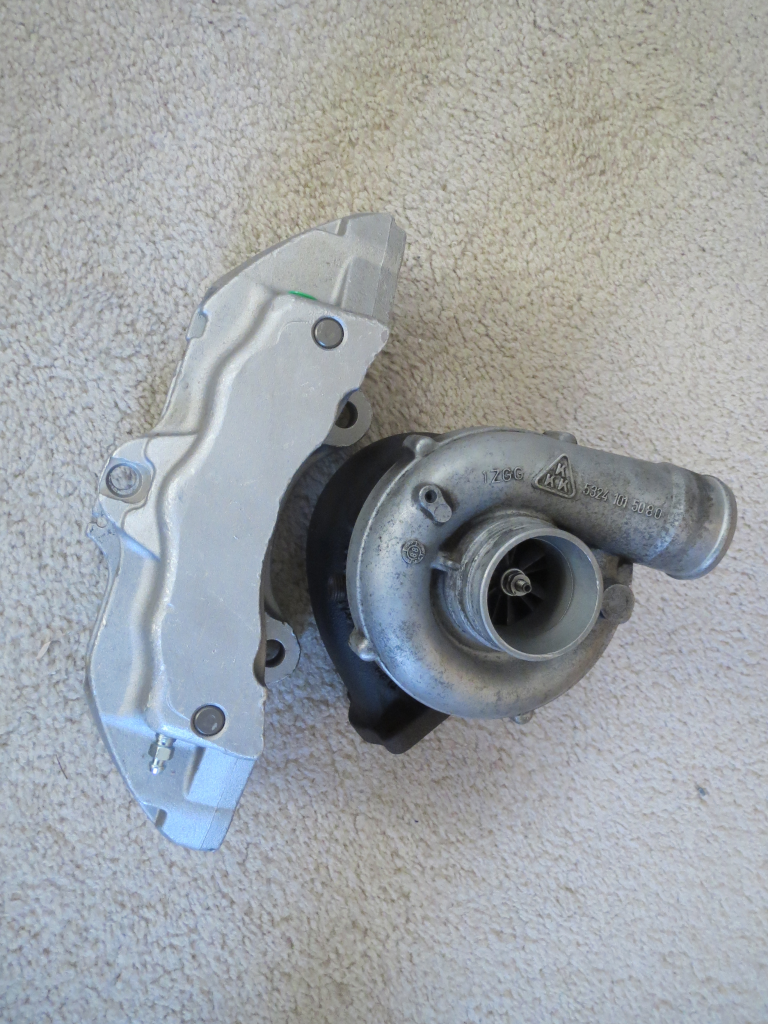

Oh! And the K04 job on the S4 was a success! It's properly quick, so it'll now be getting some massive 6-pot Cayenne calipers (K24 for size). Also, I just got some UFO uprights, sooooo..... free brakes. :drive:

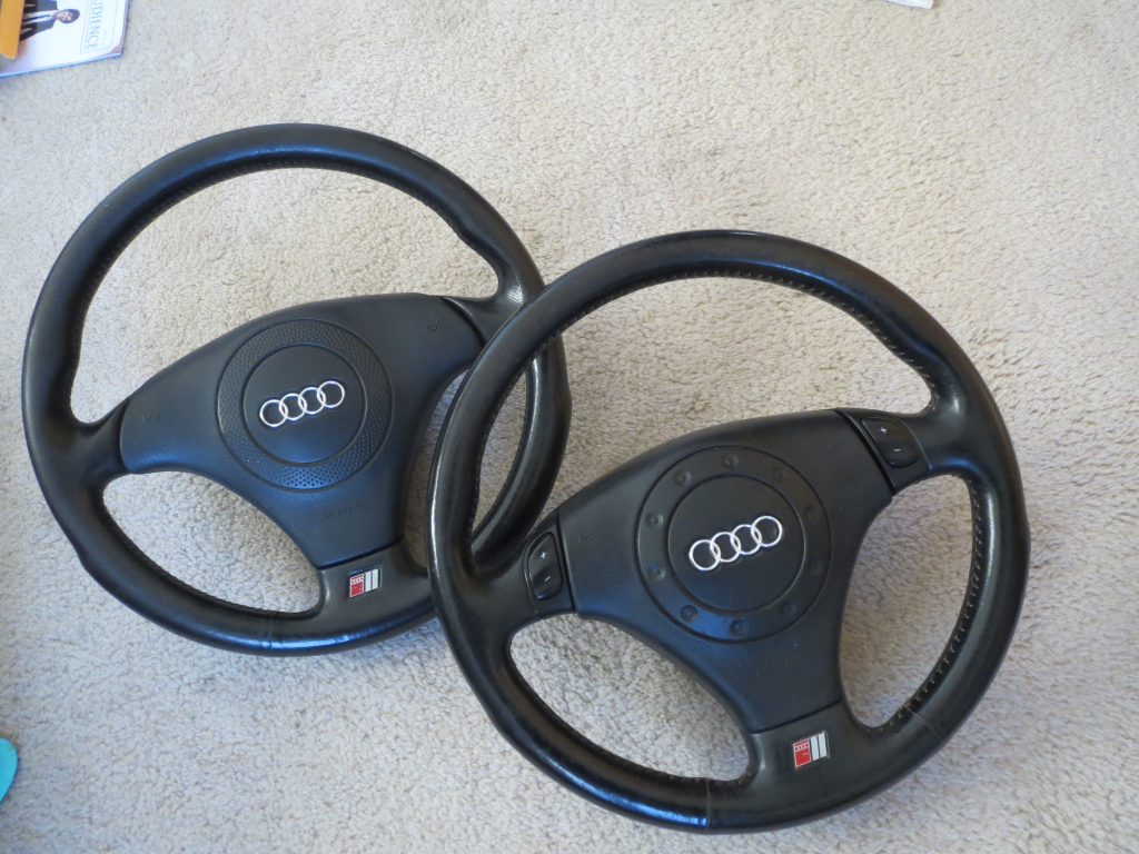

I'm not sure how I feel about the B5 wheel, but anything is certainly better than the stock 200 one. I just prefer something less rounded for the t44. The S2/euro urS4 wheels are the best looking in my opinion, but they don't have airbags so... I fully approve of the airbag wheel instead! It's a worth trade-off.

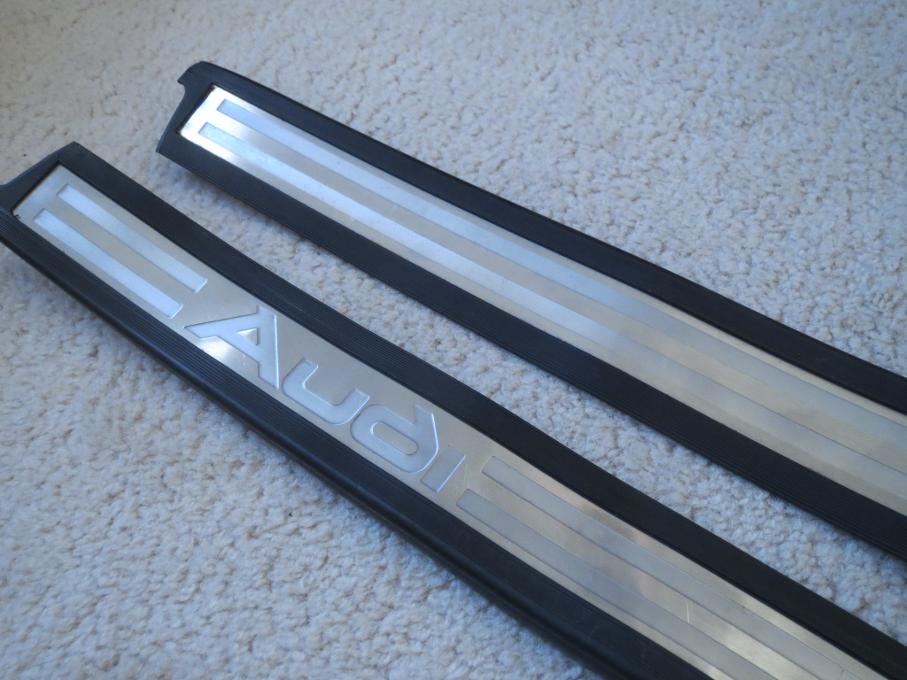

Score on the brakes, and love the door sills too. I probably need to re-apply mine. I did a half-assed job at it when I did mine because I didn't want to make it really hard to get off if I wanted to change them later. I think I used silicone and it didn't work out so well. How are you going to apply them?

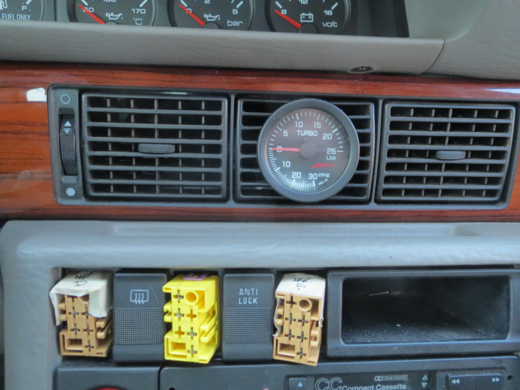

Wow that S2 wheel looks amazing... but I have to accept the tragic fact that the car might be involved in an accident someday. I'd rather not compromise safety for better looks. That said, the thicker wheel and 3-spoke design will be a vast improvement over stock! I like the thinner profile of the airbag section on the late B5 vs. early B5/UrS6, as well as the multiple small dots on the airbag.

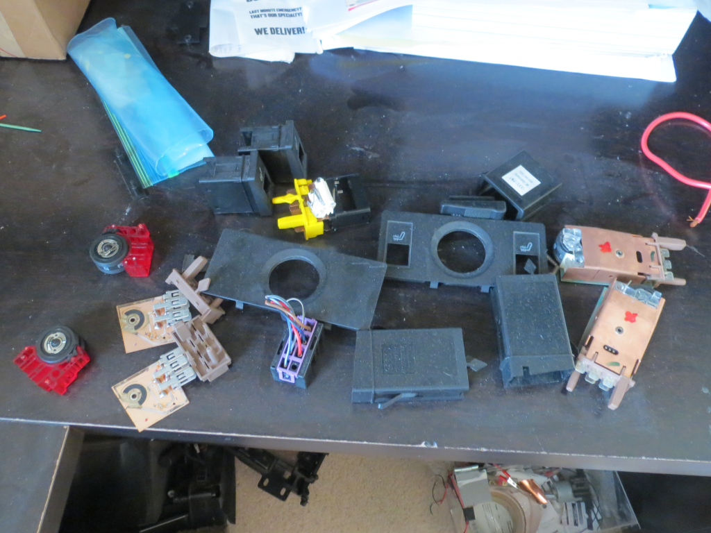

And yes! All lights and switches are in the process of being reconditioned, with as many of them running LED's as possible. I'm also working on adding individual rear seat heater controls. The stock 200 seats would need thermistors retrofitted, but I can just skip that, now that I have the UrS seats.
I thought about dyeing the seats, but I want to figure out what direction I want to take the interior, first. I always thought the all-platinum interior was a bit... drab, so I've recently decided to move away from that. Especially with silver paint, the whole thing car just 50 shades of grey.

Nice work, and agree about the platinum to black seats.

Aktapod wrote:Wow that S2 wheel looks amazing... but I have to accept the tragic fact that the car might be involved in an accident someday. I'd rather not compromise safety for better looks. That said, the thicker wheel and 3-spoke design will be a vast improvement over stock! I like the thinner profile of the airbag section on the late B5 vs. early B5/UrS6, as well as the multiple small dots on the airbag.

I totally agree, airbags for the win. I personally think you should use the tip wheel and use the tip controls to control boost or something like that :)
Interesting on the rear seat heating. I always wondered how they worked. Do they come on when you turn the front ones on? It would make much more sense to have controls for it.
There's a dial below the rear heater vents, IIRC.
What? No way, how did I not know that?
Aktapod
Posts: 443
Location: Denver, CO
Post by Aktapod »
Because our 200's didn't get them!
In stock form, each seat has a pressure switch that closes a heating circuit if someone is sitting in it. Every passenger heating element is powered in parallel by the passenger seat heater relay. Essentially, there's a control 0-6 for the driver's side and a universal 0-6 for any occupied passenger seat. The supplied power is regulated entirely based on a single thermistor in the front passenger seat.
I picked up the rear control switches from the same V8 I got the door sills off of. Currently disassembled, but you can see the 200 vs. the UrS/V8 rear panel.

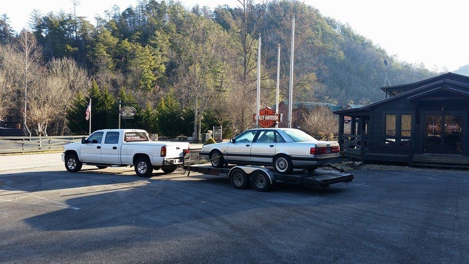

VEMS donations graciously accepted! My mistake was turning off the car before I checked what was throwing the CEL and limiting boost. The instant I pulled it, I realized it probably wouldn't start up again. Oops.
I hitched a ride in my buddy's E92 and came back for the car early this morning. Some shots from yesterday:
And a HUGE thanks goes out to Rich @ European Auto Garage for generously coming out and helping with what would have otherwise been a very expensive tow.
All in all, it was super fun! I'm not upset at all - neither expensive nor catastrophic, and it was bound to happen eventually. I'm ordering the hall effect sensor, CPS and engine speed sensor to avoid anything similar happening in the near future.
