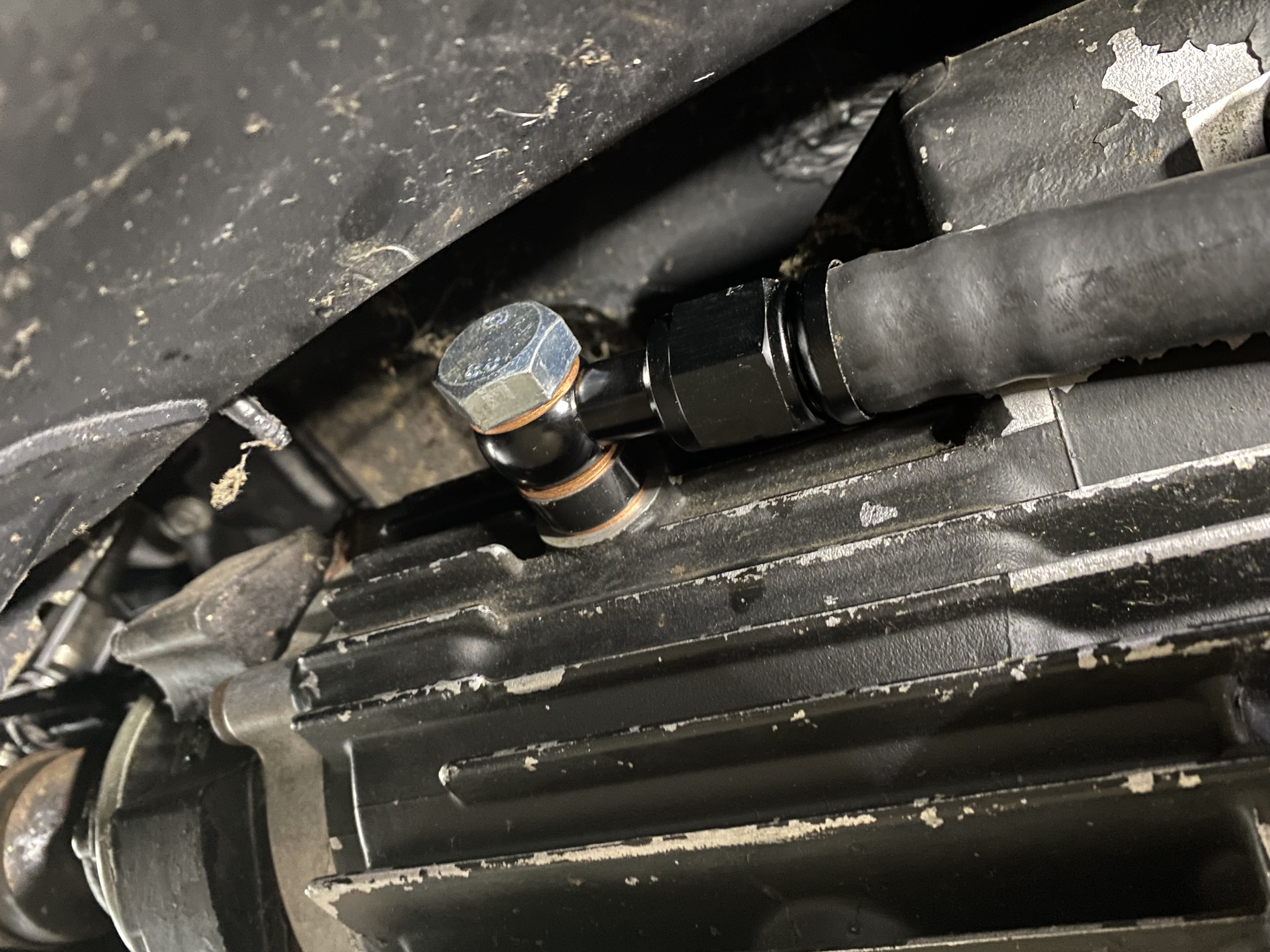

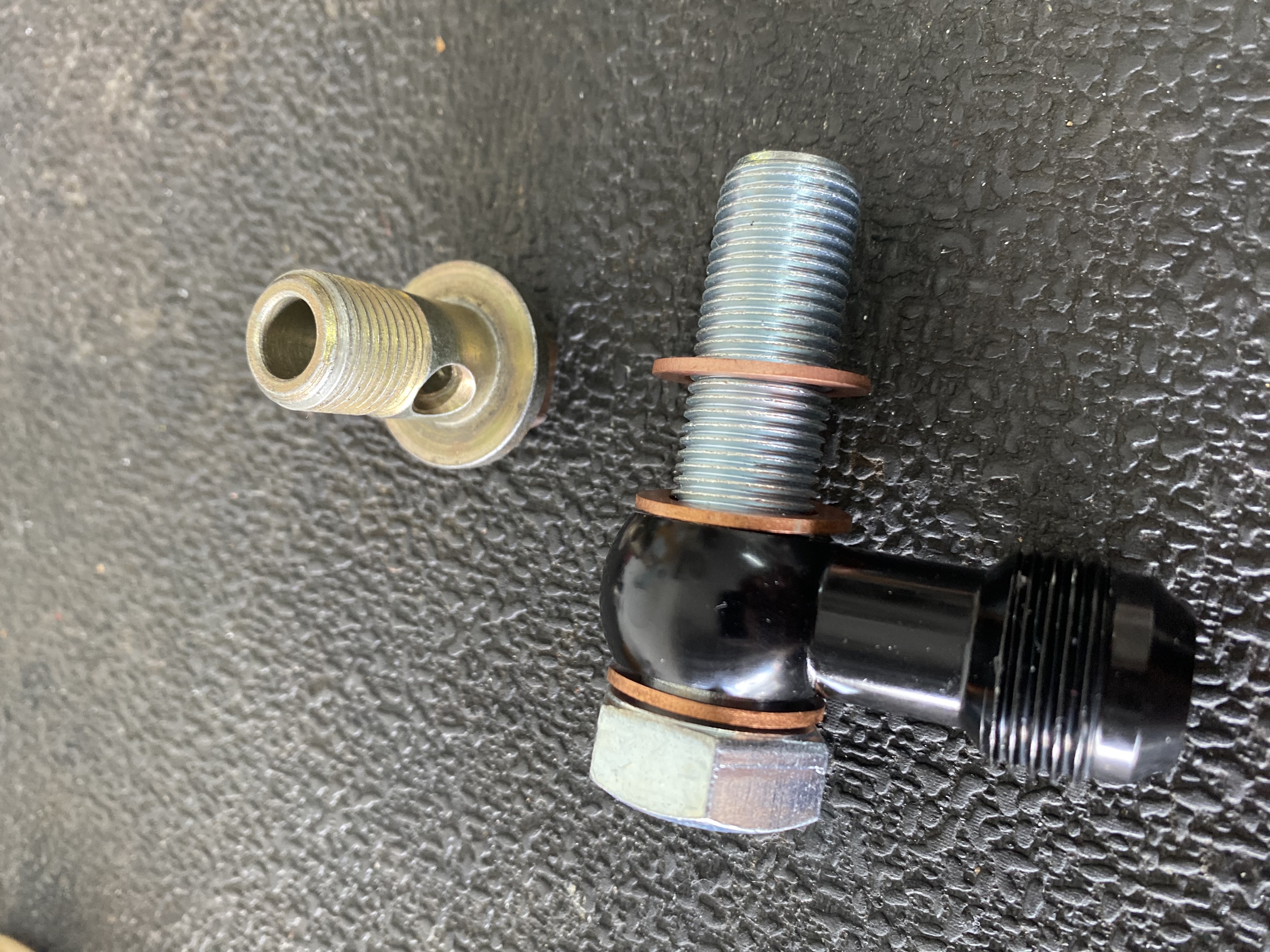

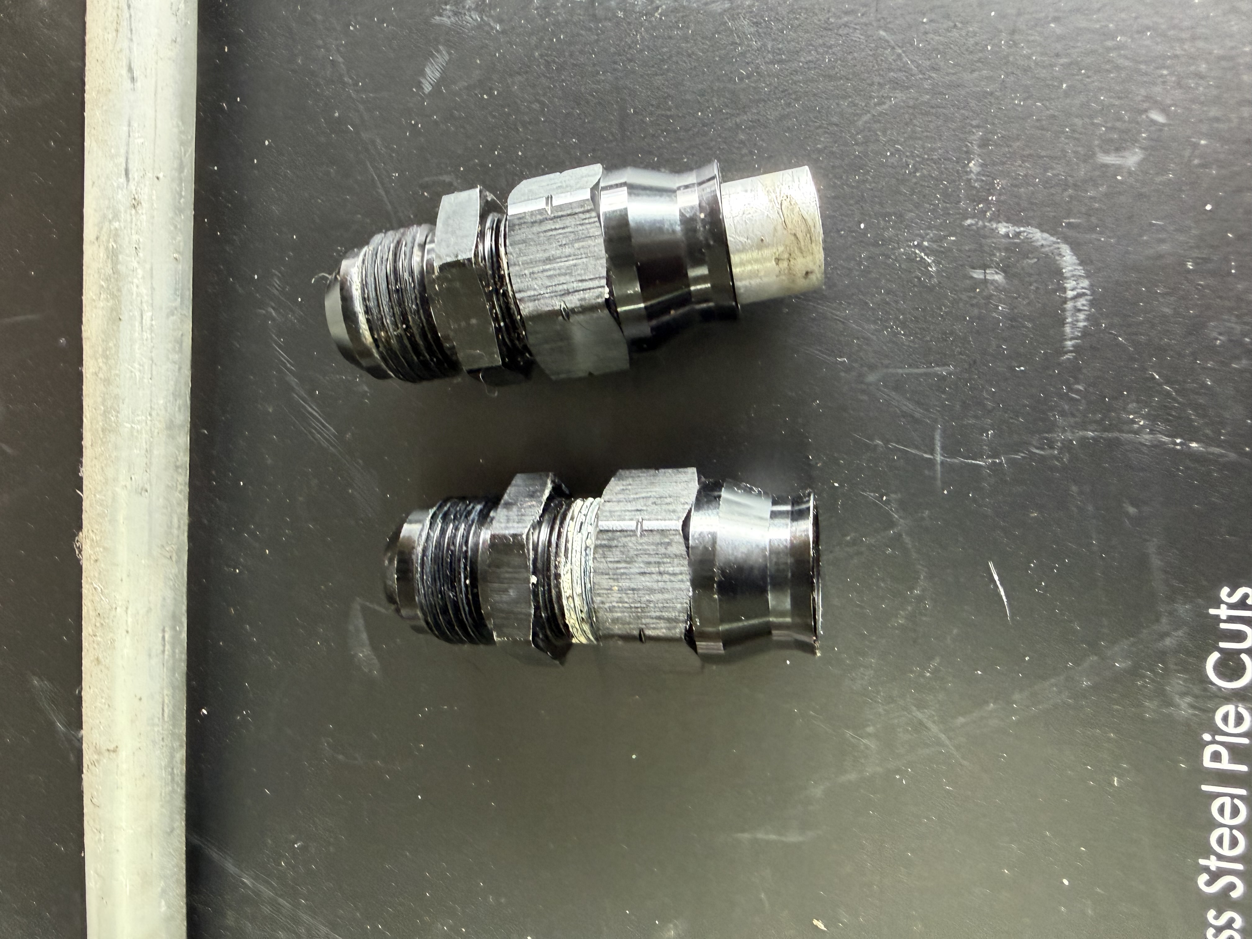

Those -10 push lock hose is too close to the exhaust
Gonna have to make them hard lines up to the bellhousing
