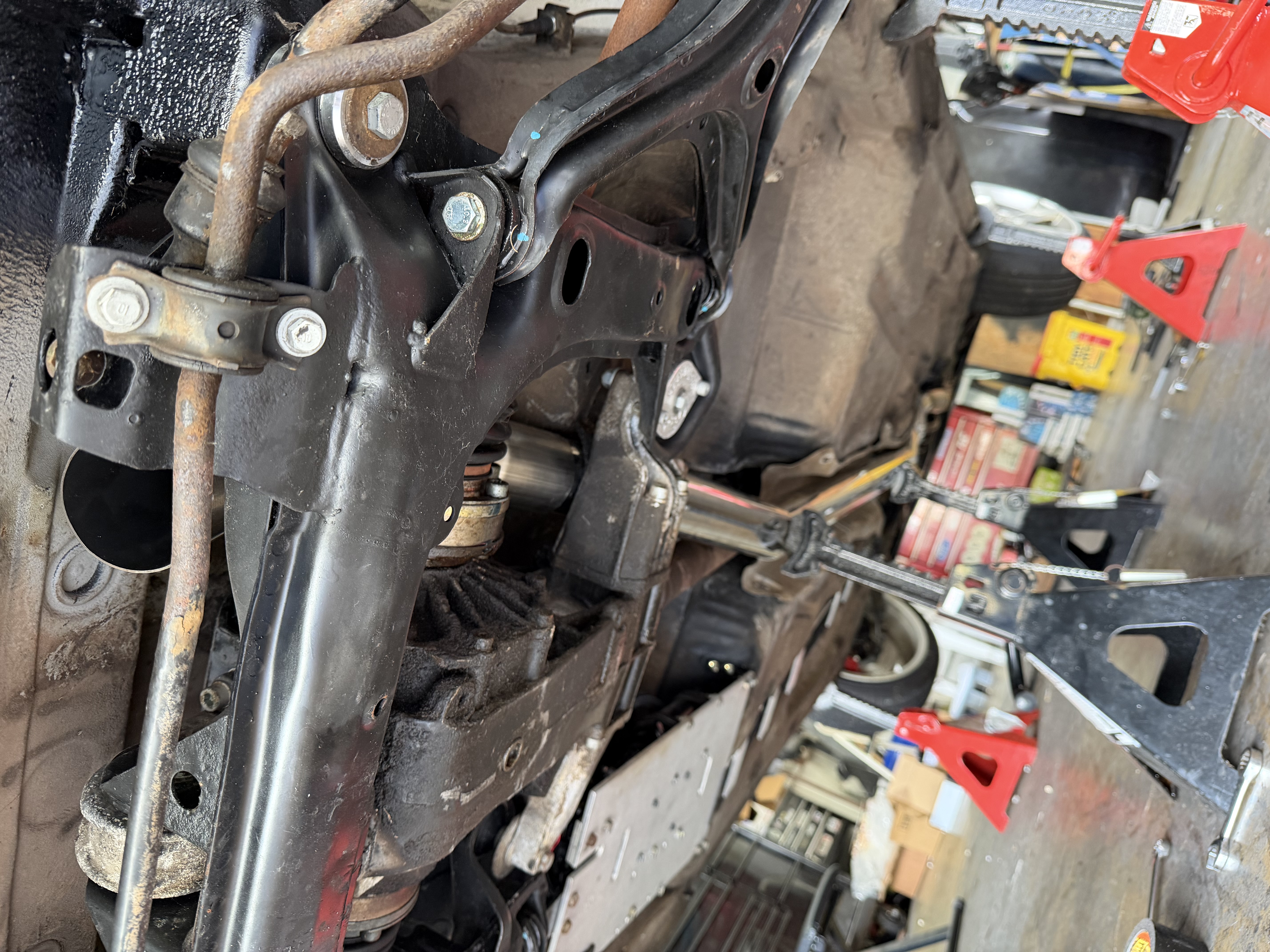

I’ve got 3/4” clearance from the drive axle boot. Heat wrap and a custom heat shield

Let’s see if 16ga 304ss amazon stuff holds up for the flex pipe back

Got the downpipes all welded up. Had to take a little off the subframe pinch weld. Doing the heat shields and secondary support bracket now
