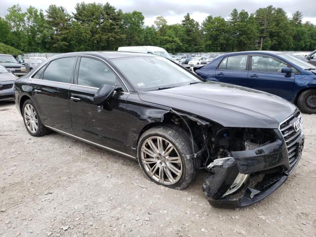

I tripped, fell, and decided a 4.0t was a better plan. Shorter better packaging and more efficient
- themagellan
- Posts: 873
Re: Marc's 1990 4.2L V8 Twin Turbo Coupe Quattro
What year 4.0t did you grab it from (does it matter all that much?) curious on the dimensions, that is going to be a wild package in a CQ!! Hope to see some build pics.
themagellan wrote:What year 4.0t did you grab it from (does it matter all that much?) curious on the dimensions, that is going to be a wild package in a CQ!! Hope to see some build pics.
2015 A8 from copart. wreck didn't even break the cooling system.
- donor 2015 a8
- 58122294_Image_4.jpg (67.11 KiB) Viewed 13497 times
