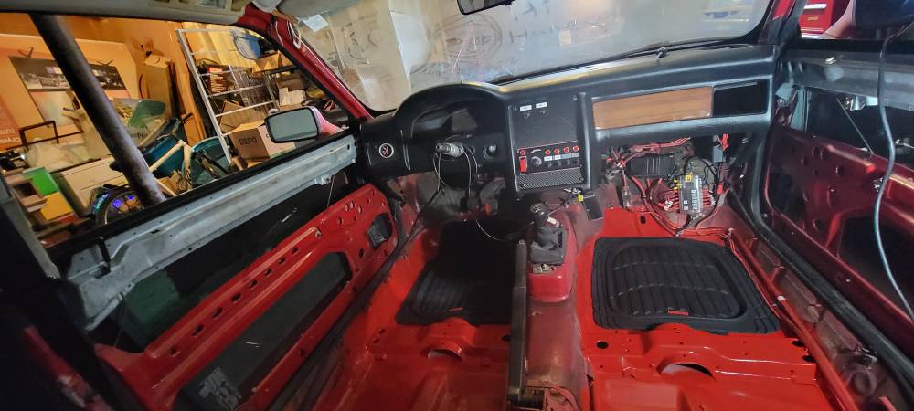

Here are some pics of my build because forum threads need love in the days of the Facebook takeover.
