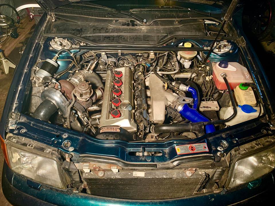

Long needed update on the car, its pretty much done. Oh and its Nogaro Blue now!
