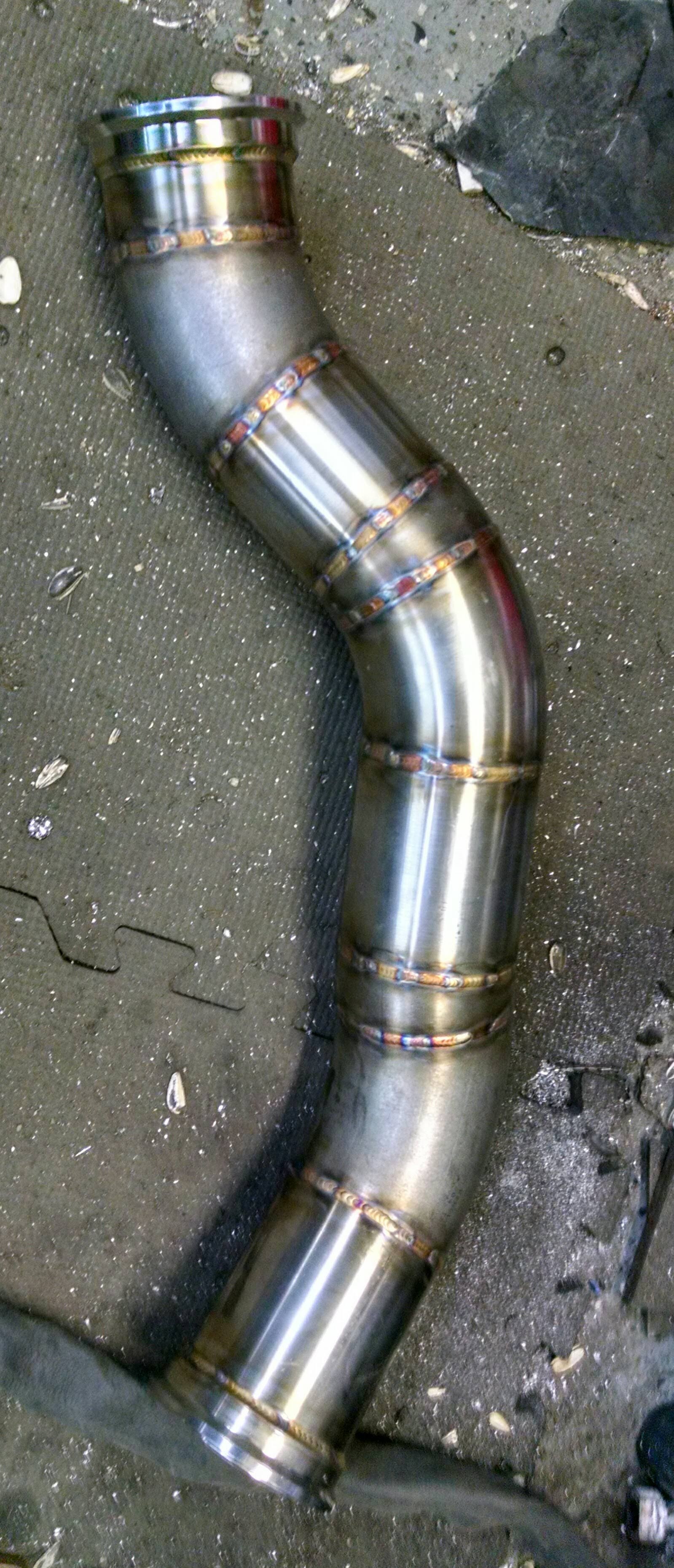

I got whistlebit on the exhaust, but I have a good portion of it done .
Downpipe
Middle section
Downpipe and mid pipe are finished, I just didn’t have time to get the back section wrapped up. I ordered some stainless bar stock to make hangers with , I don’t want to weld the back until I have the muffler hanging .
I was considering adding a V-band right in front of the muffler to make it removable and replace it with a straight through tailpipe section . It’d be like a 10 minute swap . This is what it will look like . Last few bend aren’t welded yet but I can get that done soon and then see what will fit for tips .
Now after doing this remember I was saying I thought about 3.5”. That would have been insanely hard to fit over the rear subframe .
Downpipe
Middle section

that looks top notch .DE80q wrote:That's what Tim did with my 3" exhaust. The over axel pipe is its own piece. Vbanded on either side.
Yeah I think I might do the V-band on both sides , because that piece without the muffler connected is at the point where it’s difficult (but still possible) to take it in and out by rotating it like 90 degrees . If I weld the muffler to it , there’s a chance I will have to lower the subframe to take it in and out .
Also I’m remembering that I had seen on Facebook or somewhere someone was making a new right side rear diff mount that allowed more room for the exhaust . I’ll have to see if I can find it . Might be the guy who makes 01E mounts
Re: The 90Q (07k?)
Schedule 10 IS thin wall pipe lol. Lots of welders hate that stuff. By doing two passes you're putting a lot of heat into it. Guys I work with (boilermaker and piping welders) would do it in one pass. Easier to get penetration if you're leaving a gap, typically about the size of your filler rod. What we do is bend a rod into a V and put it in between the ends, then tack three times, removing the rod a bit after each tack.
My brother was in on researching VGT Holsets on his mk4 years ago, but there just doesn't seem to be a reliable method of control. With advancements in ECU and other technology it'll be interesting to see it eventually get figured out and implemented. I think the Euro Polos use VGT and twincharging on their super low displacement engines to get respectable power output and still retain good fuel economy. One day...
Exhaust looks great! Definitely agree, v-band both sides of the axle spool. A bit of prep now saves massive hassles later.
