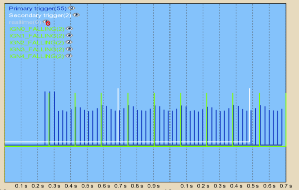

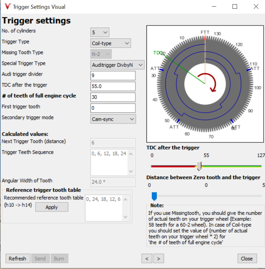

I have a triggerlog and a config file that i sent to Marc. But im sure it will be a while before he responds.
FIrst time triggerlogging and i can only do it while cranking so its short.
Also when i try to log it says not enough data most of the time.
When i "test" both spark and injector on the visuals page both injector 1 and coil 1 (numbers on the left column) correspond to cylinder 1 and so on.
On the triggerlog there are 15 primary ticks between every secondary tick which is good i believe.

You should not have to monkey with any of those numbers. I had to buy a usb scope and log the sensors to line up the hall sensor with the pin sensor. They have to overlap perfectly. Explained in this thread.
http://www.vemssupport.com/forum/index.php?topic=1761.0
Once you know that looks good via the scope, then you can look at firing order, etc which is another pain in the ass. I put stickers on my crank pulley to mark TDC for each cyl and used a timing light on each coil to verify everything was firing correctly.

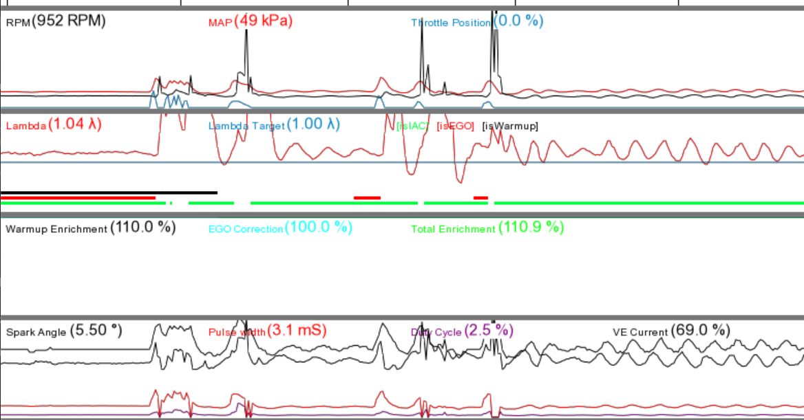

More issues!
Car idles fine. As soon as there is any throttle input it stumbles and thinks its at 8k rpm. The actual rpm wont increase at all since it starts missing right away. The strange part is its immediate as soon as the TPS clicks without even physically changing position it will do it.
Anybody have any ideas?
There are a few less ptrig and less strig when this happens too.

Re: Anyone have Vems + 01e w/ 7a flywheel?
This is so strange seems to happen only when the iac is off.
Its not like im revving it and getting a trigger error because the engine speed is too fast for the sensors to keep up. There is no physical change in rpm contrary to what the log says.
It has to be when the switch in the tps is deactivated there is some electrical noise causing the sensors to freak out. Injector pulse width and duty cycle drop to 0 when the rpm peaks as well.

How does it behave with the TPS unplugged?
quattrobros
- Posts: 115
- Joined: Mon Jul 20, 2015 9:50 pm
Didnt get a chance. Does the tps do anything other than acceleration enrichment? If i open it slowly it should behave normal provided everything else is ok correct?
Also i figure the injectors and spark turning off is just due to the overrun safety rather than anything effecting it directly.
Ill report back soon.
- Posts: 2144
Correct, it's just accell enrichment by default.

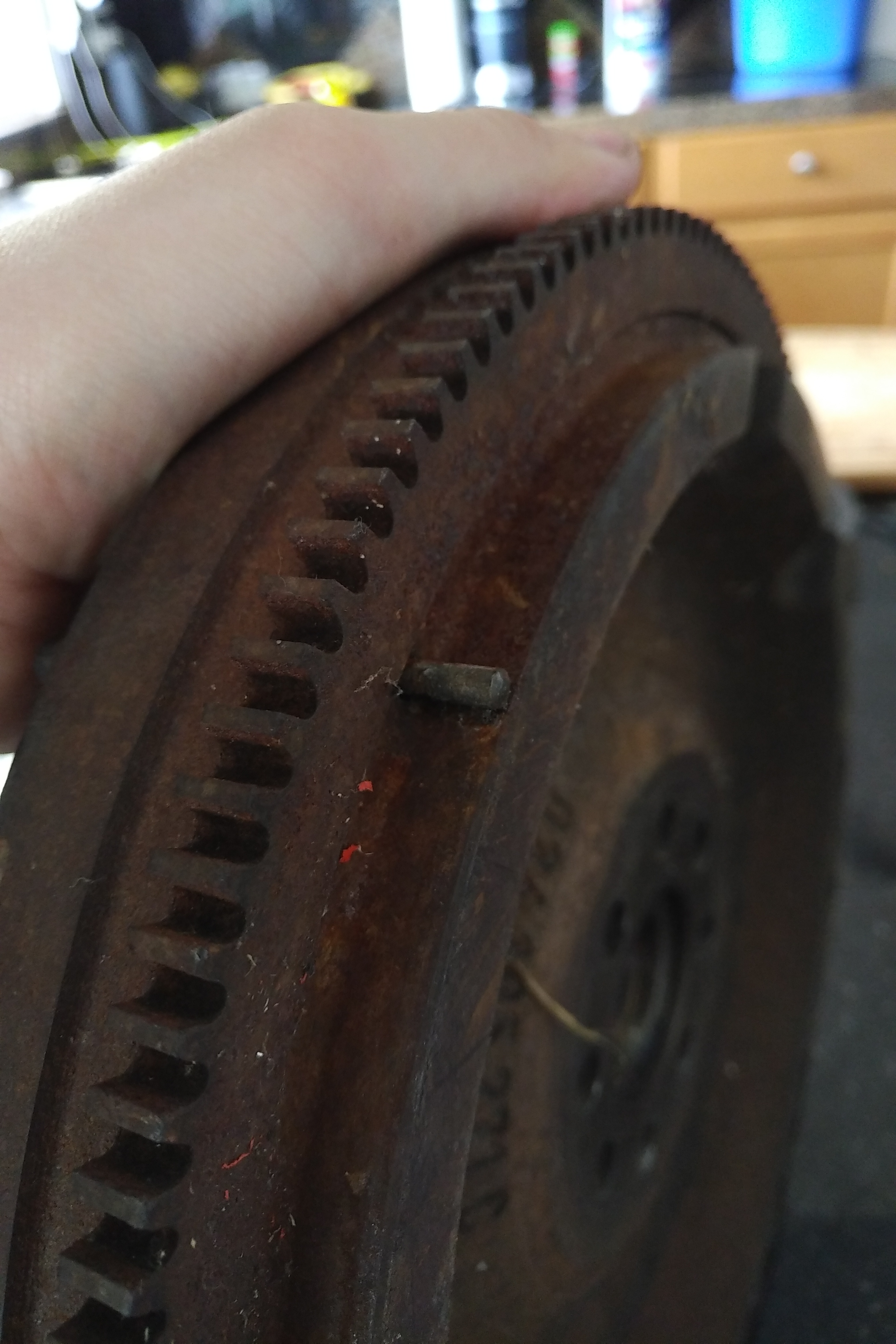

This is a picture from a while ago but its the current flywheel in the car cleaned up of course.

Yep, the wider area of the pin allows the sensor to see it easier. The one I did was for an aftermarket aluminum flywheel, but same general idea.

looks a bit tricky since its up against that lip on the flywheel. I was thinking using square channel and covering the pin and adding a few tacks.
Anyone know if its fairly weldable? I removed some clutch alignment pins by welding some metal to it and pulling it off. It caused some of the pins to become brittle and crack. Is the whole flywheel like that. Iron im guessing?
The flywheel is cast iron yes. The pins used are normally hardened steel. It is weldable, but as you said, normally becomes brittle.

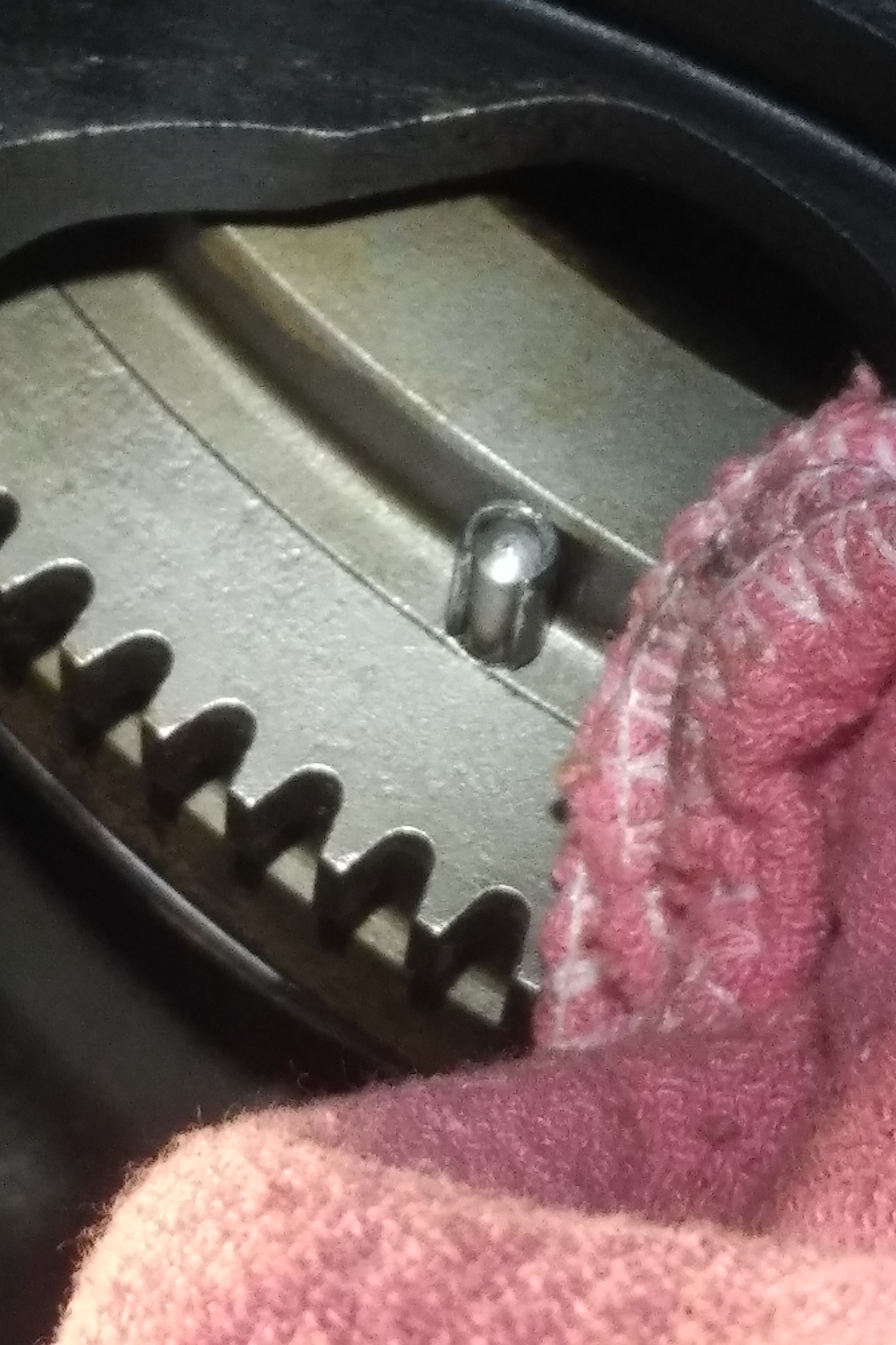

Ok so here is what i did. Found a tension pin and tried slipping it over. At first it did not work because it was too thick and would hit the sensor.
I then flipped the pin so the side with the slit s facing the sensor. Basically just adding material on either side of the pin and closing the gap between the pin and the wall.
Hammered it on with some sleeve retainer for now for testing.
Seems to be working fine now. Havent tested above 2500 rpm yet.
