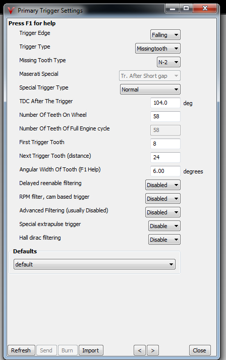

here is mine
tomorrow i will have time to explain it.

nmerrill wrote: My *guess* is that moving FTT actually just shifts when the ECU begins its count, but it still counts based on the trigger reference table- that is tooth 0, 24, 48, it just starts someplace other than 0...?
Any thoughts appreciated!
*edit * some information changed to prevent misinformation.
From my experience you pretty much have it. Since your using a 60-2 everything starts from the two missing teeth regardless if the 60-2 was installed with the engine at tdc1 or tdc 5. (If its a crank pulley 60-2 it can almost be in any position and a flywheel 60-2 is pretty much guaranteed to be in a set position.)
The reference chart is just that, a reference for where the other cylinders are located on the 60 tooth wheel. But remember 2 rotations for each firing event of cyl 1, so 120 teeth between each event.
Tdc 1 at tooth 8 as an example
Cyl 1 @ 8,
Cyl 2 @ 32
Cyl 4 @ 56
Cyl 5 @ 80
Cyl 3 @ 104 then back to 8 again
Each tooth is 6 degrees on the 360 degree rotation. So the 24 teeth between each cylinder is 144 degrees of crank rotation. Once you have tdc set anything else can be programmed in the ignition table for ign advance etc.
You want a tdc after trigger (ftt) to be between 60-80degrees
Example:
12 teeth and 78 degrees is the same as 11 teeth and 84 degrees however the 12 teeth setting is more favourable because it is in the 60-80 range.
Just my thoughts, and I've probably just repeated what you've already mentioned. If anyone sees anything I've mentioned is wrong please correct me.
Cheers

You were correct, I made a mistake. It's been a while since I messed with vems lol. I was looking at my vems program today. the ftt is where the count starts from. Your tdc from the ftt should be roughly between 60 and 80 degrees and you are at 78 so all should be good.
It would seem that a setting of 14 ftt and 66 tdc would have the same results.
I will edit the above so future searchers dont follow bad info.
