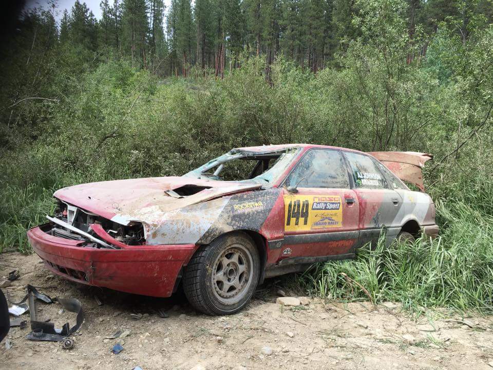

After taking 2 years off my rally car for various reasons, I'm digging back in. I rolled the car at rally Idaho after continuing to drive a car that should've retired. I added insult to broken car by not paying attention to the navvie and mentally starting the fix it list before finishing the stages yet to go before service. Then I rolled it...

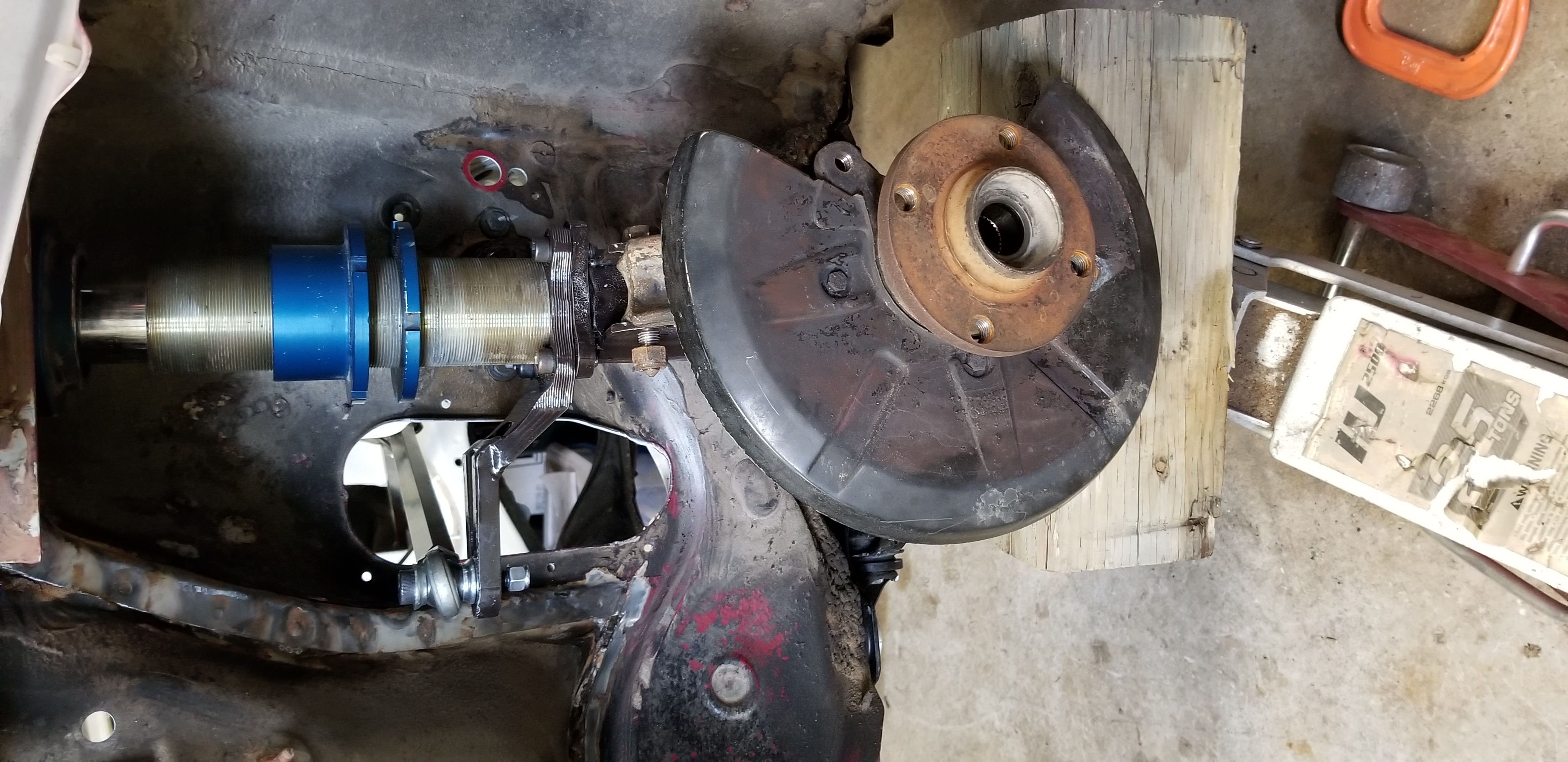

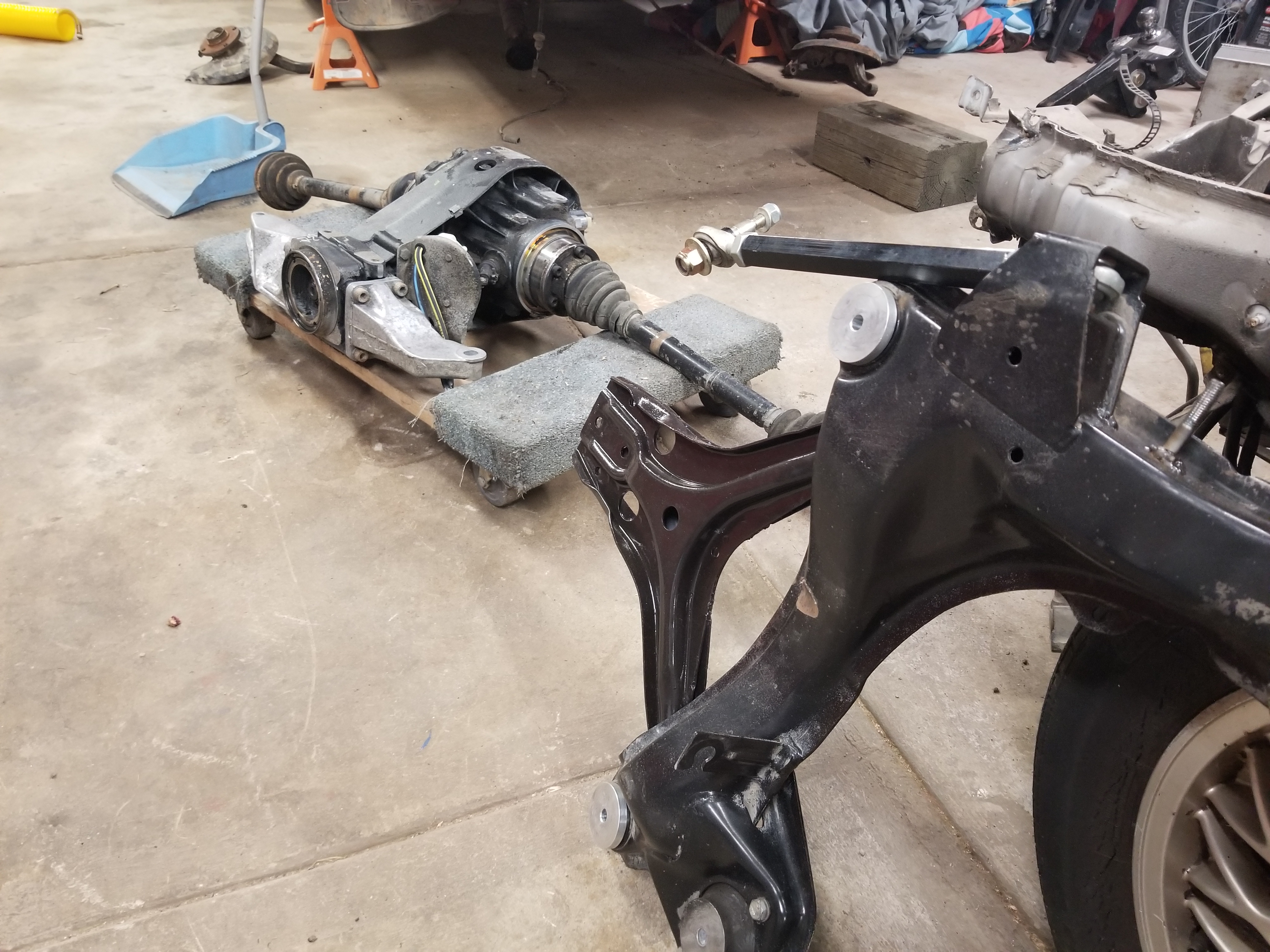

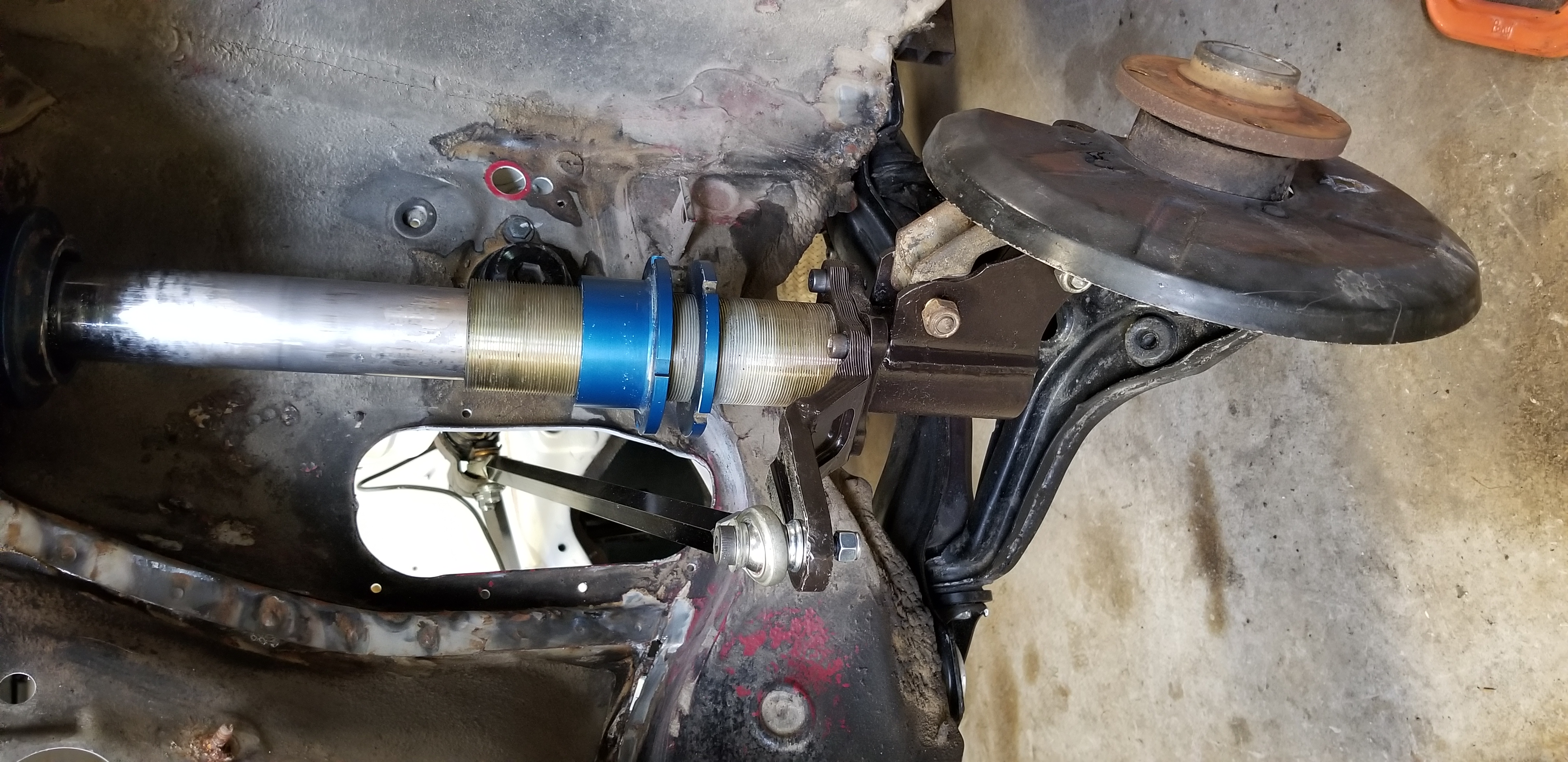

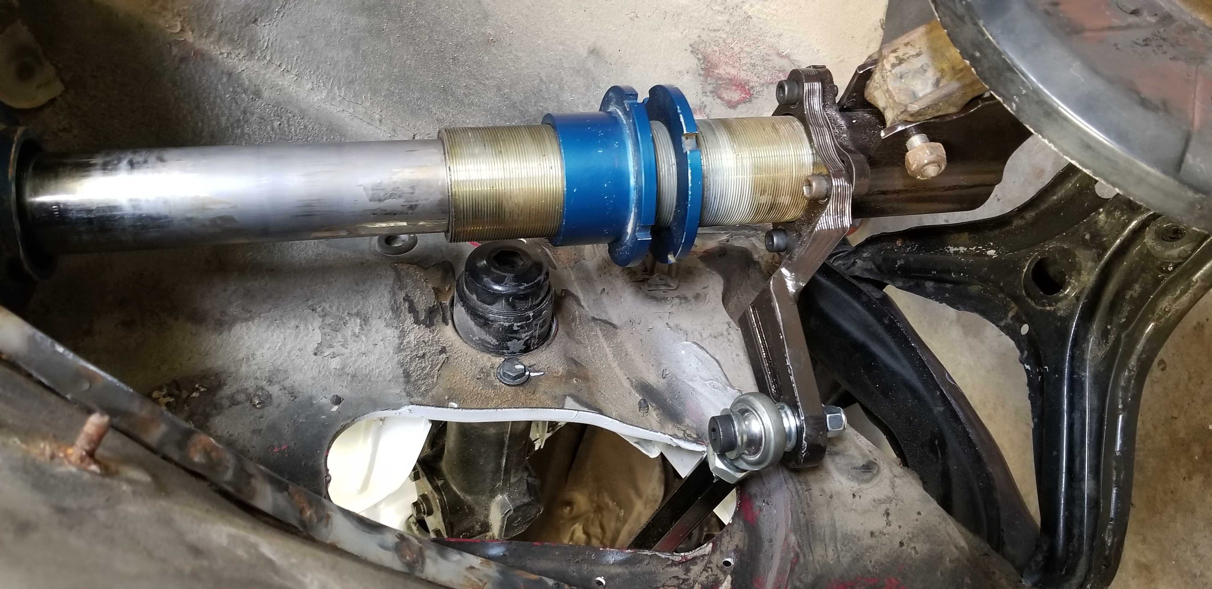

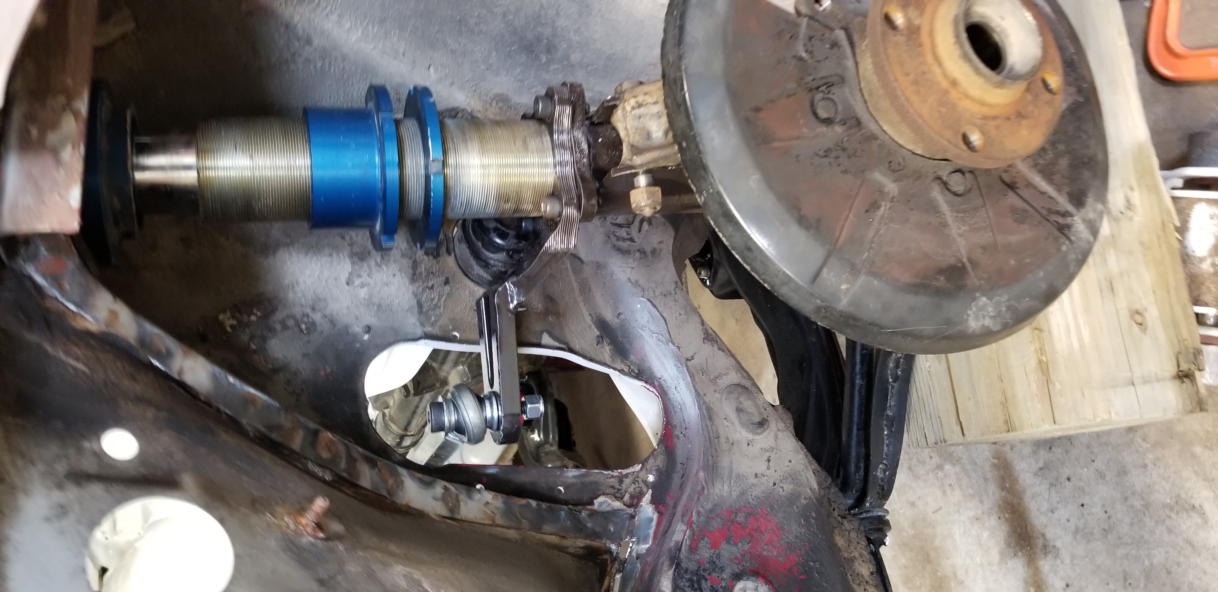

Couple pictures below show the suspension travel and tie rod clearances through the "window" for anyone interested. Their is ~8" of strut travel im playing with.

For suspension, are those Bilstein Motorsports universal 46mm struts or if not what are they? Looks like a beefy setup!
mr_aj_johnson
- Posts: 220
- Joined: Mon Apr 22, 2013 11:01 am
Re: AUDI 80 rebuild- Open light
Sorta. We whipped em up just before bilstein offered the universal kit. I yanked a couple sets of bilstein 5100 shocks from the back end of some fancy version of chevy blazer. They were the correct overall length and had 8.25" of travel. JVL cut the eyes off both ends, threaded the skinny rod, welded a pin to the fat end, had them chromed and then sent to bilstein to be rebuilt/revalved. Took almost 9 months from start to finish. Somehow in the process two of these were given to a subaru guy and I ended up with a hair shorter front struts that were done through a different process. The chroming process for the front struts was done at a different vendor than my original struts and has had issues with flaking. I'll run em till they're toast then swap to an off the shelf insert to replace the fronts.vt10vt wrote:Glad to see this back up and making progress!

that's an awesome looking suspension setup. Crazy how much height adjustment you have.
mr_aj_johnson
- Posts: 220
Yeah, I'm pretty excited to abuse the suspension again!

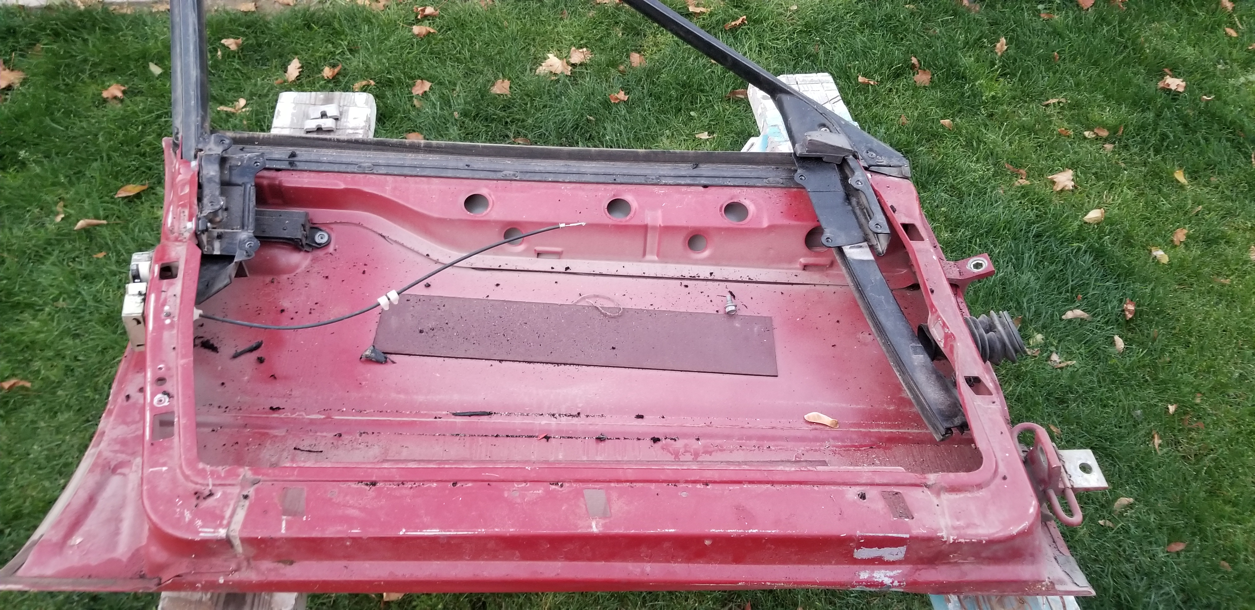

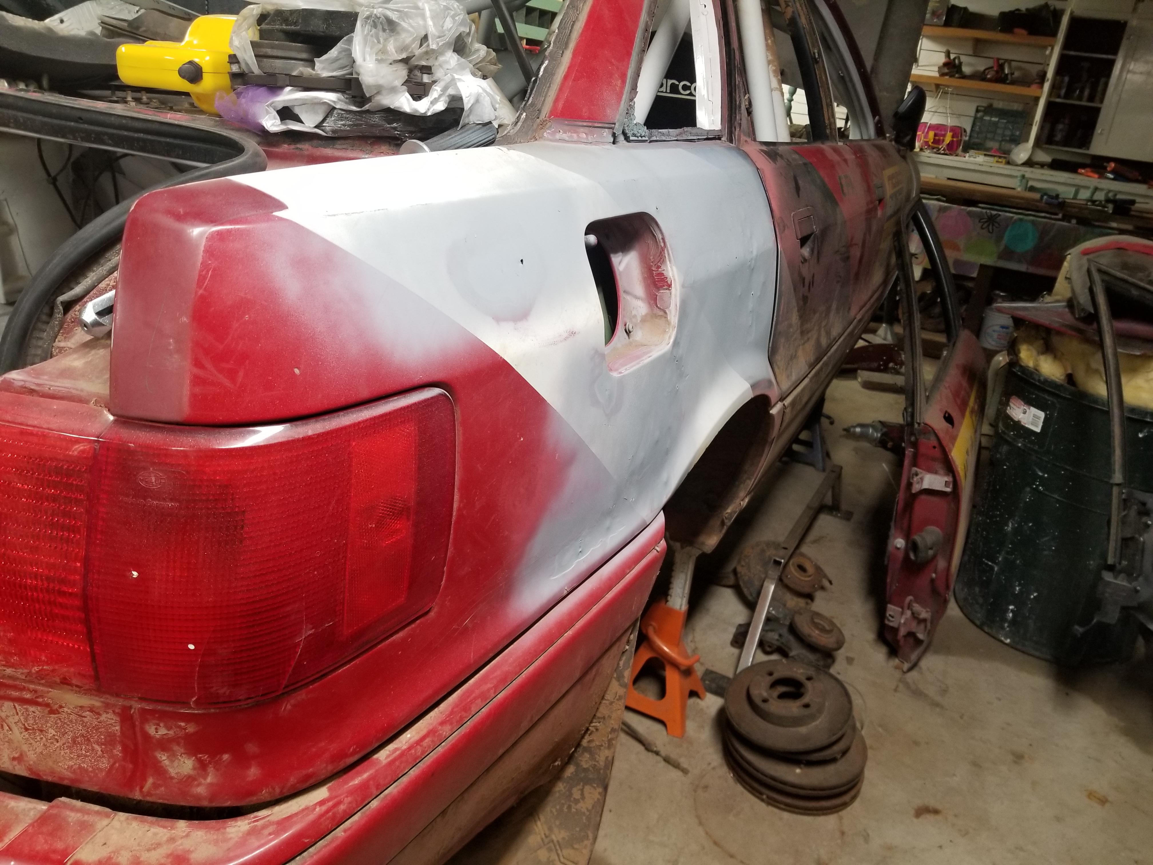

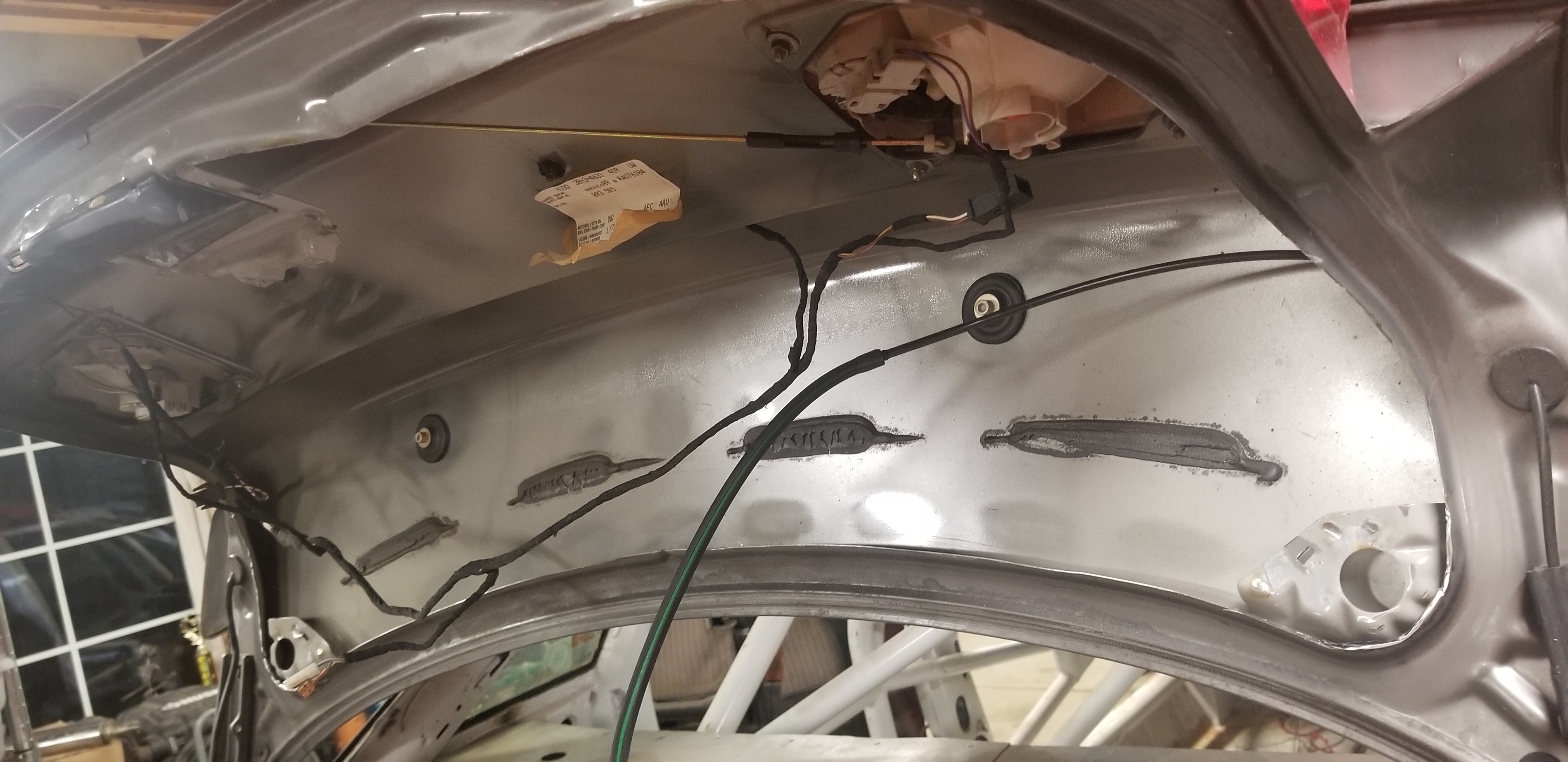

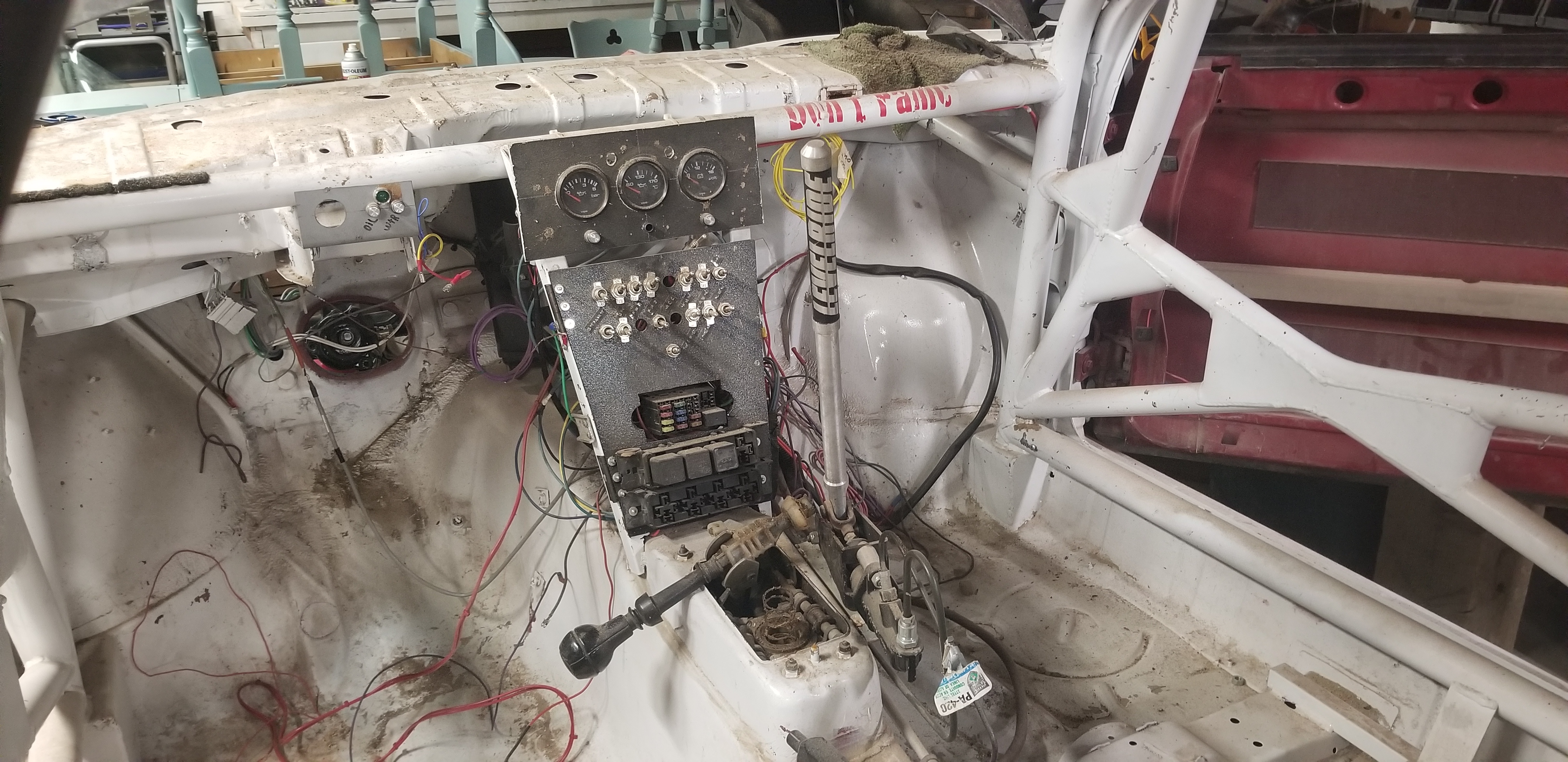

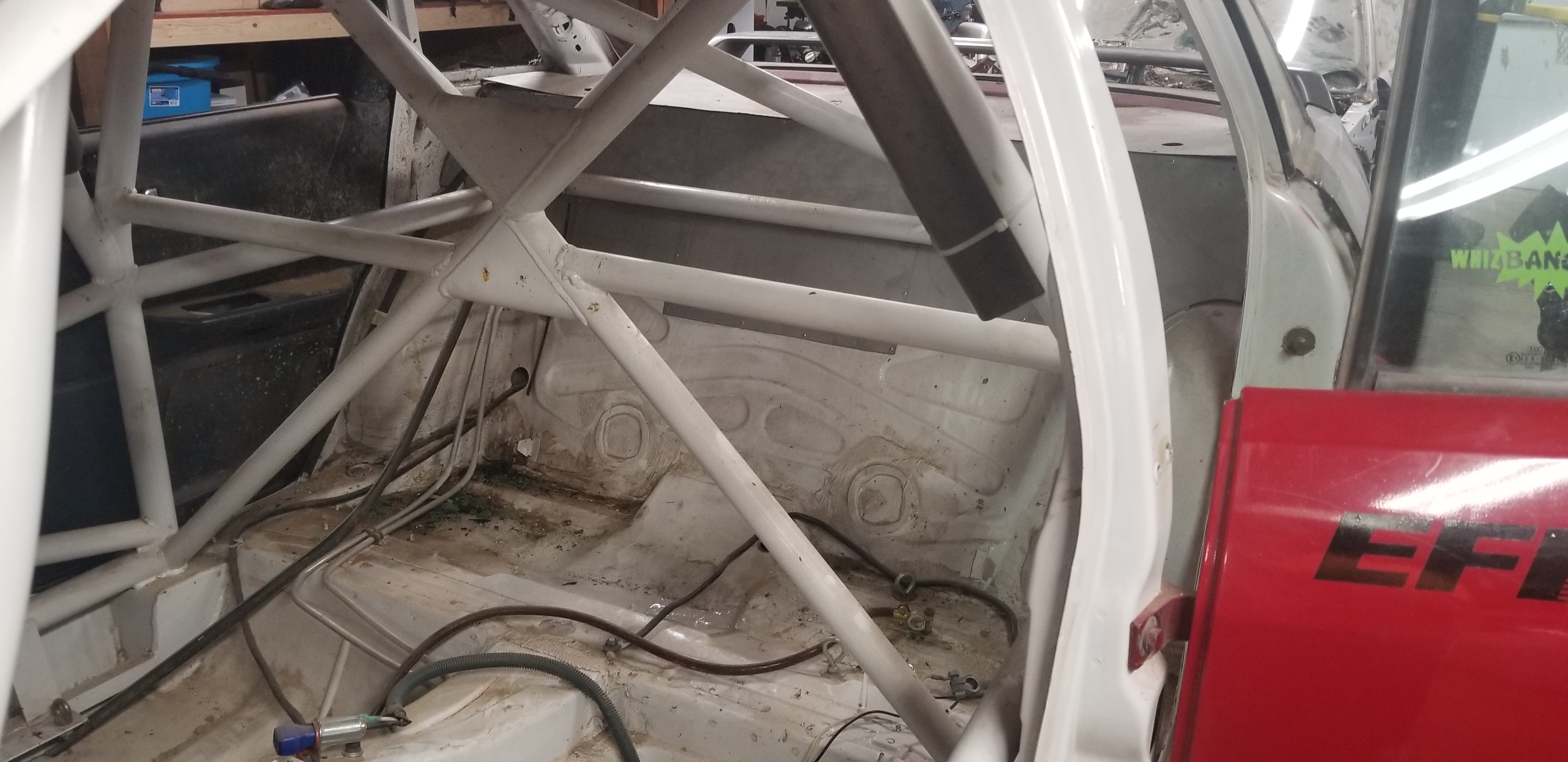

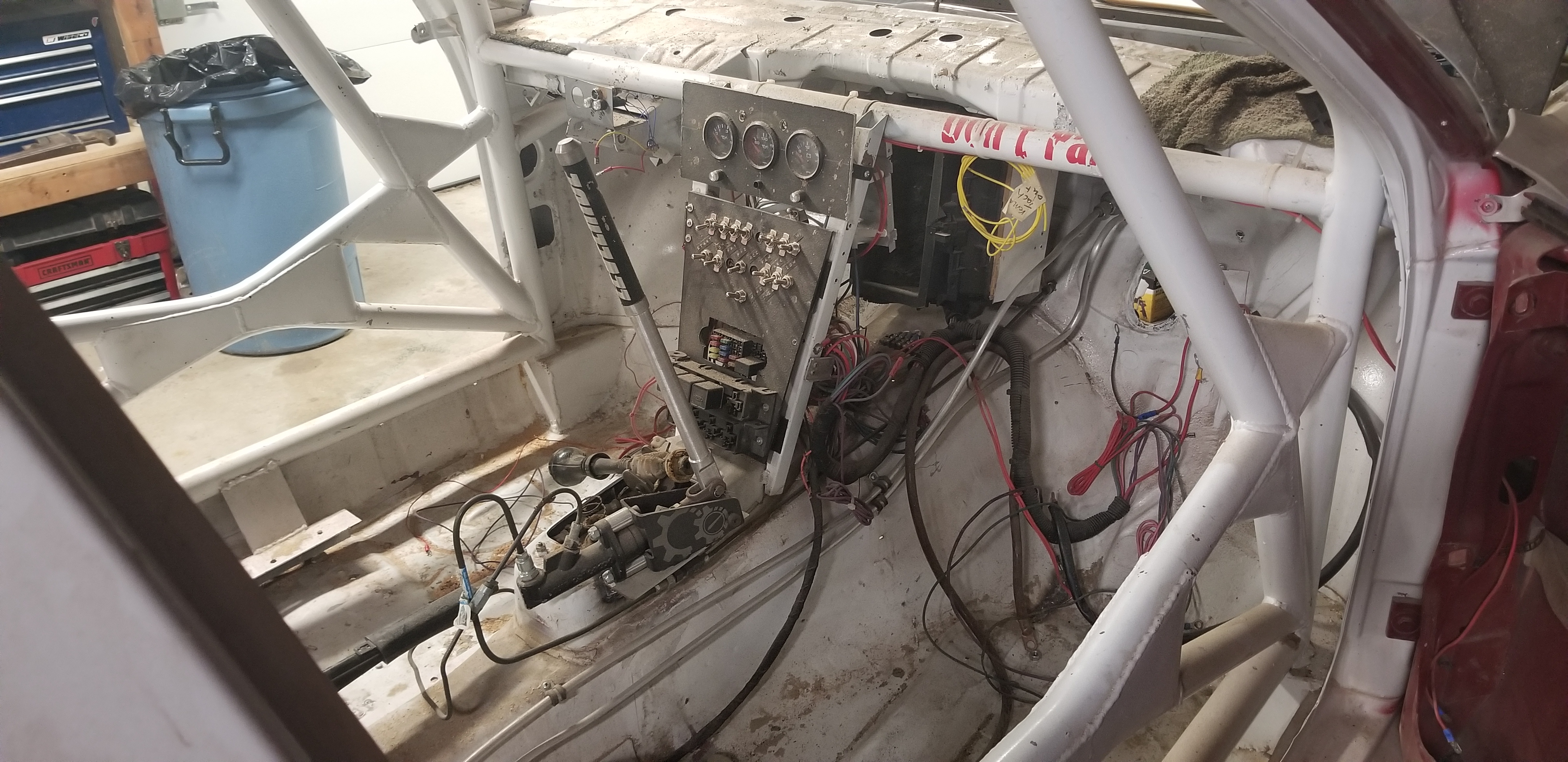

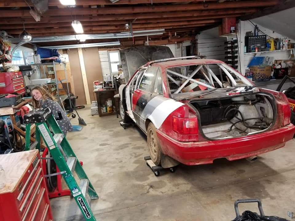

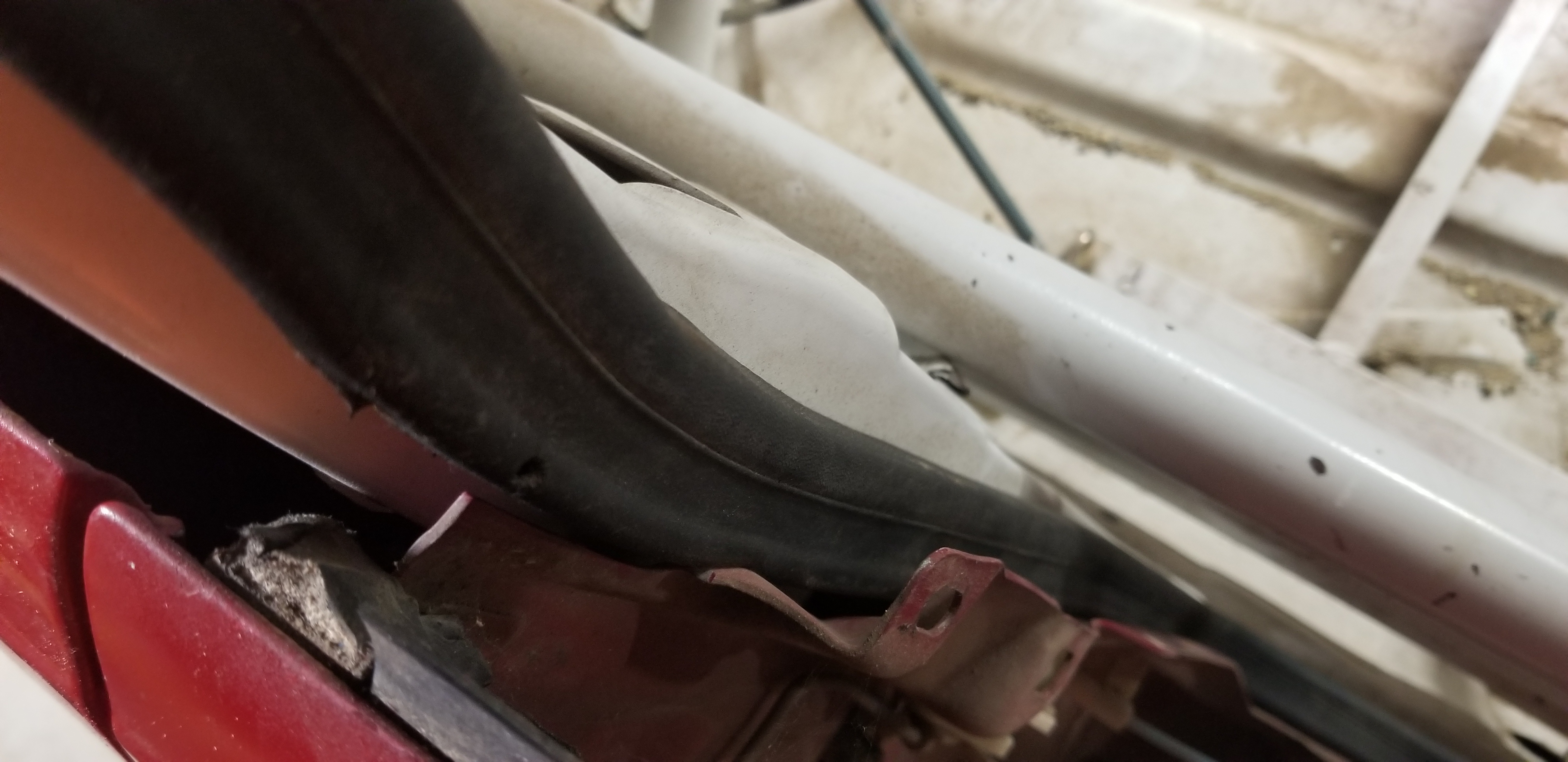

Took some "before" pics as i clean out the inside. Started carving some small amounts of weight out of little spots id always meant too. Getting ready to yank all the wiring as its all getting replaced.
Impressive how much the doors still weigh with nothing in them but every pound counts. Going to try to "roll on" the epoxy interior paint as soon as I can get it prepped. I've always been curious as to how well it would work. If it doesnt pan out I'll start on the temporary paint booth and spray the whole car

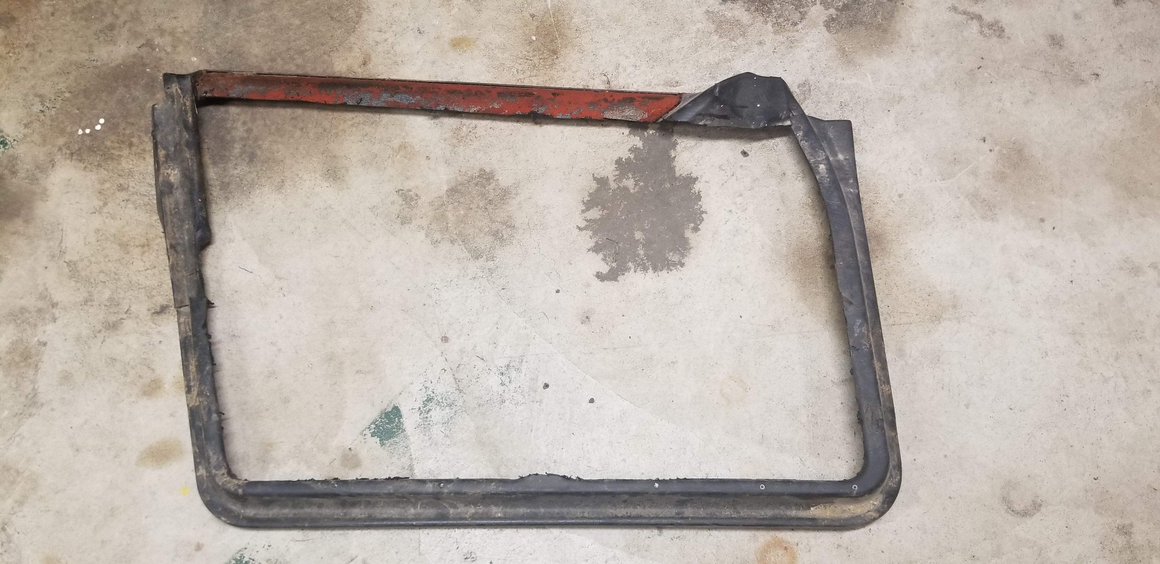

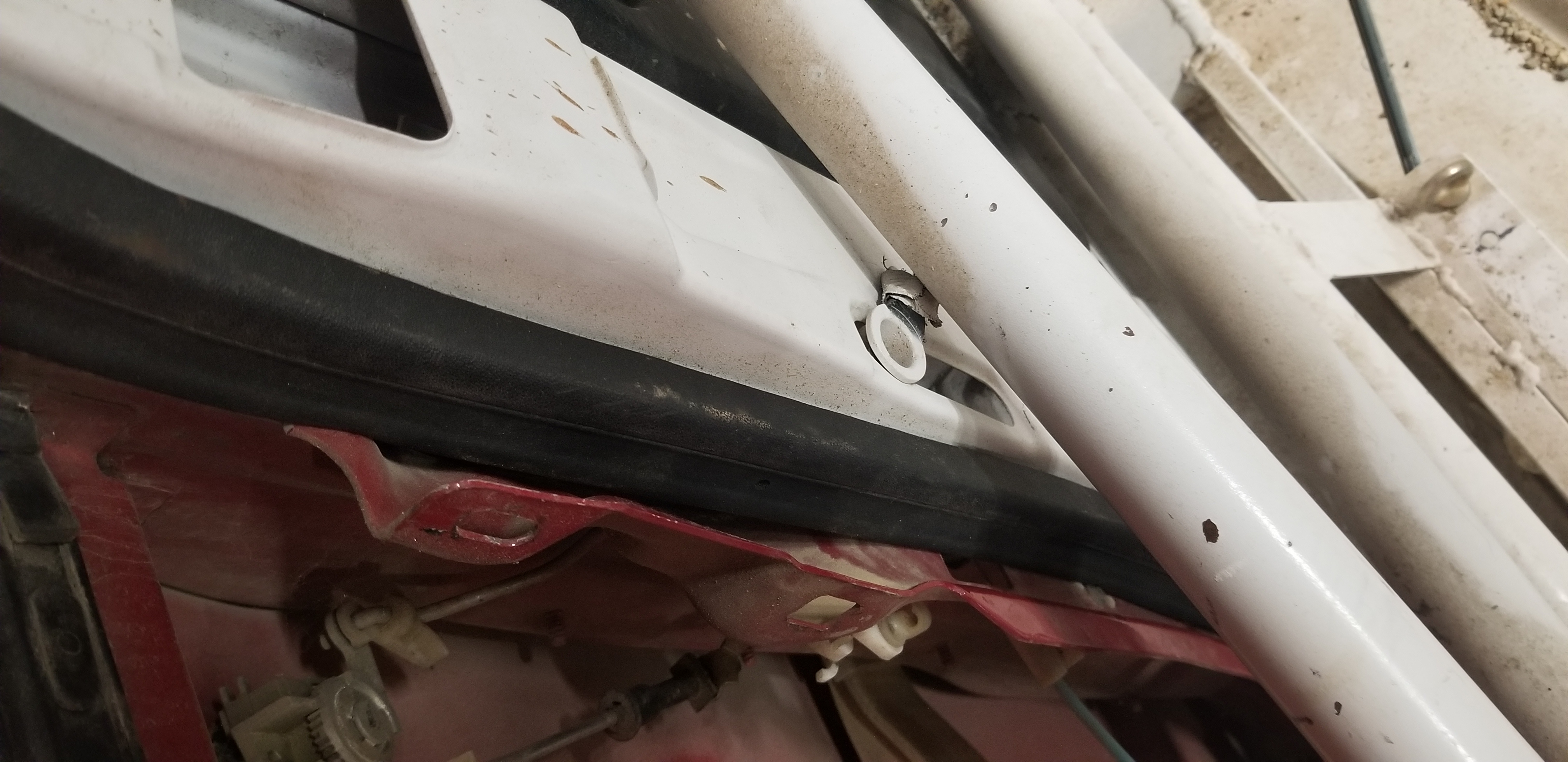

Also of note, the door seals mate to the door card rather than to steel. From the already destroyed sacrificial door card it looks like i can switch to som other material with some careful cutting of a good door card.

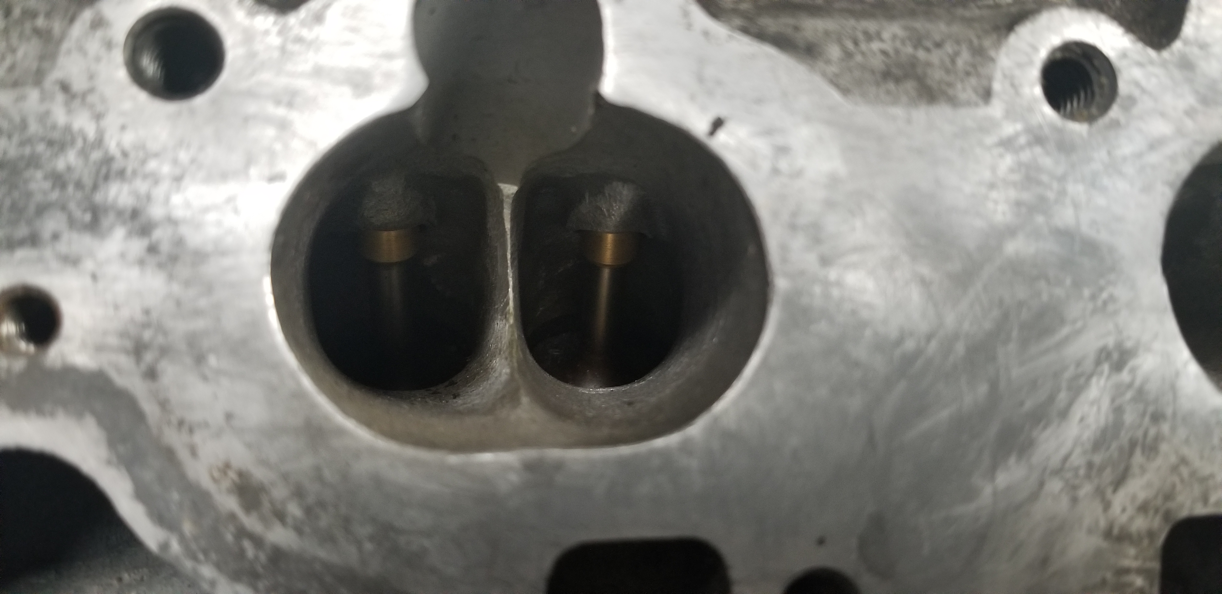

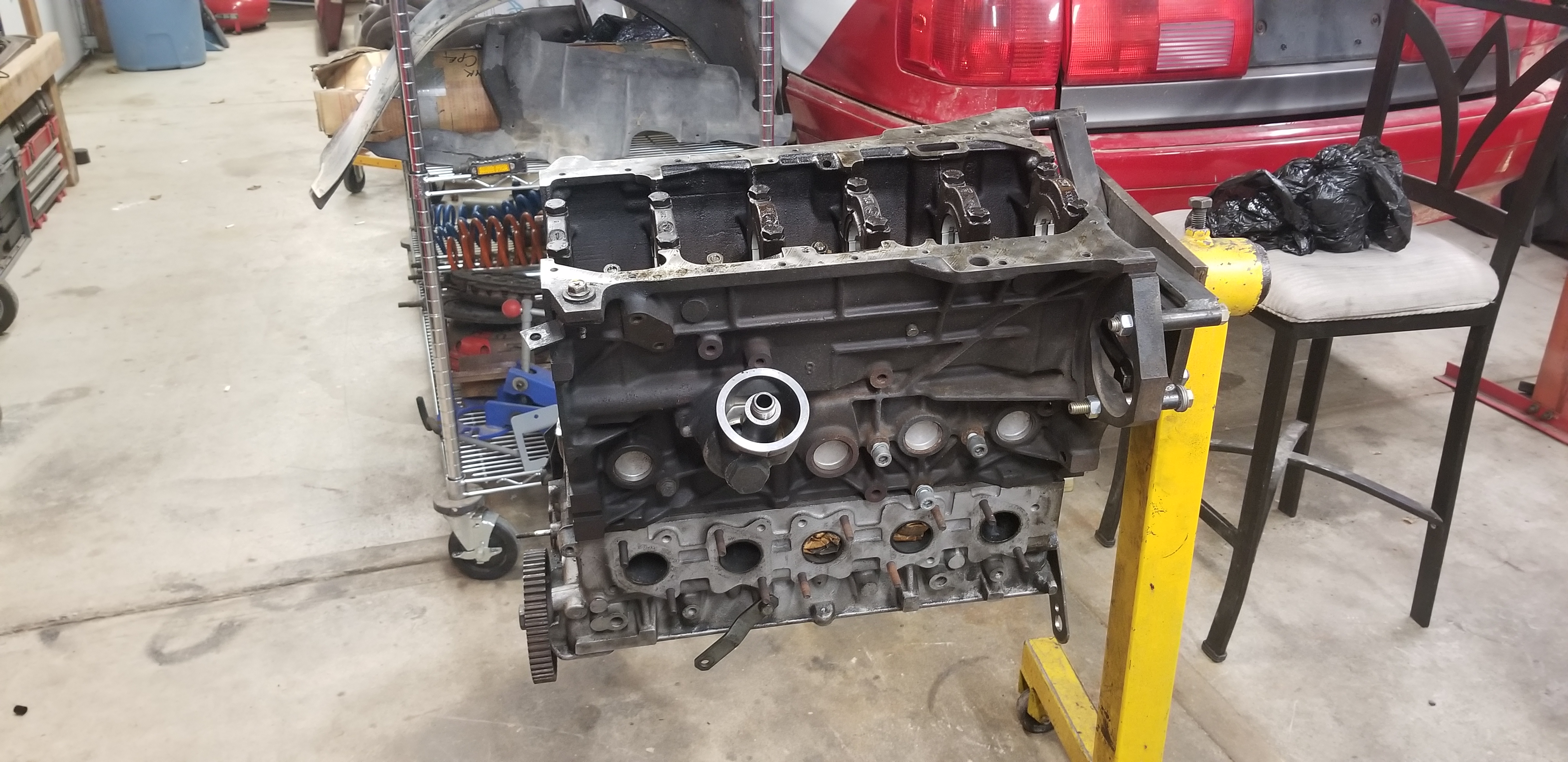

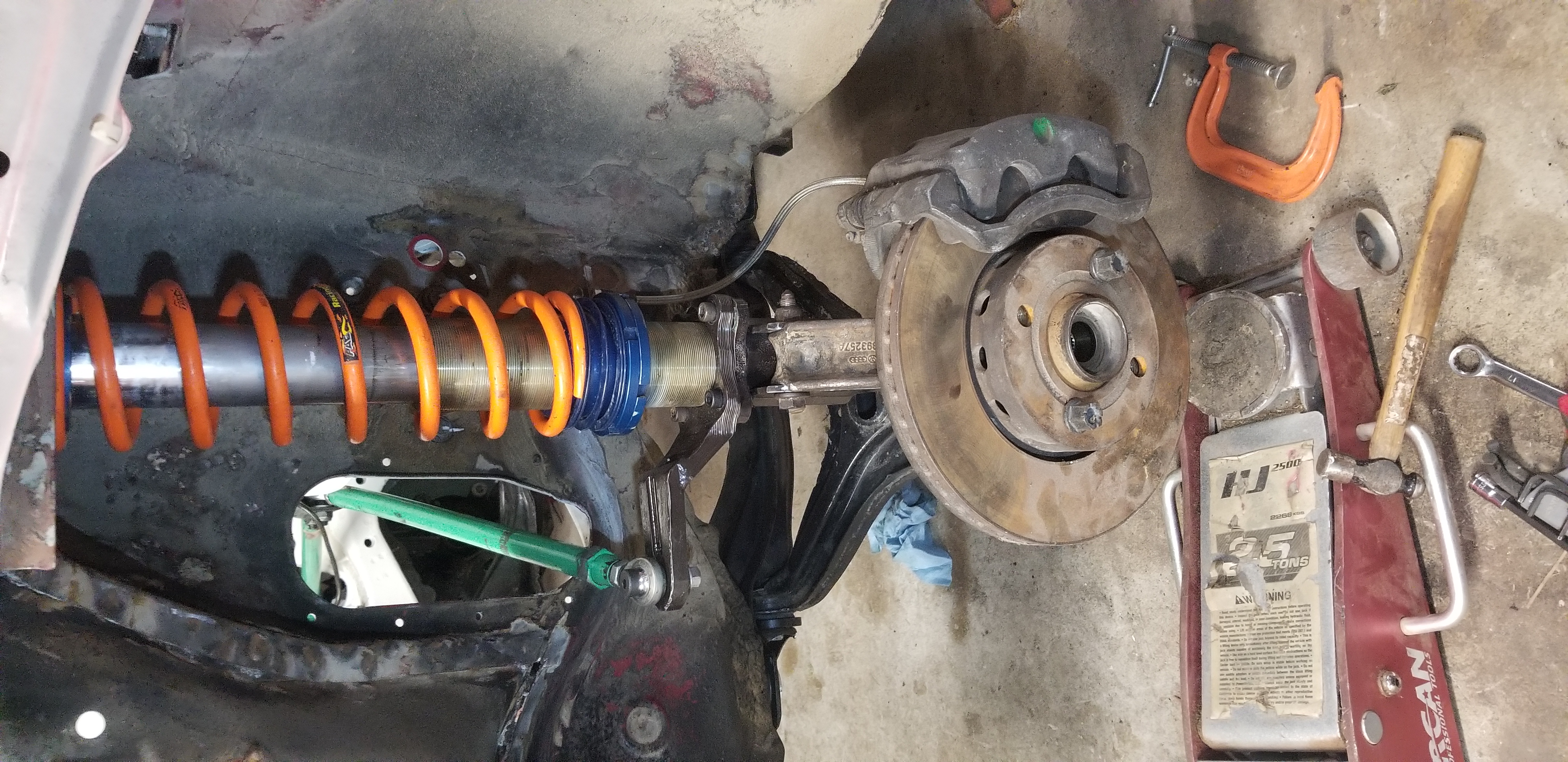

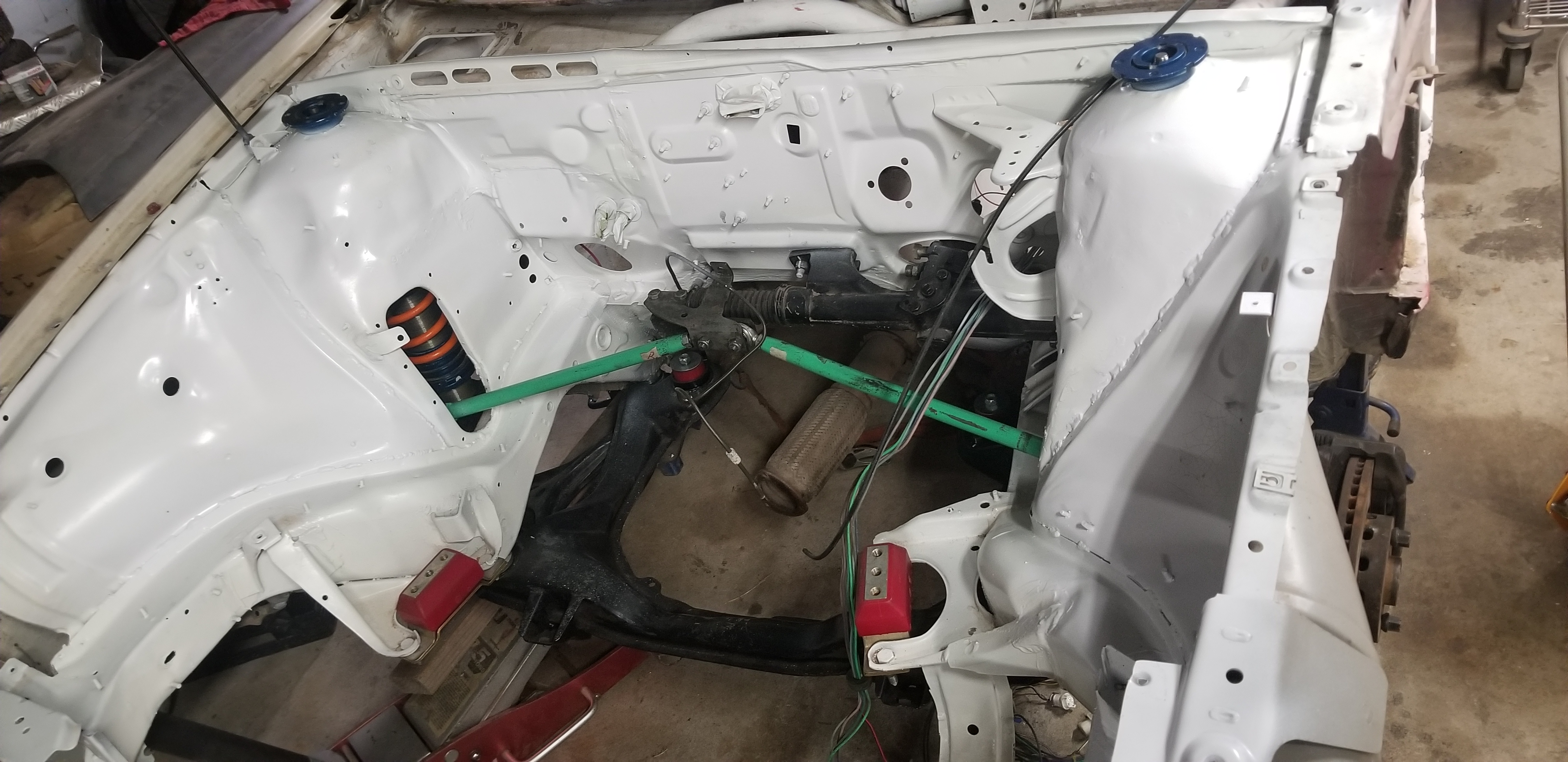

Engine bay painted, stockish 7a up for reseal, g60s installed, front suspension and fecking steering sorted on v3 setup. Continuing interior prep for paint as well.
