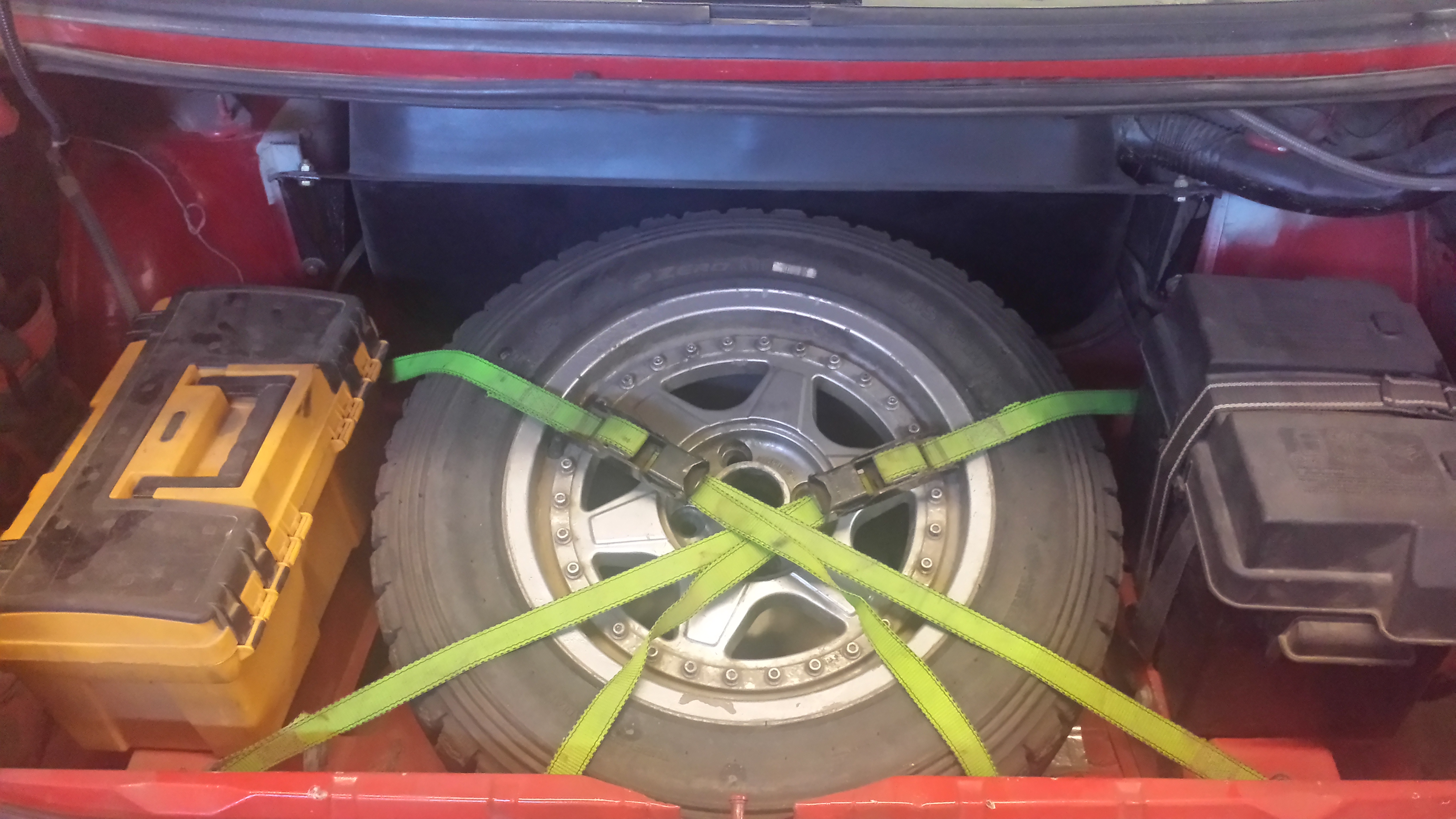

how are you fitting a spare tire in the trunk? The b3 is nearly a no go. I'm considering mounting on top of the trunk!
vbares
Posts: 36
Joined: Thu Apr 18, 2013 11:31 pm
Re: 4kRR Audi 4000 Rally Rig
Post by vbares »

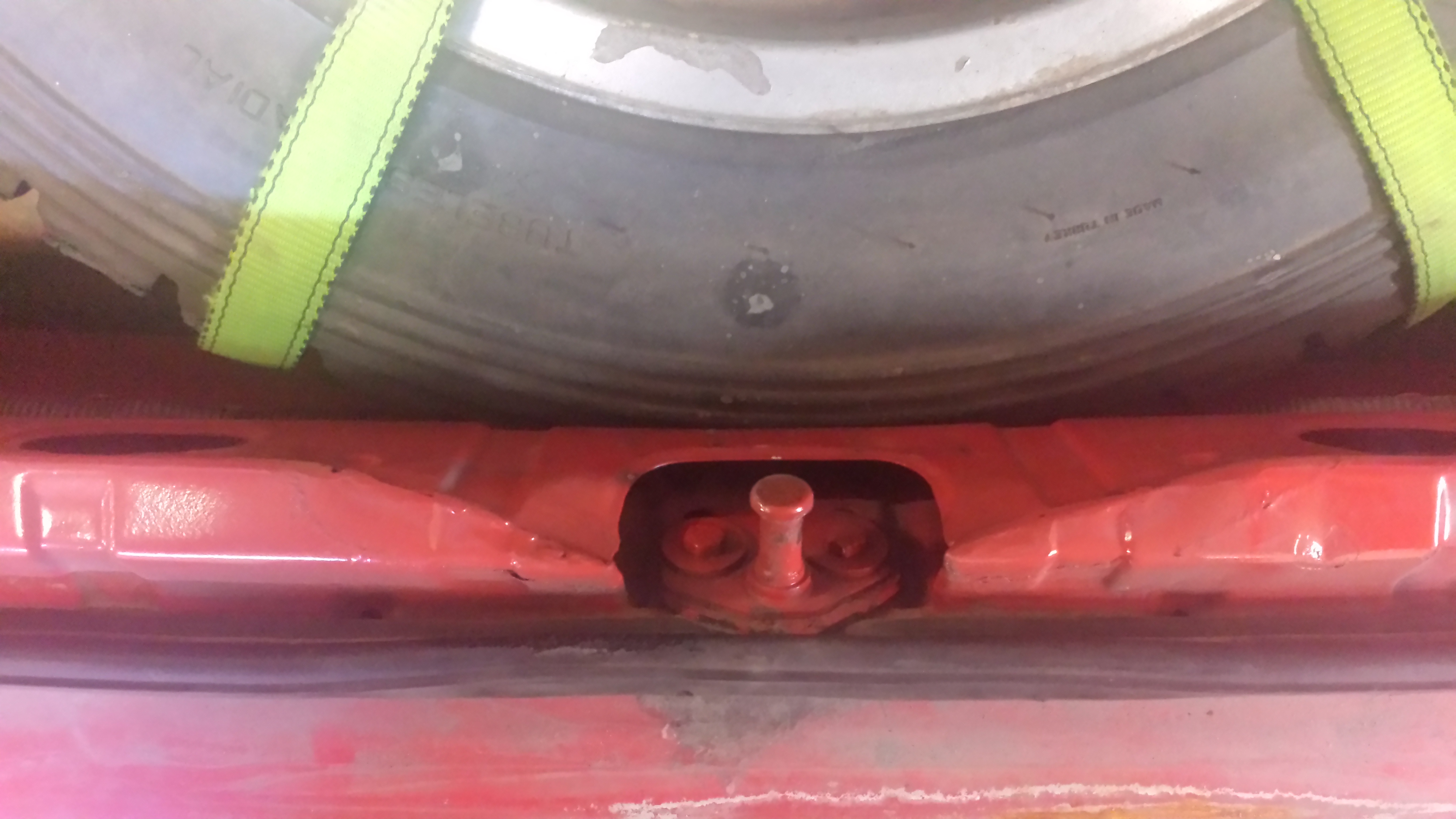

I'll take some pics tonight - its a tight squeeze and I cut some body material near the lock pin...

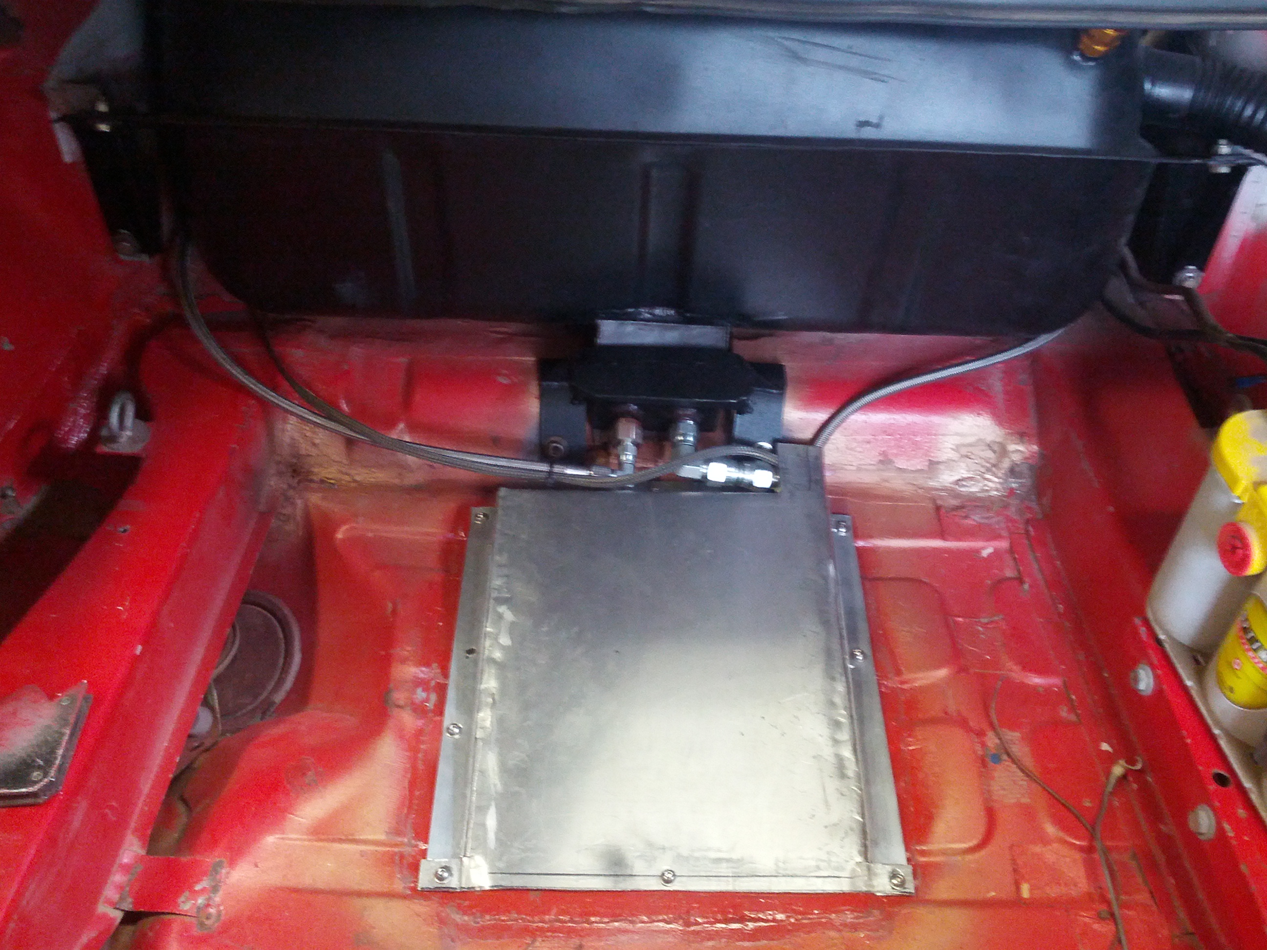

2015-10-08 12.10.42.jpg (1.54 MiB) Viewed 48732 times
2015-10-08 12.10.25.jpg (2.25 MiB) Viewed 48732 times

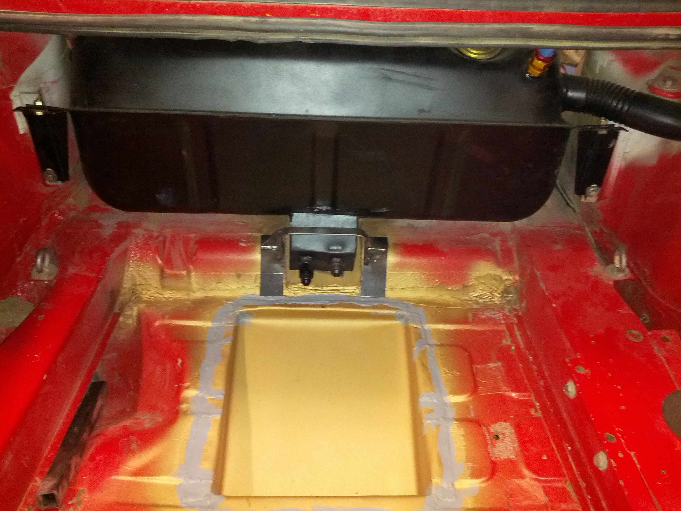

I just remembered that I moved the gas tank backwards by modifying the brackets (I'll look for those pics too) - plus you'll see that I cut the trunk a bit in a wide v-shape in order to facilitate in-out.
2 195/15 fit, but only 1 205/15 will fit

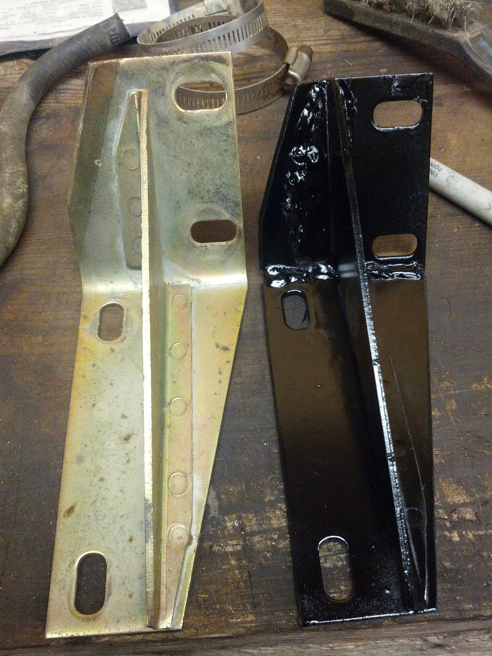

yep - here is a pic of how I changed the bracket - it moves the tank back a bit, but not so much that I had to change the bulkhead configuration. I don't know how this would work with stock fuel lines as I have a different implementation for the fuel pumps...
2013-01-21 17.29.36.jpg (2.19 MiB) Viewed 48730 times
2013-02-03 17.13.40.jpg (1.64 MiB) Viewed 48730 times
2013-03-02 10.55.24.jpg (1.66 MiB) Viewed 48730 times

Eventually I'm going to have to modify my fuel line like yours, For now I took the factory pickup out of the bottom of the tank, flipped it around a bit and welded it back in. It comes out very close to where your box does. I would like to note that it doesn't like fuel sloshing around when towards the last gallon or two. your little box might be ideal as a kind of surge tank.
I'll have to see what sort of persuading I can do to the latch area. My tire sits in a much more upright position when in the trunk. No chance in hell of getting 2 195's in there.
And of course I don't have any pictures of the fuel tank outlet. But it worked out pretty darn well.

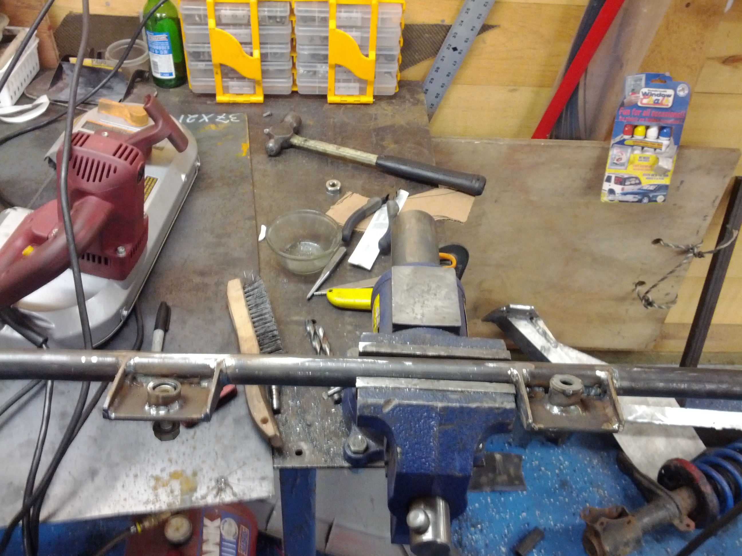

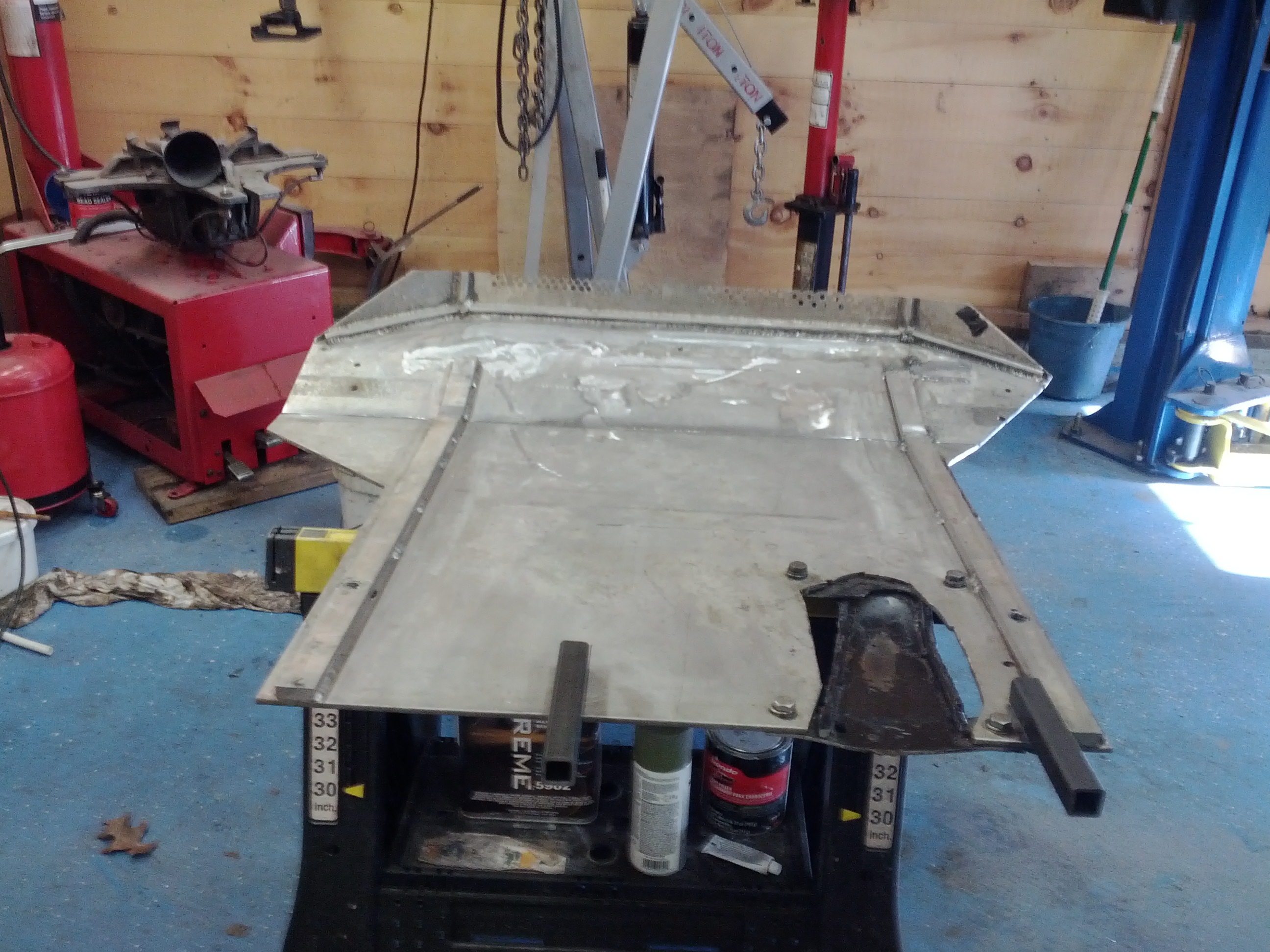

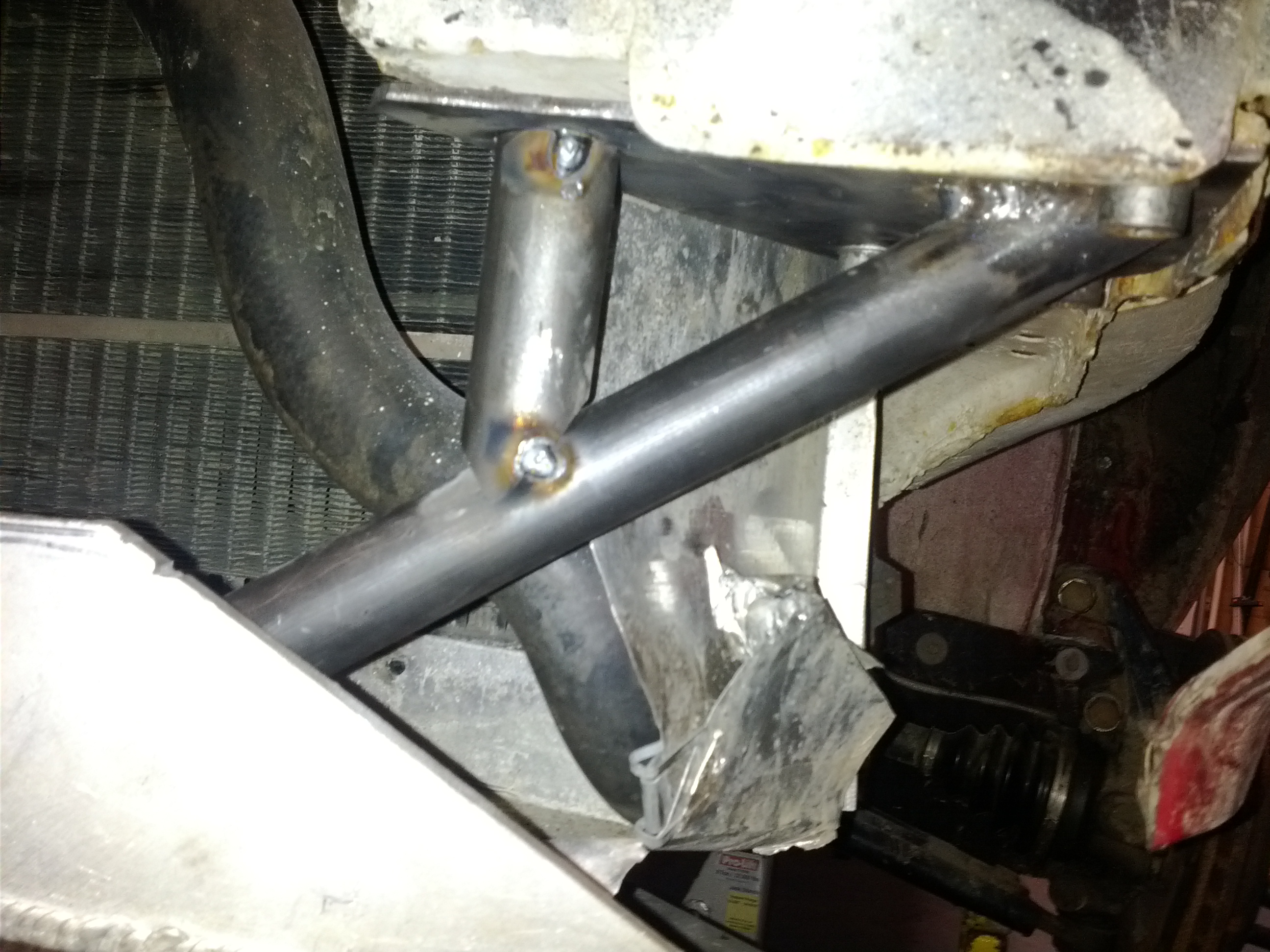

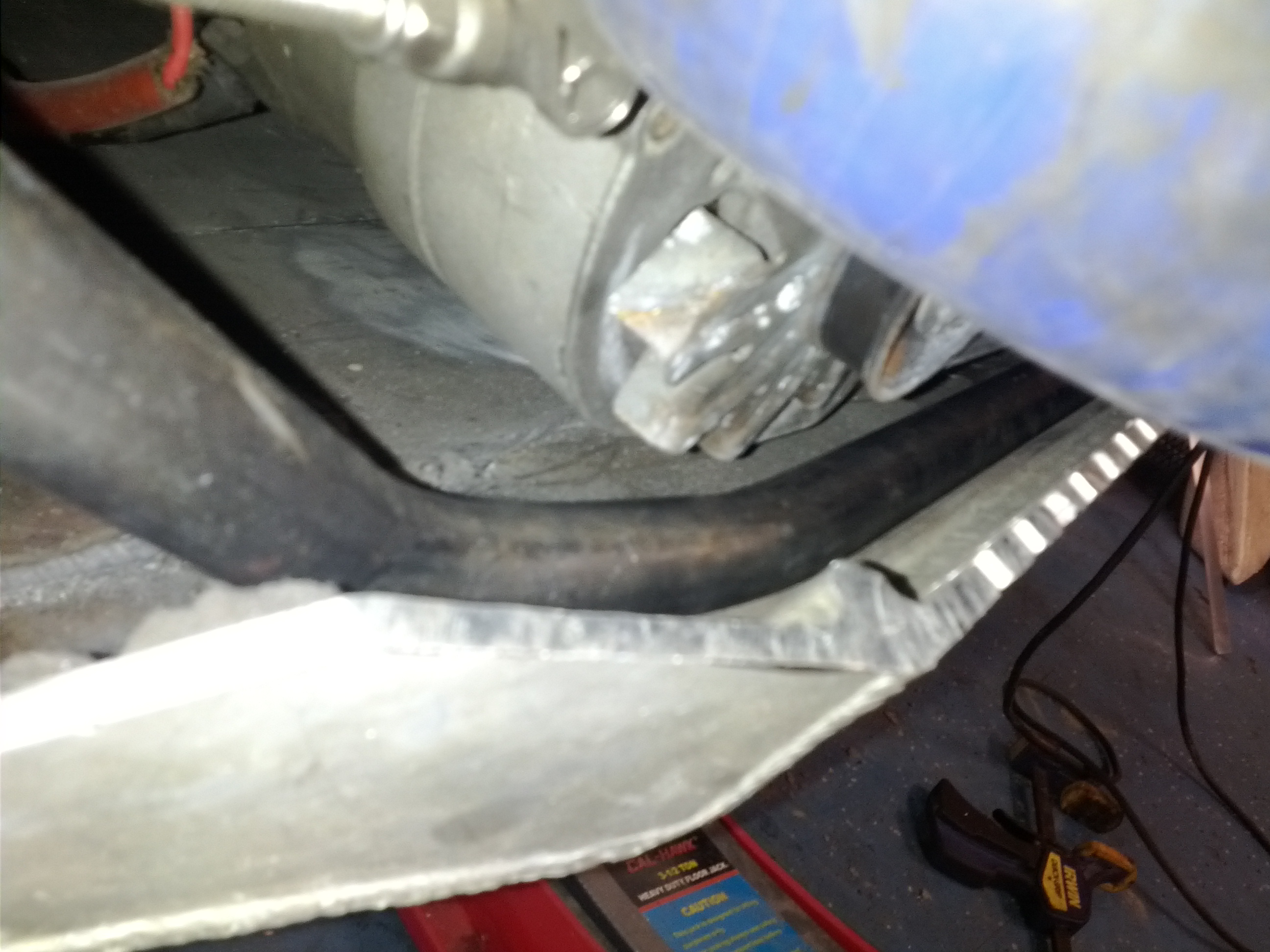

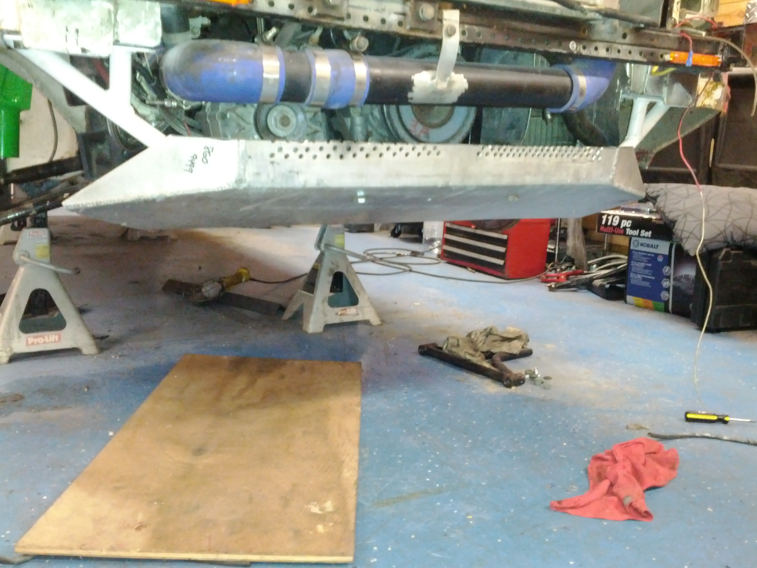

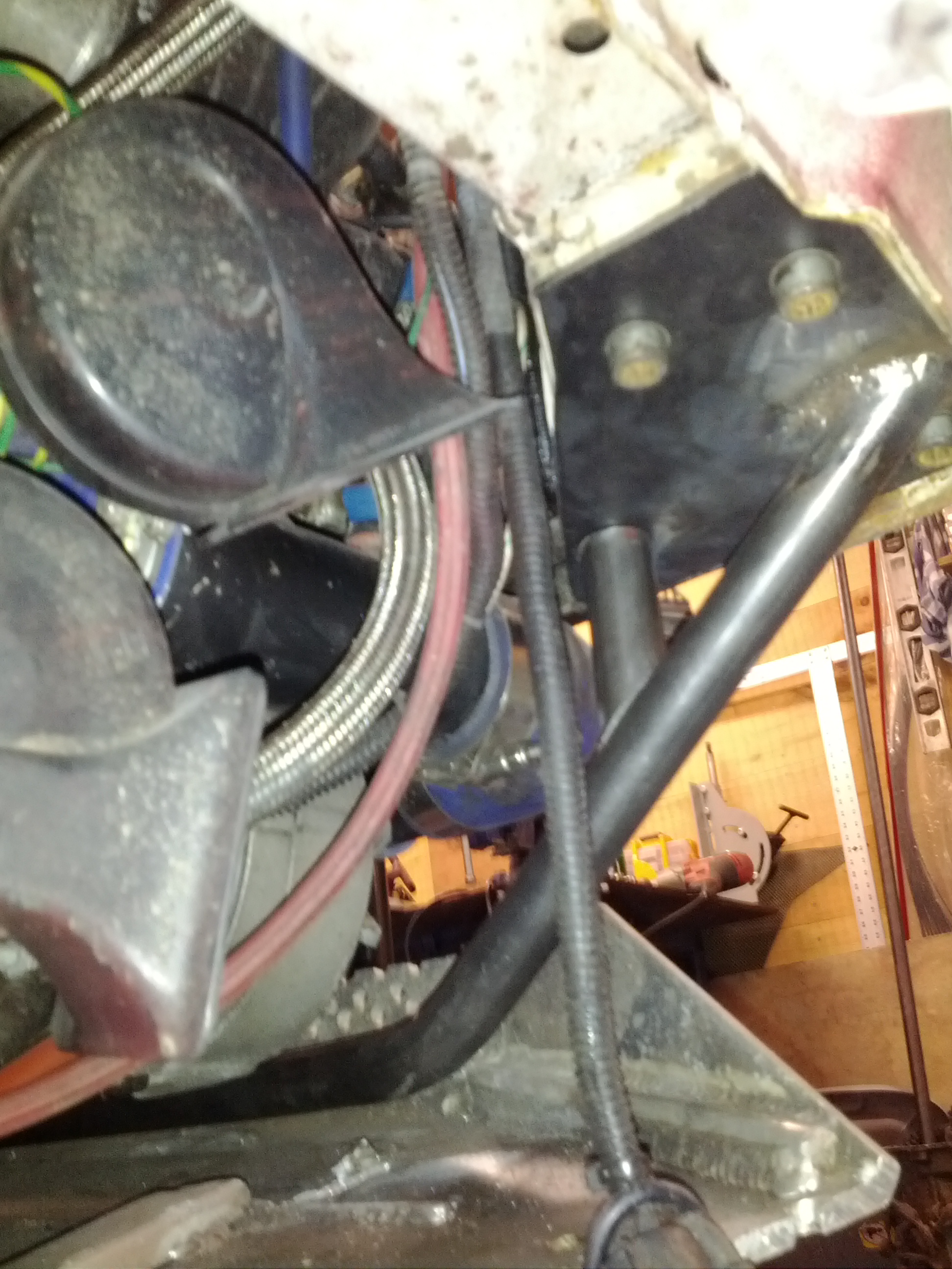

Posting pics of my skid plate setup as several folks have asked:
FIrst I built a support frame from 1" DOM.
2012-03-23 21.58.18.jpg (1.34 MiB) Viewed 48631 times
2012-03-23 22.51.12.jpg (1.3 MiB) Viewed 48631 times
2012-03-23 22.52.14.jpg (1.38 MiB) Viewed 48631 times

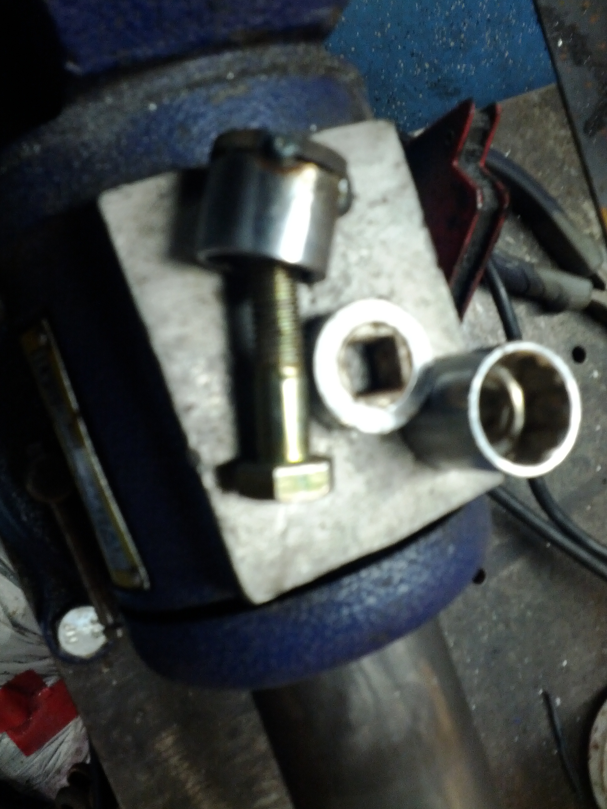

Also made some high mis-alignment nut holders using old sockets...this has proven to be invaluable.

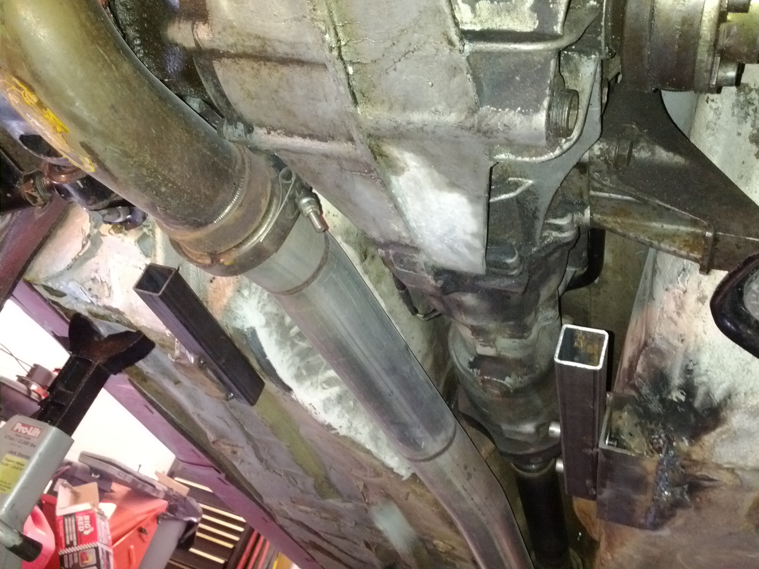

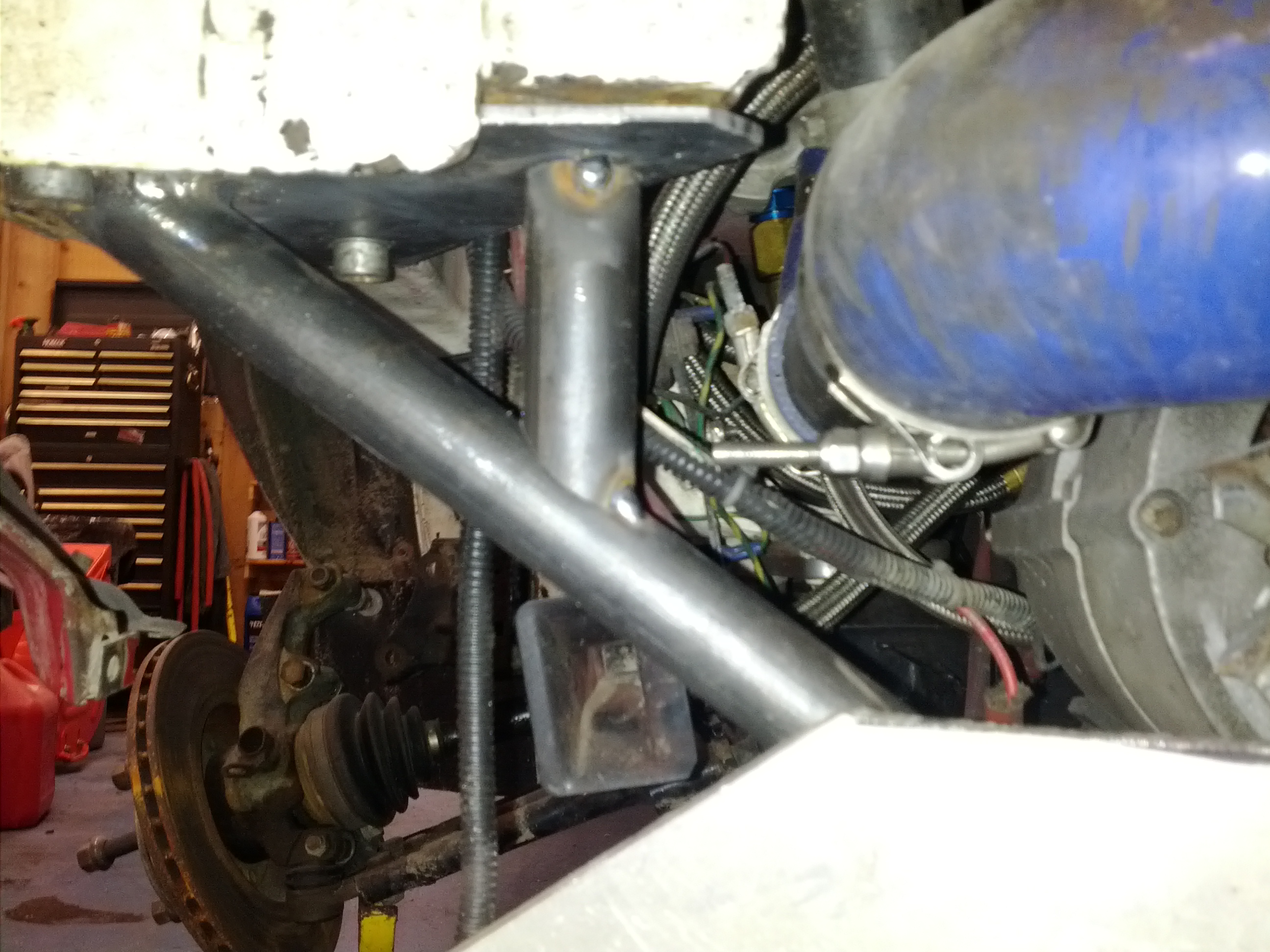

Square tube to the underbody
2012-04-06 16.42.39.jpg (1.59 MiB) Viewed 48628 times
Smaller square tube to the skid plate
2012-04-06 16.43.00.jpg (1.41 MiB) Viewed 48628 times
Slip square tubes into each other, 2 bolts - and you're good (I also have hitch pins that go through the square tube in case I do loose the front somehow)
2012-04-17 20.16.32.jpg (1.21 MiB) Viewed 48628 times

Skid plate is pretty weighty - but it still got bent by a rogue baby head in Saguenay - deflected enough to bend the bolts on the oil pan extension...but the car, with 1/2 tank of fuel and a spare tire came in at 3038#'s
