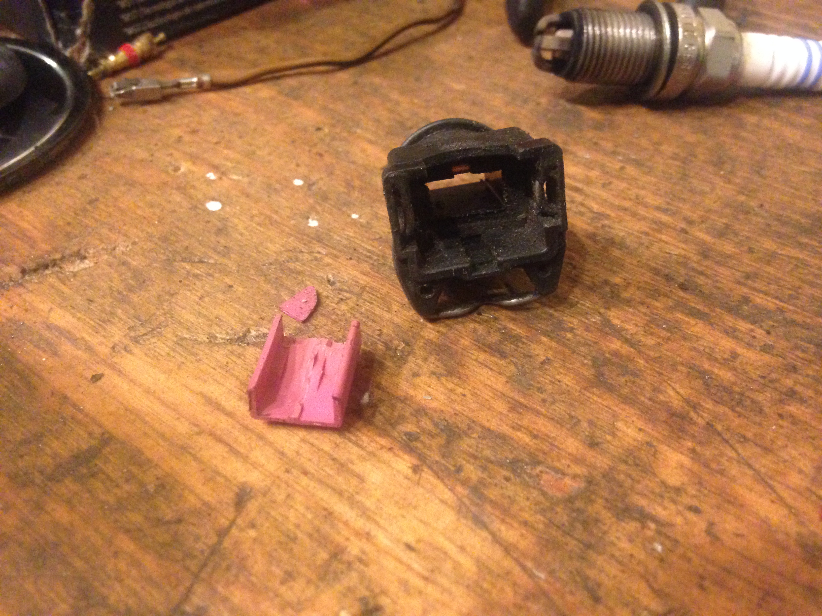

car is running good, although it wasnt at first. as it turns out cyl #3's injector was not firing. when i pulled the plugs in an attempt to read them the #3 still looked brand new while the others looked normal. Tested for spark and it was a go, pulled the injector plug and the inner purpley thing that holds the wire pig tales apart was broken apart. There was another unused plug i noticed when i pulled the motor that i tracked down and removed to harvest the broken part from. it was difficult to remove the wires from the piece but they came out with minimal damage to the part it needed. Here is a photo of the doner plug with the broken piece from the injector plug.
- 6.8.18 028.JPG (1.63 MiB) Viewed 59903 times
now the car is running much better now that is on all 5 again
