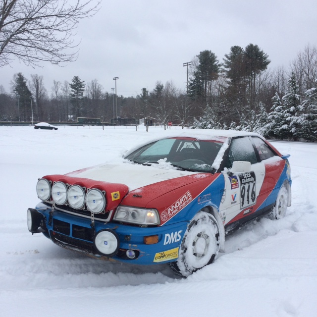

New livery!

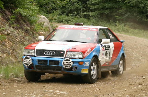

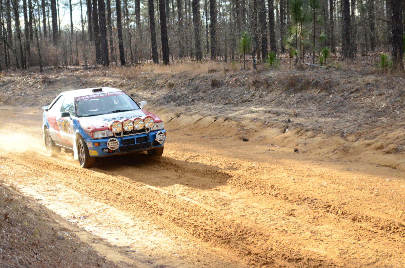

I'm long overdue for an update.
The car has completed 2 rallies since last update; Sandblast rally in SC and ESPR in NY. ESPR we had a fuel pump failure due to anti-slosh material clogging the pump. I guess they installed this anti-slosh stuff when the car was originally built. We limped back to service and replaced the fuel pump with a spare. Finished the rally although technically DNF'ing due to missing a stage. At Sandblast we finished without any problems. I fucking love this car. Sometimes I just go in the garage and look at it and dream. I can't believe I own this beast.

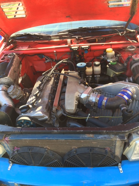

Awesome pics.
You have any engine bay shots with the EFR in there?

Afterthought wrote:Awesome pics.

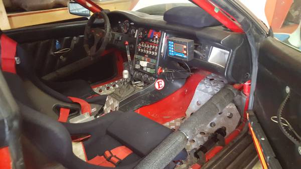

Yep! See below. Random photo dump. Old school laptop tuning the Motec M48 for pump gas, new seats, blow shocks, rebuilt shocks, inlet restrictor 3D printed, sugary TIG welds,
