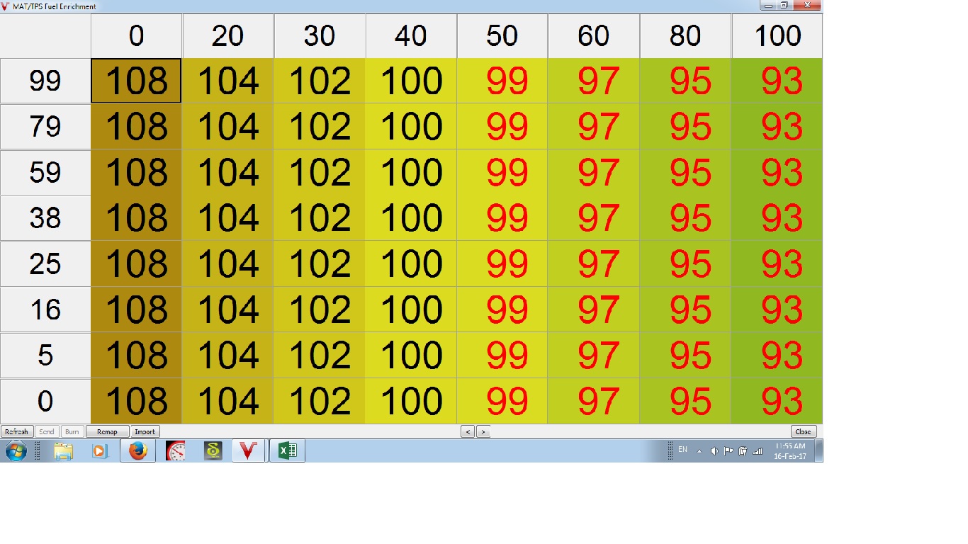

I have been adjusting the MAT/TPS table the last few days. Can't believe I ignored this for so long
Always expected my EGO correction to take care of things. Silly me. Every time after a run, I am adjusting my VE table up and down in the same cells. Drives me up the wall.
Still, I have been fine tuning my warm up enrichment, now the MAT/TPS fueling. I was reading some posts on the Guild of EFI FB page yesterday and realized that of course IAT has an influence. I am an idiot
I am using 40c now as my benchmark, because that is my usual IAT when engine is warm. Put my MAT/TPS table on a linear slope. Just watched my hot idle IAT sitting at 52c and 1.04lambda, inj PW was 1.6ms, which is the lowest stable PW for 630cc Dekas. Adjusted the table and went right back to 1.0. Win. Learning by doing takes a long time...

That IS an odd table. How did you come up with this?
Re: Fueling table viable year round?
I've only been in the middle 4 column range
You can probably disregard all but those and the -10 one I think. Just the nature of the beast I guess lol
