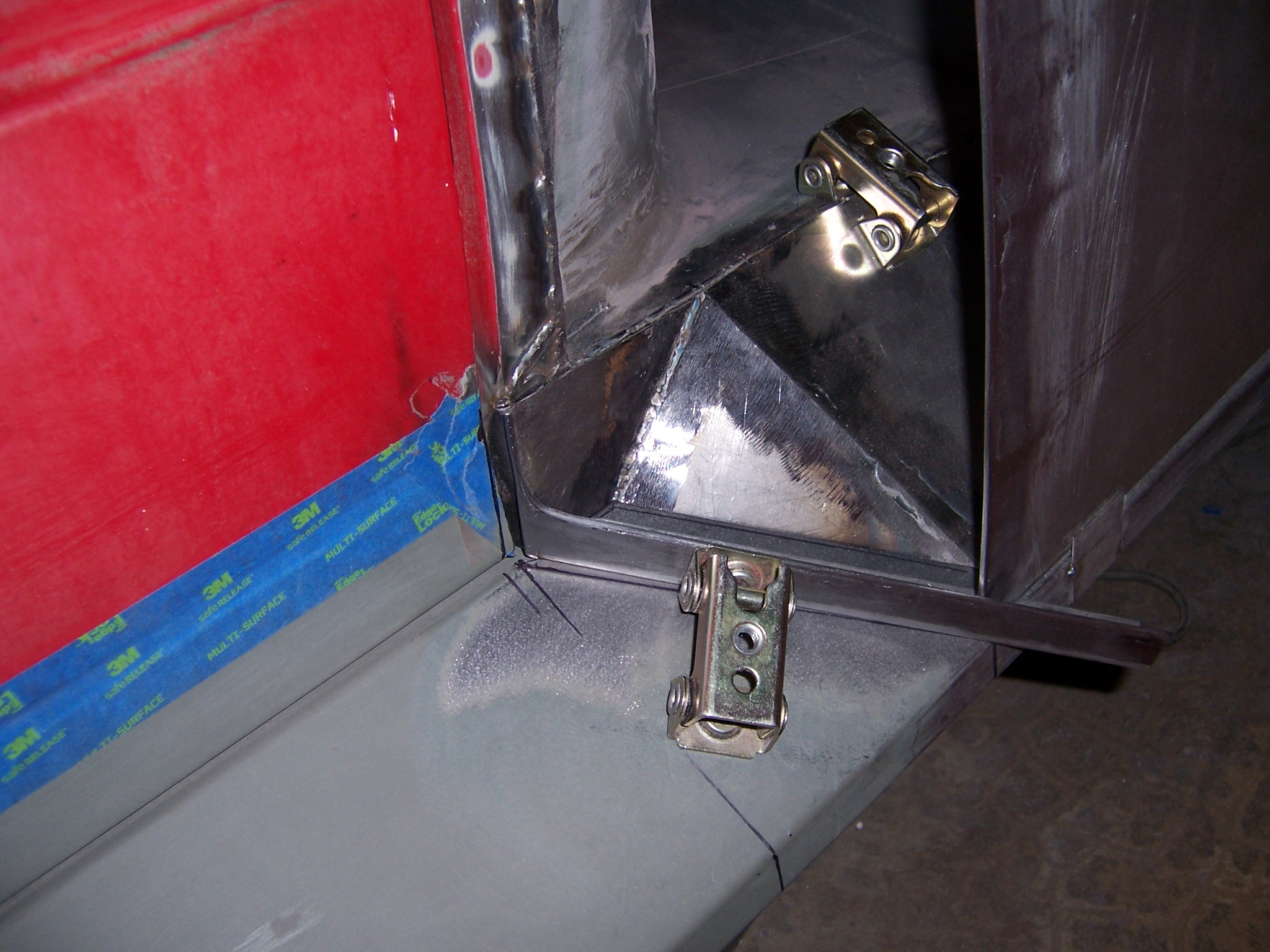

So the front of the Rad air intake needed a transition (see pic. above). Made one of these for each side. (Still needs to get cut flush with the rocker)
Side panel on pass. side cut and fit. Have to do the other side yet and then prime/paint and then weld the panels permanently.
Getting there......
Mike

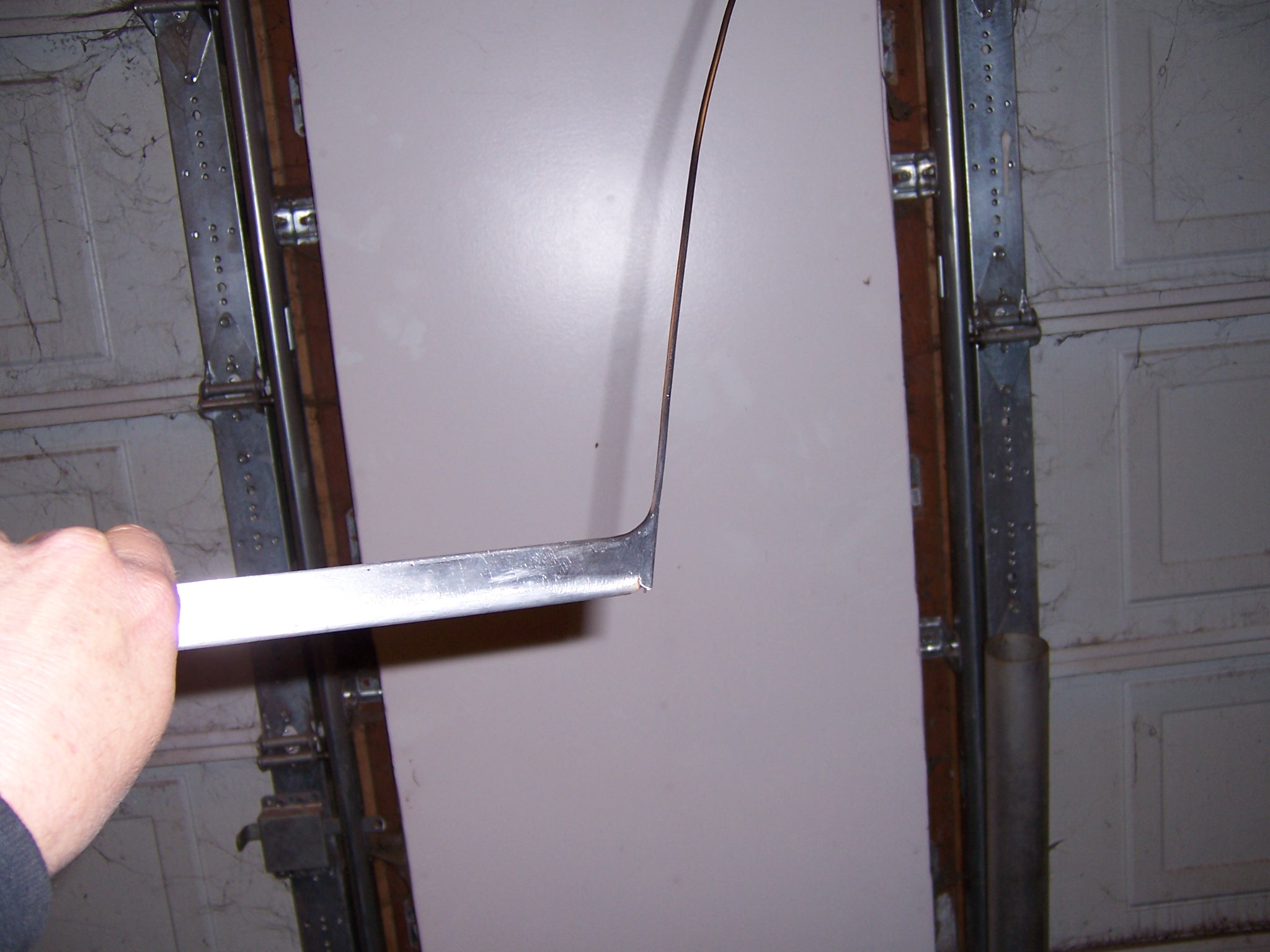

Bottom of Rad intake closure pieces are made and have radius on uphill side. Still need radius on downhill side. This piece is for the passenger side and the wire is longer than the other, as the pass. side was hit in that area and the wire reestablishes the body line.

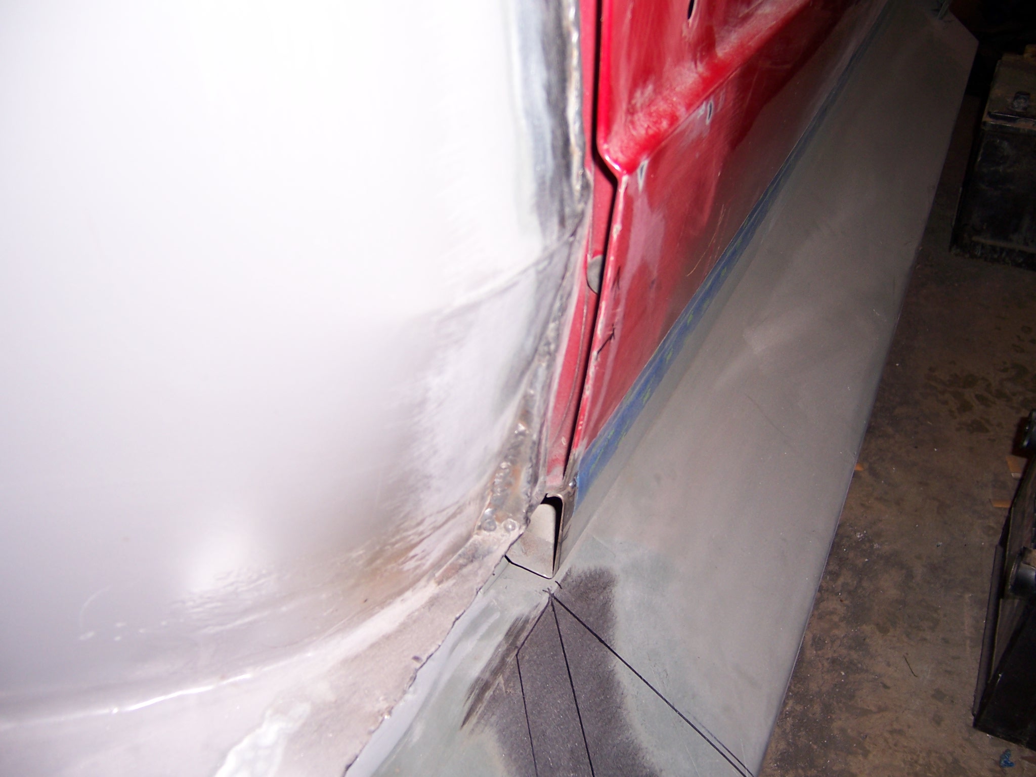

Area that was hit. So one part was pushed in and the door edge was pushed out, that required some brutal hammer blows to straighten. You can see the area that needs a new bodyline.
Other side mocked up. On this side the wire is quite a bit shorter as all the sheet metal meets nicely.
Still have two more transition pieces to make for the side of the Rad intake. Need to get those done before paint and final welding.
