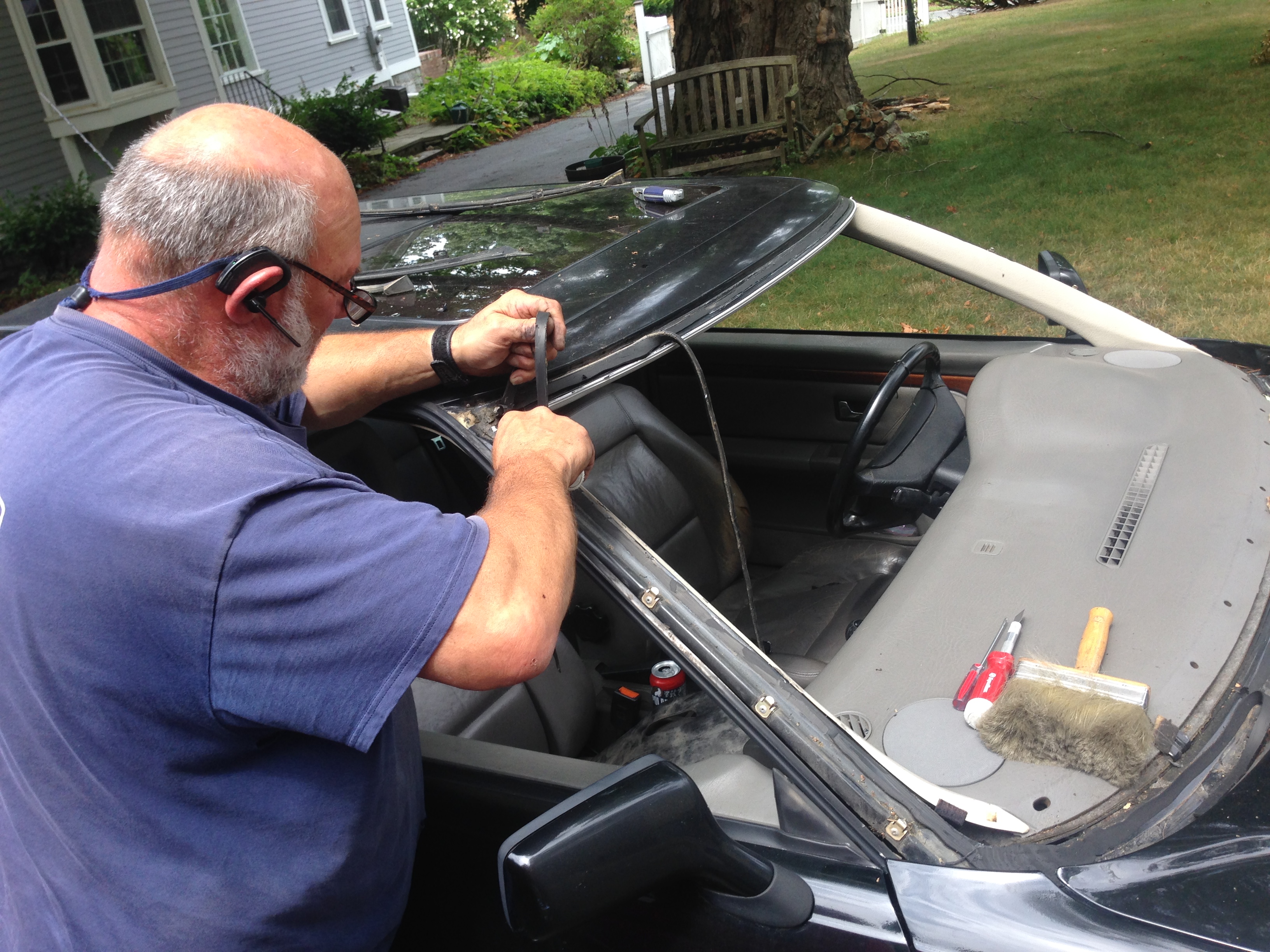

Don replacing a Coupe Quattro Windshield for me this past summer
- DonCotton - 1.JPG (2.33 MiB) Viewed 41036 times

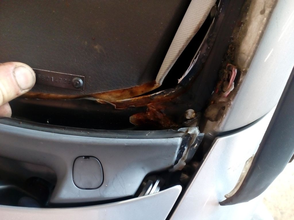

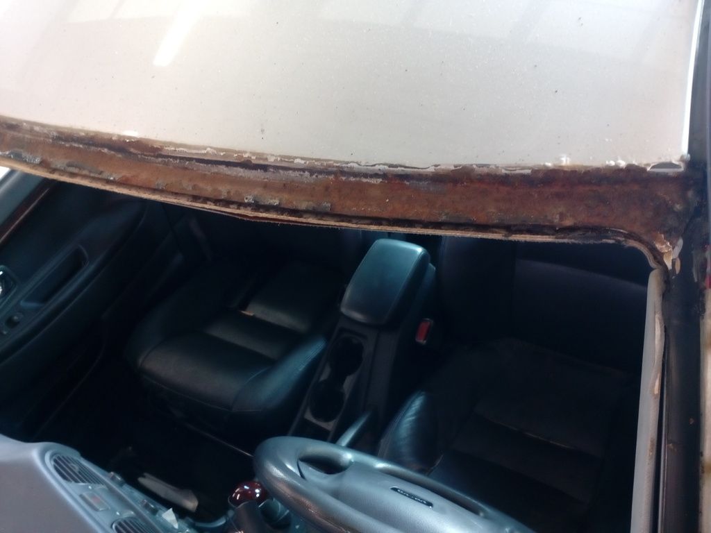

Sounds like me, last year. "It'll be fine, the windshield never leaked, go ahead and remove the old one..."elaw wrote: He was great to work with, punctual, and did great work as far as I can tell. He made a big fuss when I first called him about how much of a problem it would be if he found rust where the windshield attaches, and I didn't pay much attention because this car is almost rust-free.
Well long story short, it's pretty much rust-free except in one place: where the windshield attaches!
LOLNOPE
