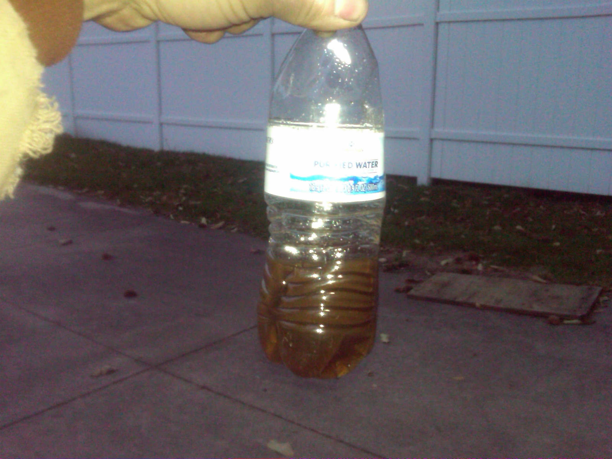

So I have a big concern. I cranked the motor for awhile today to no avail. I need some serious help here. The turbo feed line pumped out this much oil tonight after cranking for like 10 or less seconds. The oil check valve is new and I spoke to the machinist who said they had ZERO concerns while installing it. I provided full explicit instructions on it and all page #s were marked in the provided Bentley. He mentioned perhaps an oil galley or some such f#cking thing couldve possibly been left out and I about lost my lunch at the thought. Does that notion hold any water in your opinions? Wtf I'm gonna need jesus after this ordeal.

Isn't oil supposed to come out of the oil feed line? Assuming it wasn't connected of course.
That's the only place though so far lol. Both oil pressure sensors are removed to watch for oil but even after cranking for 2 minutes yesterday those 2 ports stayed bone dry. I'm considering blocking the turbo feed to see where oil comes out next

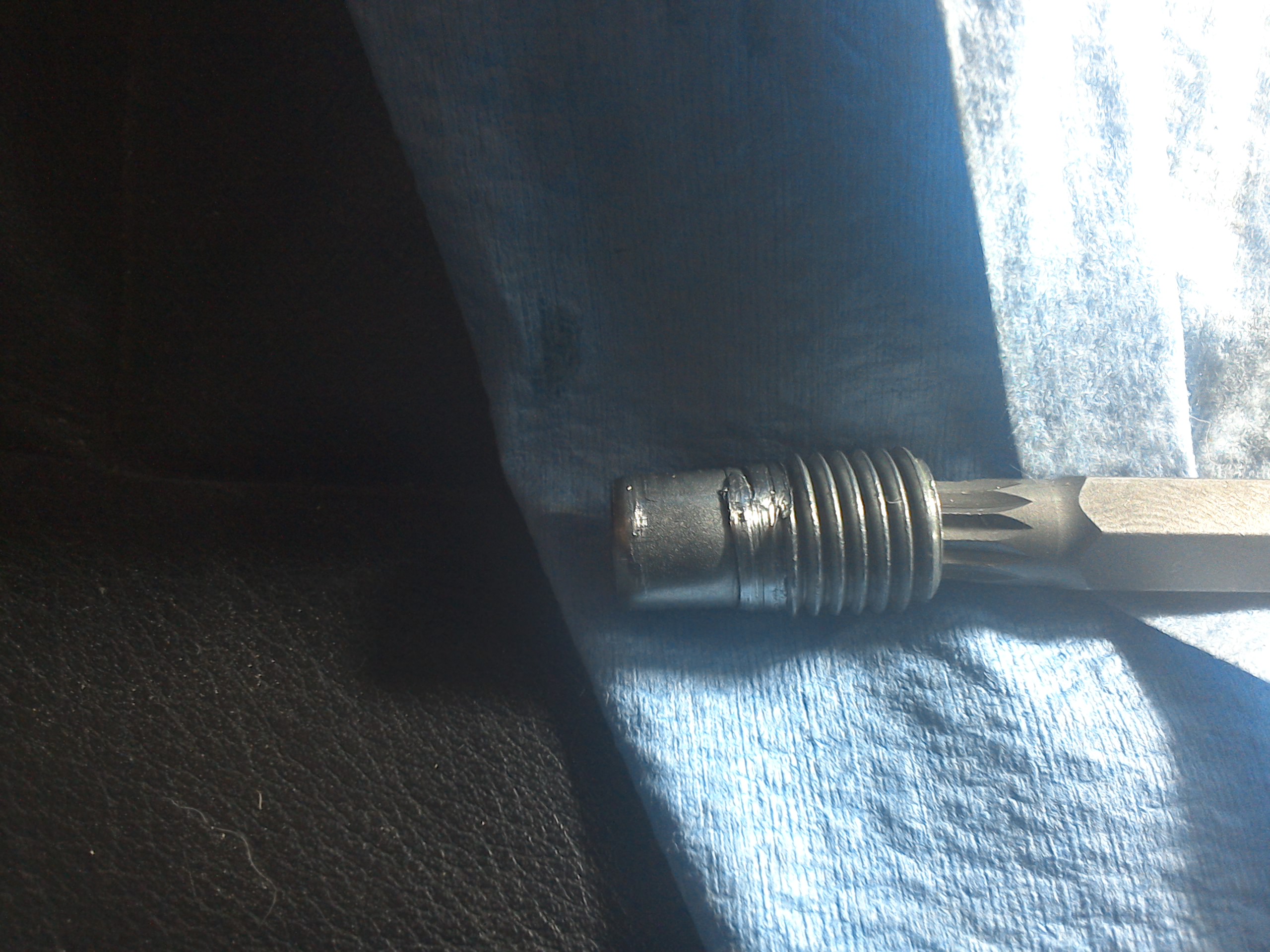

Gah! I'm leaning toward faulty checkvalve possibly? This is the extent of damage to it below but when I tried to start the car with it out oil came shooting out and it didn't even actually start! That was a split second of rotation only
What do you guys think? Lower threads are effed up tho?

Hmm machine shop should be questioned
Right on. I feel like those mash marks are unacceptable. Maybe it was bottomed out too harshly? When I install the new one should I only put it in to a certain point? I feel like torquing it might result in the same damage possibly.
Sooooo... shall I replace with 046103175A or 077103175B?
Kinda looks to me like they cross-threaded it. You will want to chase the threads in the block with a tap if you can.
Holy shit idk if i trust myself to get everything out after
It's not like your tapping a fresh hole, just put some grease on the tap.
