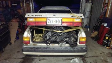

Let's start with some good old 5cyl content: the $500 5k of win bringing the engine home
The Engine.jpg (18.08 KiB) Viewed 25860 times

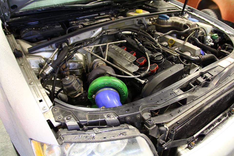

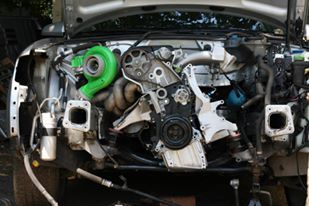

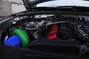

Clean engine bay
Engine Bay.jpg (18.93 KiB) Viewed 25860 times

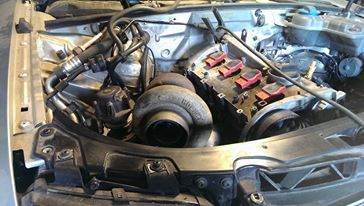

Gromit with the 7 blade HX35
Holset Gromit.jpg (23.5 KiB) Viewed 25860 times

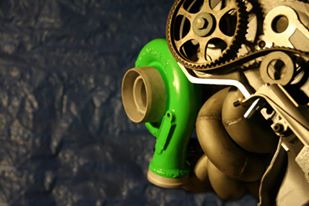

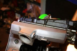

Manifold mockup
Manifold Mock Up.jpg (23.55 KiB) Viewed 25857 times
Manifold Mock Up 2.jpg (11.85 KiB) Viewed 25857 times

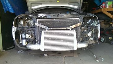

Intercooler install
Intercooler 2.jpg (16.8 KiB) Viewed 25857 times

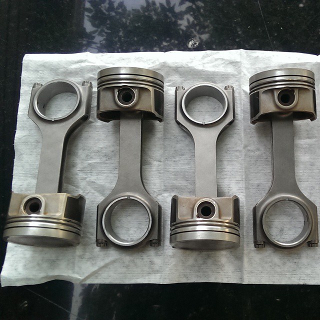

AEB pistons and Scat rods
Pistons and Rods.jpg (105.16 KiB) Viewed 25856 times

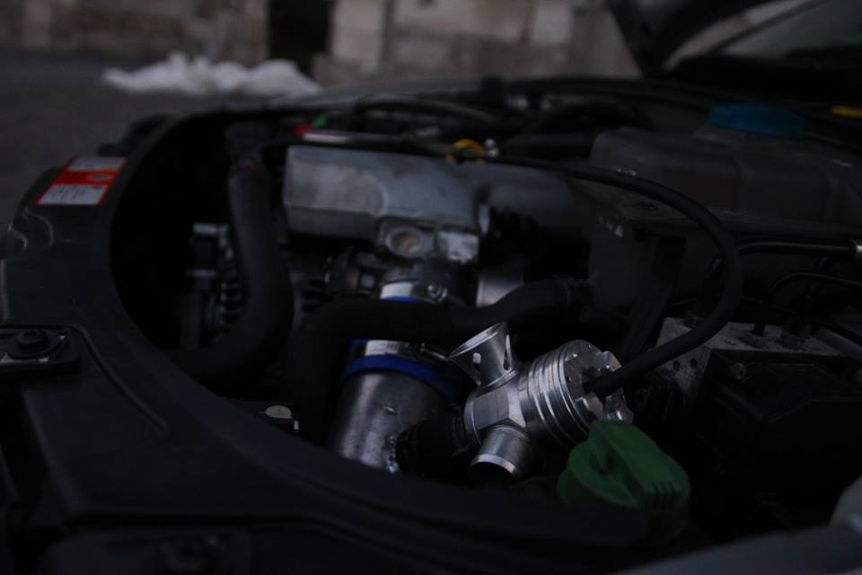

These aren't really photoshopped except for a couple small grease spots despite their name :)
Photoshop Bay.jpg (12.29 KiB) Viewed 25856 times
Photoshop Bay 2.jpg (33.2 KiB) Viewed 25856 times
