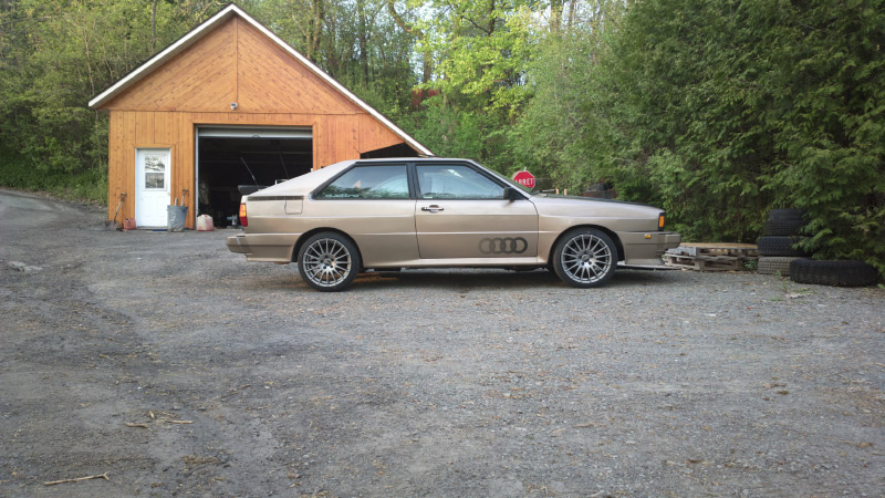

Ended up with superturismo's in et35 8" and 215 40's
