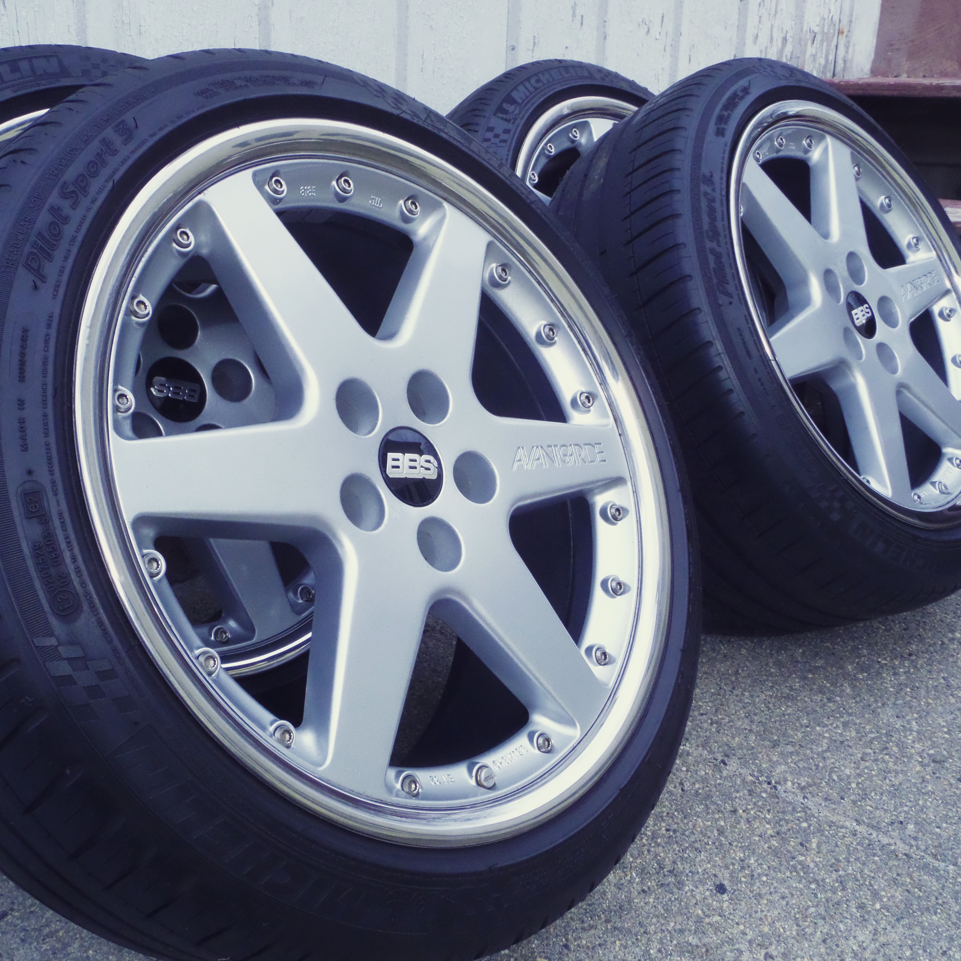

I purchased a year ago (wow time has flown) a set of 2 piece wheels made & stamped by BBS for Avantgarde. They are model RT 117- 8.5 x 18 ET 32 and were never mfgd for the US market. I had them imported from Germany. The center bore is 57.1mm and is a direct fit for the Audi B7 platform with stock brakes.
I had one shipped down to BBS in Georgia for an outer polished lip replacement. Thankfully these utilize the same polished lip as the BBS RSII. New bolts were installed as well with a total cost of $250 with shipping both ways. A price well worth the overall rareness of these wheels IMHO. BBS in the states would not sell me a replacement lip so I could 'do it myself' sorta thing. :( I'm yet to see if I can source them from thru BBS in Germany.

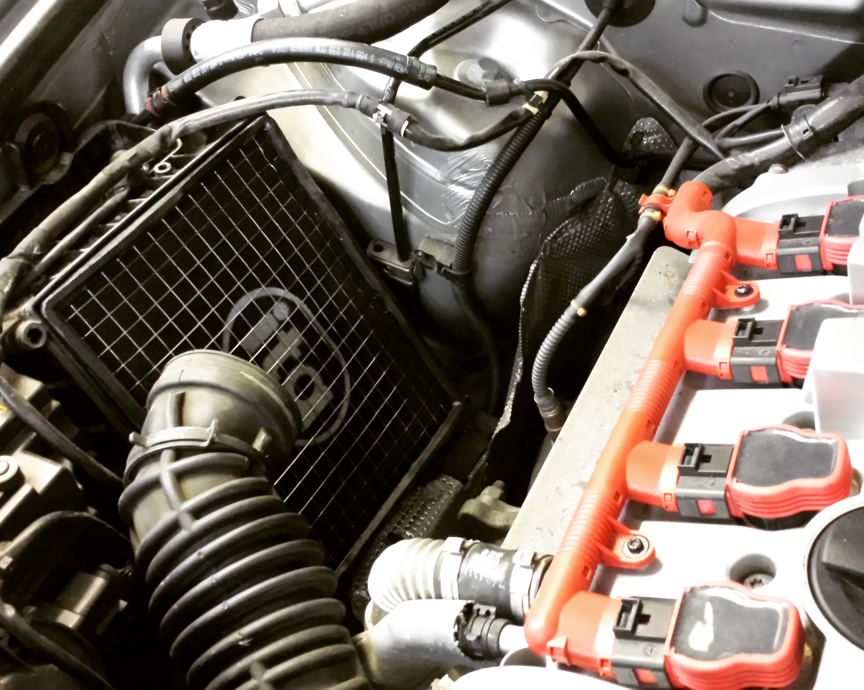

I did finally get my gift of an ITG foam, oil lubricated air filter from England installed at the same time as my last synthetic oil change just months ago. It's working superbly! A red loom was also installed right after the red top coils.

So I've received a couple PM's about my wheels where the Avantgarde is stamped on the face of each wheel & stamped BBS on the back. Here's a pic of the rear of the wheel and in the top left corner is the partial face stamped Avantgarde.

Mystified wrote:So I've received a couple PM's about my wheels where the Avantgarde is stamped on the face of each wheel & stamped BBS on the back. Here's a pic of the rear of the wheel and in the top left corner is the partial face stamped Avantgarde.
My BBS Avantgardes, have the same BBS stamp on the backside. I love it when persons tell me, it is not a BBS wheel. I have the carbon fibre BBS center caps, just to make them crazy.

Awesome!! As you saw in my pics a tad further up I've got the CF center caps too. Last year I was asked a couple of times why BBS center caps on the AG wheel...
But being I'm female & all, some peeps still question what I say to be accurate. And when I tell them how long 'I've been in the Audi game' they come to their senses! ;) I'm by no means a know it all, but I'm blessed to have learned a lot over the years on a variety of VAG autos. :thumbsup:
And this reminds me, I need to pick up a couple of spare center caps! I either lost one right before winter change over or I was met with a thief! :thumbsdown:

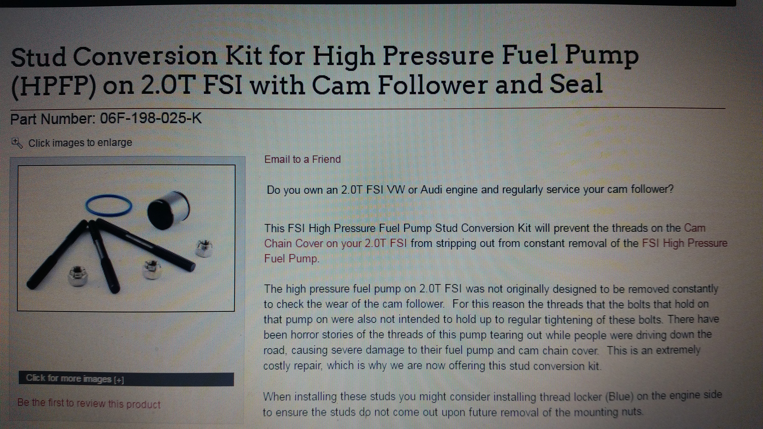

Cam follower is due for a check and replacement. Found a vid with the tutorial for the R&R which is quite straight forward and the company sponsoring/making/owning the vid offered a stud conversion kit for the 2.0LT which is in my B7. Buying the kit makes total sense when you factor in how frequently the CF needs to be inspected for wear. The $94 shipped is well worth the relatively small expense against the wear the regular studs will receive over time. :thumbsup:
Provided I get it this week, it will go in next weekend. No Carlisle for me this year. I'll miss all the great people there for sure! Next year! :)
https://deutscheautoparts.com/06f-198-025-k.html
