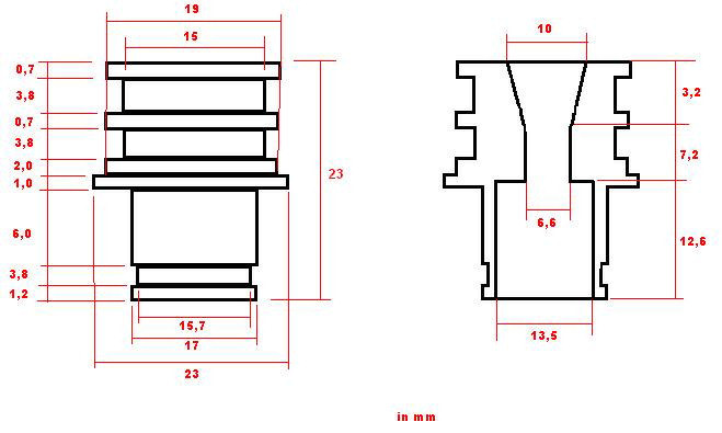

dalspaugh
Posts: 219
Joined: Thu Aug 14, 2014 1:09 pm
Location: Seattle
Re: Replacement O-rings for 034 Injectors?
Post by dalspaugh »
'95 Audi 90Q
'91 Audi CQ Project: Davescq.wordpress.com
'00 Buell X1 Racing Stripe
varia
Posts: 354
Location: Los Angeles
Post by varia »
Multipurpose O-Ring, Oil-Resistant Buna-N, 3mm Wide, 14mm ID
http://www.mcmaster.com/mv1460752213/#9262K271
¯\_(ツ)_/¯
project 2226

varia
Posts: 354
Post by varia »
what i posted is for the 034 adapters.
¯\_(ツ)_/¯
project 2226
dalspaugh
Posts: 219
Location: Seattle
Post by dalspaugh »
0ooo, gotcha!
thanks for this little pseudo-drawing of the adapters! For the o-rings from the adapter to the fuel rail, I just ordered those straight from 034, fitment is nice and they were cheap (since I was ordering other stuff too...)
got the amazon o rings in last night but didn't have a chance to check fitment. This weekend.
