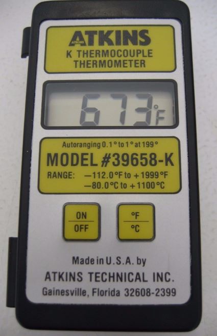

If you recall again, the length of the resonator is crucial to it's effectiveness at attenuating the target frequency, so I need to know the approximate temperature of the gas inside the pipe while under operating conditions. I like to overdo things, so I spec'd an EGT sensor which I would trust for the job in one of the manifold runners for the revver in the future.
- Vibrant 304L EGT bungs (???)
- (I like this one) TheSensorSource.com EGT Sensor

- Atkins type K thermometer for use with the thermocouple (made in Gainesville, FL USA!)
type k thermometer.JPG (43.59 KiB) Viewed 32068 times
