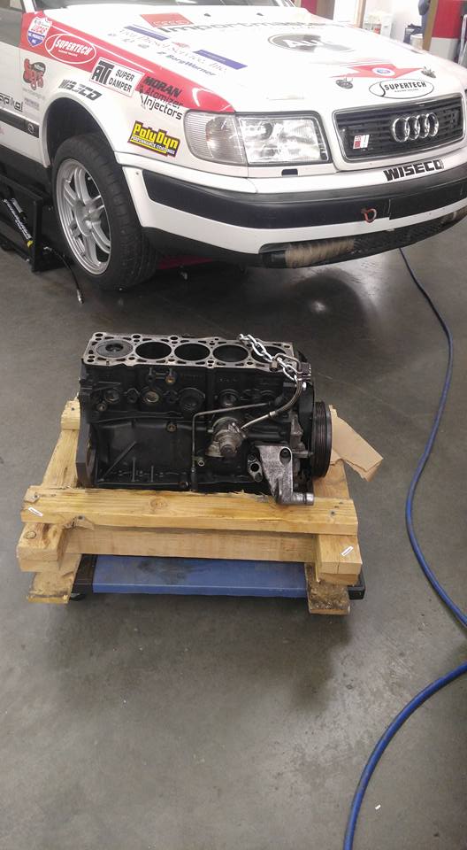

But here are some pictures finally.
Here's the block just after arriving at Jeff's
revver block at jeffs.jpg (65.47 KiB) Viewed 59693 times

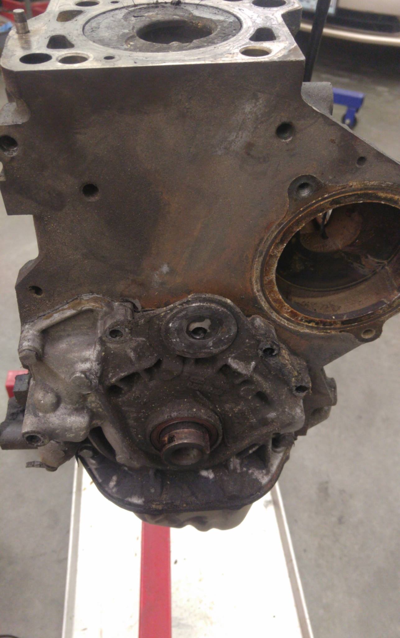

Before clean-up
revver block clean up.jpg (86.01 KiB) Viewed 59693 times

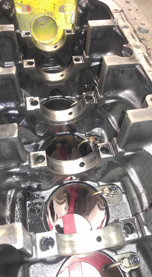

Disassembly
revver disassembly.jpg (187.3 KiB) Viewed 59693 times
Re: Chris' 200 20v Sedan - The Revver - Turbo Found
Something bad happened to that piston lol ^^^^

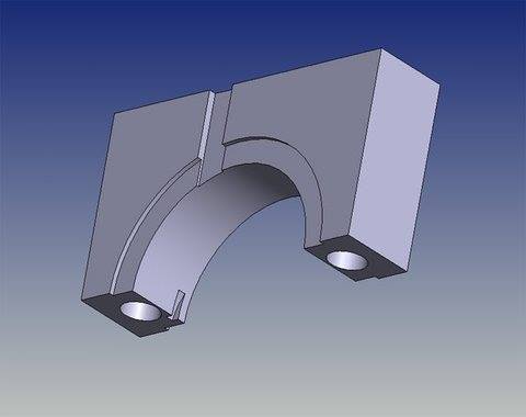

I've been talking to someone about making custom main caps for me which don't require line boring, only line honing. The reason is because the cost for line boring is significant. Having caps made with reference to the stock caps and measurements from the block they go in may offset that cost. The other option is to treat the stock caps, but I'm not very keen on that idea compared to a beefier cap made from a high performance alloy.
revver main cap design.jpg (12.15 KiB) Viewed 59691 times

I've been thinking of those billet main caps as well lately, but are they any good if one tends to stay under 8000rpm?
Oh wow! That's crazy, I had no idea.
Juizer, it's not worth it at all for less than 1000hp. Even then, it's debatable. I just like to overbuild in this situation.

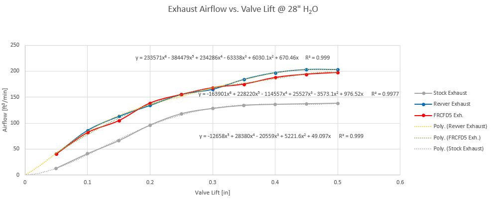

And because I'm a nerd, here are plots of my head vs stock vs another member here FRCFD5.
Intake Head Flow.JPG (45 KiB) Viewed 59586 times
Exhaust Head Flow.JPG (44.93 KiB) Viewed 59586 times
Some interesting numbers related to this. Total flow under the curve (not in CFM... I still have to wrap my brain around this lol)
RevverIntakeIntegral = 88.0807
FRCFD5IntakeIntegral = 87.5234
StockIntakeIntegral = 63.1604
RevverExhaustIntegral = 69.1274
FRCFD5ExhaustIntegral = 67.4617
StockExhaustIntegral = 46.8809
After thinking about it for bit, I see that the unit for these numbers is [in*ft^3/min] which is rather meaningless, especially when taken out of context. It is best to just use it as an arbitrary number to compare with. The best way to do that would be to compare to stock as a percentage. As a total over the valve lift profile, the revver has an improvement of 140% on the intake side and 148% on the exhaust side.

As far as the area under the curve, if you have the cam profiles between stock and whatever you're running, plotting the flow versus an engine cycle would tell a much more meaningful story. Increased lift and duration will only add to the improvement shown from the valve lift data and be a little more indicative of actual engine flow.
