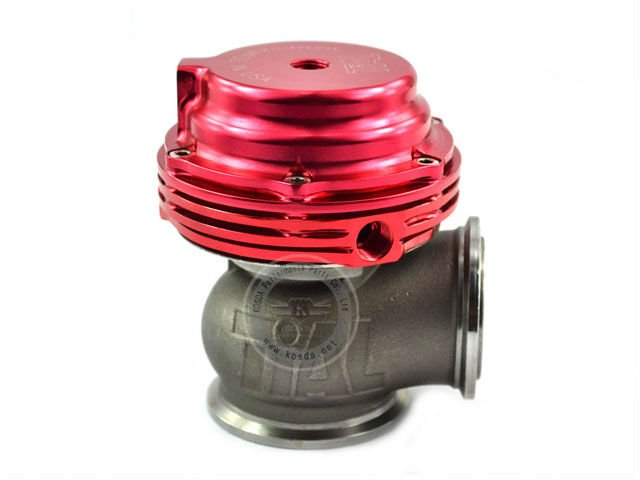

A plan, I made:
A fake Tial
= fake respectable build :flag:
Fake Tial :(

ive heard lots from my friend Dave (hi Dave :wave: ) about the merits of owning a turbonetics 38 mm wastegate. I see there are fake Tials and obviously the real ones would have to be out there too. So what do yous think of a friendly competition of comparison between Tial and Turbonetics WG's? Thought? Anecdotes? Thanks all
REALLLLLY don't want to spend overy $200 on one. Used is likely a preference so as to obtain a higher quality piece on the cheap-ish-er. Have my eye on a used turbonetics one right now but I dont want to find out it needs a diaphragm or more in the end

There is no better wastegate than Tial. I'm convinced of that. Plus, it's made in USA.
I've scored good 38mm tials for around $120.

I like the Tial's cosmetic touches and design but I bet I'd manage to overpay for a fake and get taken if it were listed used somewhere. I just payed for the used turbonetics evolution. Now I can keep the small "T" decals I had made on the side rear windows after the turbo swap :D
