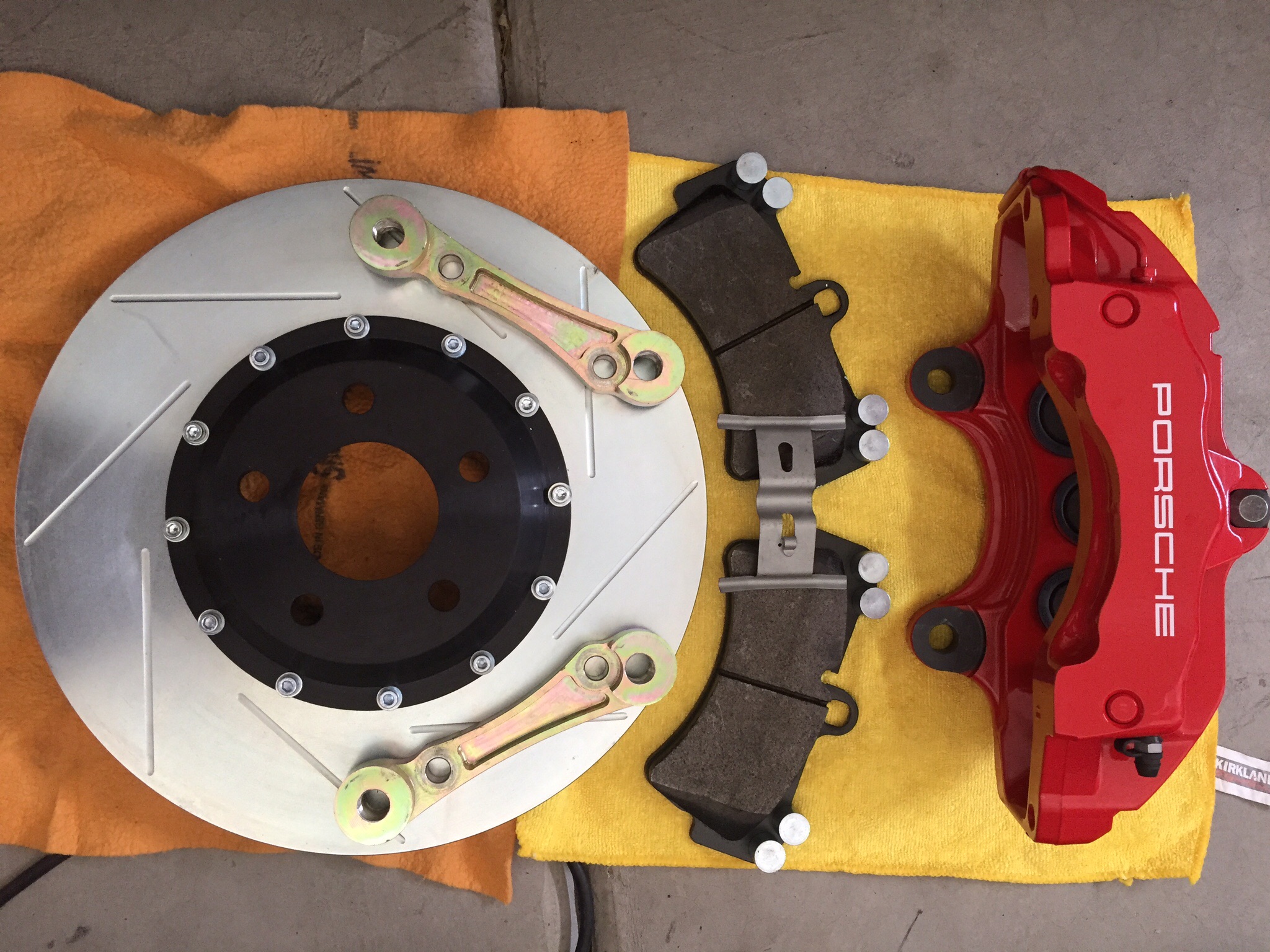

I got this Custom two piece 345mm rotors, anodized aluminum hat, custom steel mounting brackets zinc coated with brand new 18z calipers from Porsche for the cq im building.
for the rear i was planning to use my setup
and i was hoping, it will just bolt on and work. soon we shall see

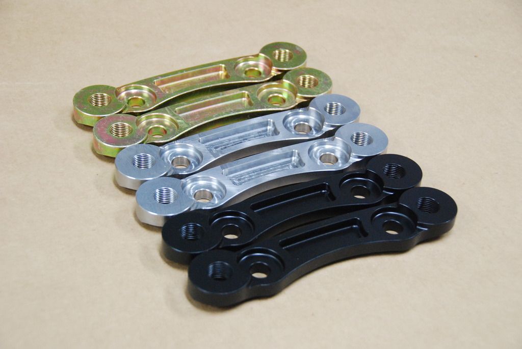

Not to derail the post from the OP's intent, but I'll at least address the fact vs. fiction question on the URS group buy BBK setup...
I put together the kit for the URS/17Z/323X30A8 setup because it was a really nice cost-effective setup where you could get a full BBK setup for <$800 all in. I've also done kits for 345/350mm rotors, but the group buy kit was intended to be low cost and able to work with 17" wheels. The use of the A8 323X30 rotor with its large offset also keeps the caliper inboard as much as possible to minimize the need for wheel spacers. And if you use the Brembo rotor (still only about $80/each) it is a nice inside vented design as opposed to the OEM A8 rotors. Brackets are FEA optimized and CNC machined in 1018 steel offered in raw or zinc plated. The custom brackets allow for a perfect fit and I've sold over 40 sets without a single complaint regarding fitment.
I've also run this setup personally for about 6K+ miles and thought I would want a brake proportioning valve, but this setup has been pretty balanced and I've done a lot of limited traction driving in the snow that would typically uncover issues with brake balance. Performance increase over stock G60's is significant. Ultimately, I think the brake prop. valve would be beneficial as there is certainly more brake force up from versus stock, but so far no ill effects without having one.
Here are the brackets:

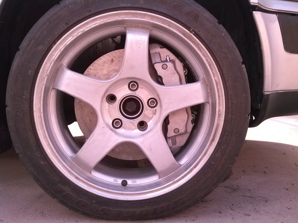

Here is the 17Z on a URS4 with 17" rims during original test fitting:
and showing the radial clearance on 18" rims:
Thanks to the huge numbers of Cayenne sales over the years, these calipers can generally be bought for $300/pair freshly refurbished from online discount parts suppliers.
