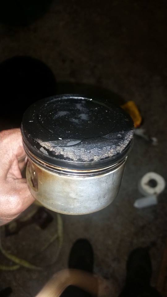

a friends S6 started knocking so he proceeded to tear it down and see what exactly failed. rod bearing on cylinder 5 is telling the knock knock joke but after an inspection down in each cylinder with a bore scope we discovered a few of the pistons where missing material from them! here's some pictures of the damage. no one has any idea what caused this and thats why im asking for input from you guys to see if you can explain why this happened of if you've seen it before.
the car itself is stock less an MTM 1+ chip set. the car was over heated pretty bad by a previous owner but we have since replaced the head with another AAN head and refreshed the whole top end with a new metal head gasket, redid the valve train, and just a good cleaning along with an ARP head stud kit.

Too much boost and or not enough fuel. Pretty much looks like a lot of detonation. Does he have a manual boost controller or something extra on the car?
Re: Strange engine failure (not my car for once!)
bummer, looks like detonation to me.
My guess would be det brought on by not enough fuel (edge of the piston became a hot spot).
no MBC or anything on it, just the MTM 1+ chips that we all have used over the years and everything else is bone stock. the car did run freakishly well, it would outrun my avant that has far more done to it. i wondered if it being severely over heated at one point had something to do with it? made the aluminum weak or something. im not even sure thats possible but with this engine im learning anything is possible lol.
also there was a good bit of oil in the crossover pipe, i wonder if it burning oil could have caused this? i was thinking of a kind of hydro lock with oil, the car did smoke but we just though it was because the turbo was cooked when it was over heated and some oil was passing into the turbine housing and being burned.

I'd rebuild it and get a wideband on the car. Something is way off

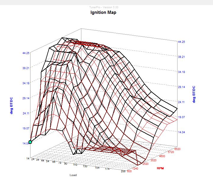

now im starting to think its the MTM chips that are in the car after loxxrider pointing out about them causing this. here's the stock MTM 1+ mapping in black and my revised timing map thats in my car in red under it. i just went and pulled the chips off of my car and re-read them to refresh my memory on what i had in there. it turns out i did adjust the problematic MTM chip sets timing to make me more friendly. at full load on the top of the RPM range the the MTM shows 21.75 degrees advance and my revision at the same point shows 18.00 degrees even.
- MTM 1+ timing in black and my revised timing in red.
Yeah, that looks like knock city.

I'd agree it was knocking. The oil ingestion could be part of that. Ingesting oil significantly advances knocking.
I'm glad you take my harsh words in stride so well lol. I think you did well to reduce the timing in that map though. I agree with Jim, every one of these old cars should have a wideband, even if it's not on standalone.
i totally agree they should have a wideband! unless the person with it has no idea what they are looking at or how to use it. i had a couple people wanting them installed just for the blinky light show and all the fancy numbers that are displayed on it.loxxrider wrote:I'm glad you take my harsh words in stride so well lol. I think you did well to reduce the timing in that map though. I agree with Jim, every one of these old cars should have a wideband, even if it's not on standalone.
are you referring to my mapping or the original MTM?audifreakjim wrote:Yeah, that looks like knock city.

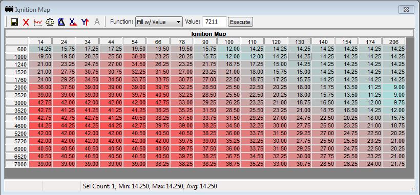

thats what i thought too. after loxxrider saying about the MTM tune killing engines that reminded me about a few threads i read on quattroworld about it a looong time ago. no one ever had any actual pictures of the mapping or anything showing what the ignition map actually looked like so i didnt know what to watch out for because i know there's a good version of the MTM 1+ out there too. i think one is the original german MTM 1+ which is the killer and the other is a later hoppen MTM 1+ which is the safe tune. here's the the 2D map of the original MTM main ignition map for everyone to see what it actually looks like. cell values are BTDC, RPM is on the left and load is on the top.audifreakjim wrote:Mtm, that's a big bump in timing at peak torque
Why does the load axis only go to 206kpa? A stock urs6 will pass that. You sure that's the right map?
Nonetheless, I'm also in the "something external caused this" camp. Bad fuel, unregulated overboost, not enough fuel, etc...
Cheers, Brady
72 240Z 123whp
www.dynodoc.ca
72 240Z 123whp
www.dynodoc.ca
The load axis is strictly load % only. Has nothing to with boost pressure directly. There are multiple values that create the load value. Boost is one of them along with several others.
