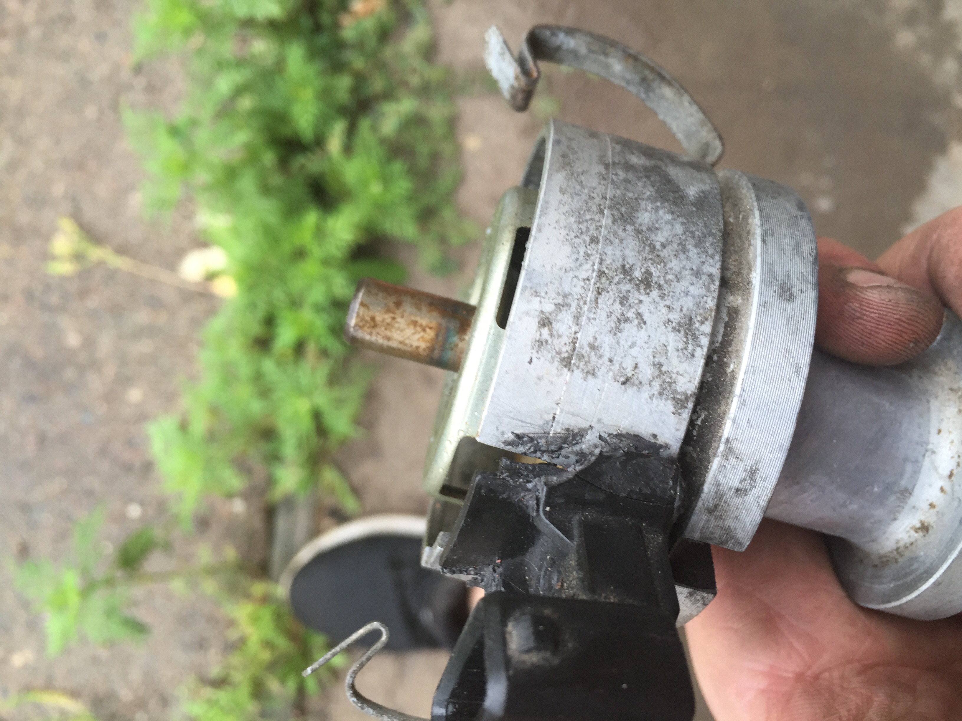

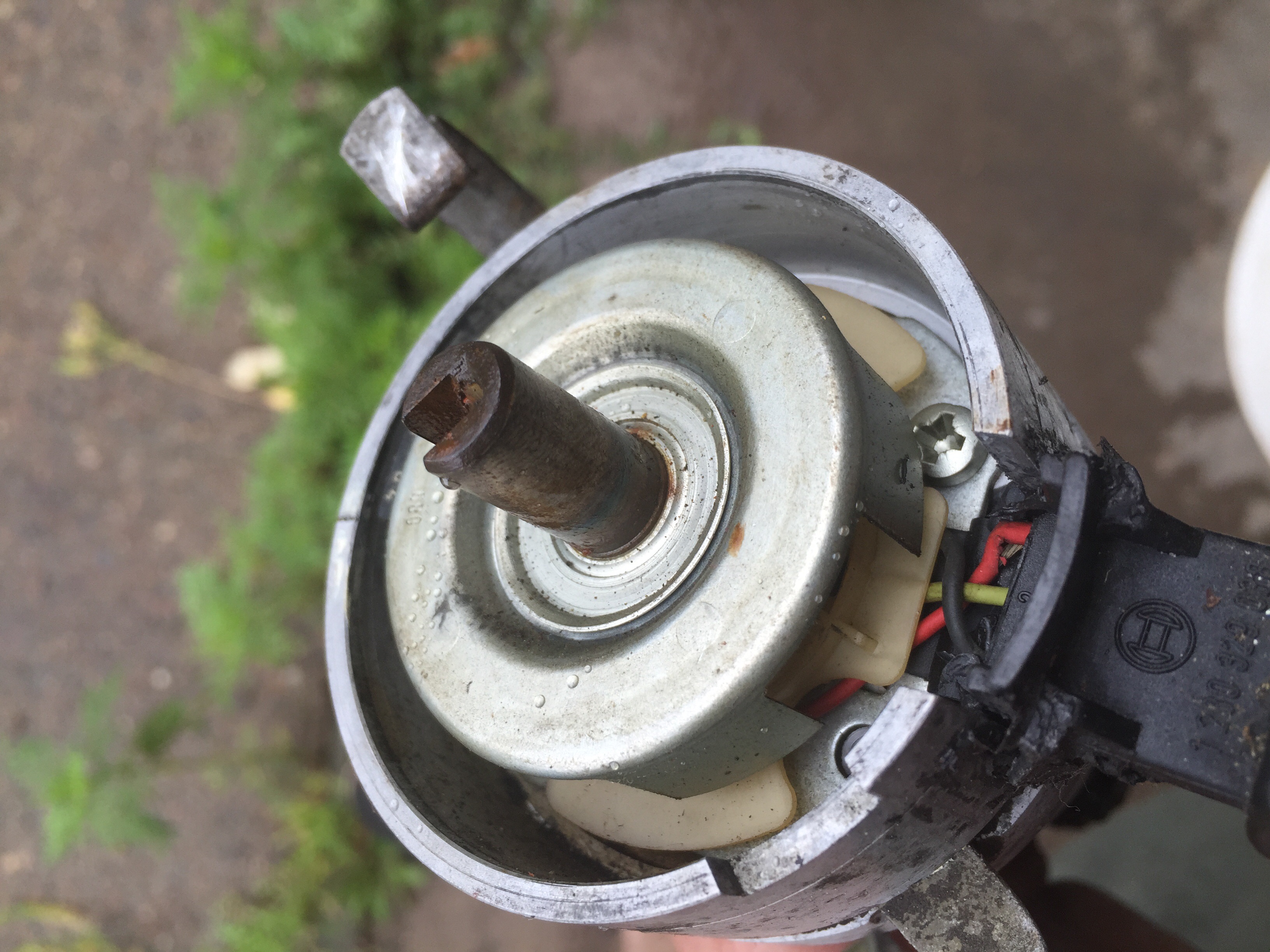

So I went to start it! I Changed the oil, doubled check everything and rolled it over. Nothing. Had a hankering something hardware wise was maybe wrong so I pulled a spark plug and it was dry. Ok... Then checked for spark and got one flash. Oooooook......
Checked all the ignition stuff and it looked fine. Rolled it over with a test light on my 12v power connections to make sure I was good on "power while cranking" and their good. Then I found a problem. This connector on the dizzy has bare wire that was shorting inside. I'd seen that it was siliconed back on and I assumed it was from taking it apart to lock it so I didn't thing toooooo much about it, until now. If you look closely at the red wire, you can see it. I noticed with the key on, when I wiggled it, the fuel pump would cycle. Being as the hall is powered from the same source as the ECU, that would explain my issue I reckon? While its cranking it's bouncing back and forth to a short to ground and resetting the ECU.
Sound like a decent theory?

That theory does sound sensible... it's surprising it didn't blow a fuse!
Hopefully a little RTV can take care of the wire but... is the connector well attached to the dizzy? It looks a little iffy.

That's what's perplexing me Eric. How didn't it pop the fuse? As for the connector, no. It's not well attached at all lol. It had previously been kind of rigged together and now I'm thinking of just getting a different dizzy. I may goop it up with silicone for testing purposes in the meantime though.

Small update.. Being as awesome as he is, DE80q sent me a couple of spare dizzys to test out. Sure enough, mine was FUBAR. Plugged one in and spun it by hand to listen to the sweet sound of clicking injectors lol. Well, 4/5 injectors... Ones either bad or just stuck. Ill sort that out after I figure out this goddamn NO SPARK bs ha! After messing with it for a few hours tonight I got the coil to at least fire by manually grounding the ICM. At least now I have it narrowed down to the ECU not doing what it's supposed to. I'm fairly certain I'm using the wrong "spark output" wire to control the ICM. From what I gather is the old 2.2 boards use a different circuit and DB37 pin than the newer boards. The older board uses pin30(fidle) to control an ICM and the new boards can have the driver already installed and use pin 36(ign output). I think I messed up and followed the 3.0/3.57 diagram that came with the harness I bought. I dunno. I'll try pin30(fidle) and see if I can get this thing to makes sparks tomorrow.

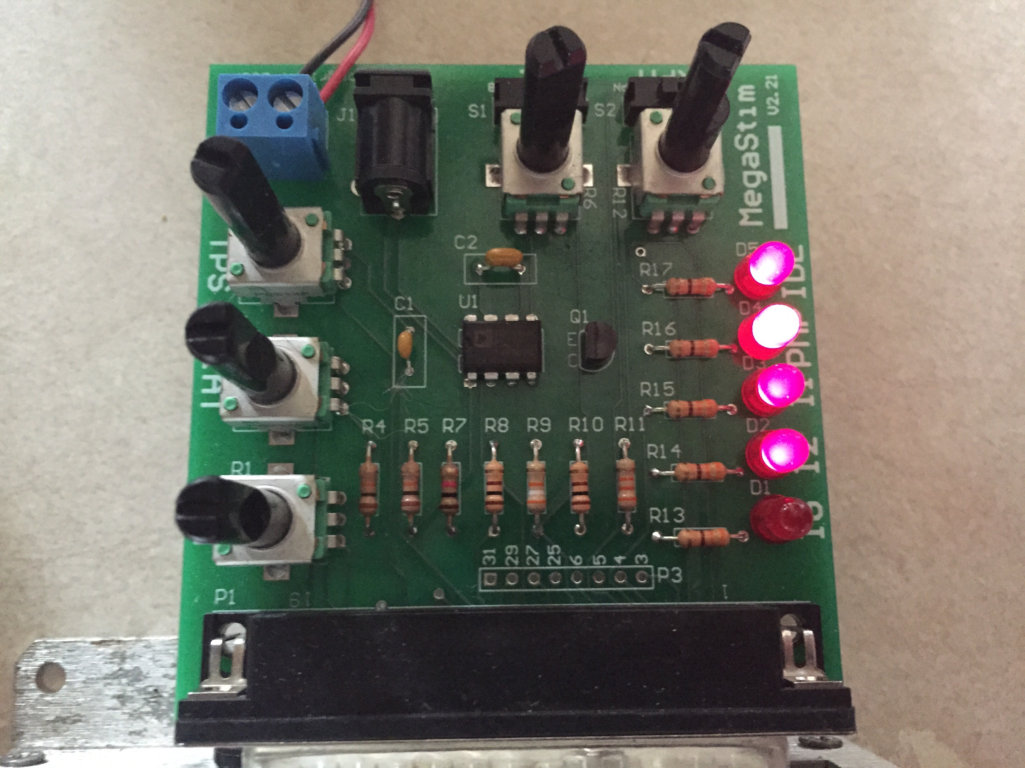

Re: Any Megasquirt vets on here?
When you're running it on the stim, does the "IG" LED flash? That's the ignition output, which should be on pin 36.
If it doesn't, it's possible I may have overlooked something when setting up the unit - there are a few connections on the V3 mainboard that apparently aren't present on the V2.2 that could cause this. If that's the case, PM me and I'll get it taken care of!

I'm not sure Elaw. I was so "done" last night that I just shut everything down once I got the coil to fire manually. I'll check as soon as I get home. Thanks!
Awww man lol. Nothing... Email sent Eric.

Yeah, my bad. I "ass"umed that the v2.2 mainboard had the spark output circuitry that the v3.0 board does and that's not the case. Luckily it's easily fixed!
