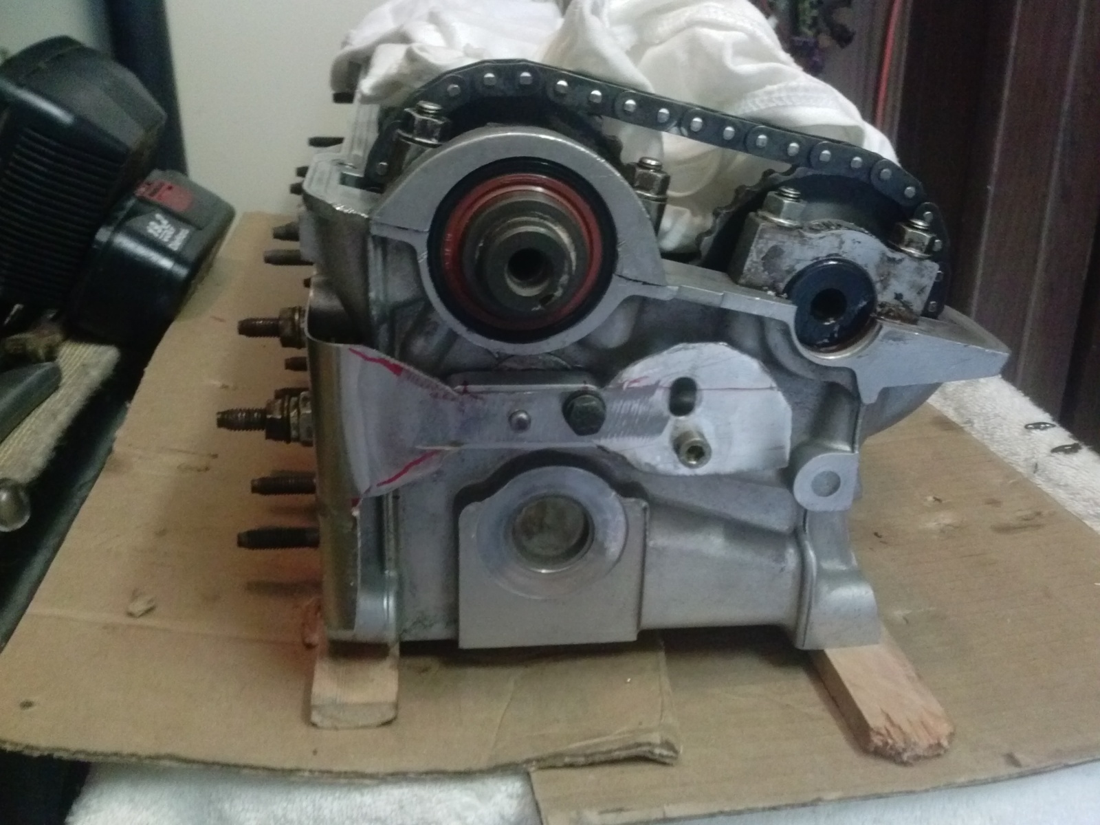

head: pick by the condition, cps is easy, i made a template:
¯\_(ツ)_/¯
project 2226
