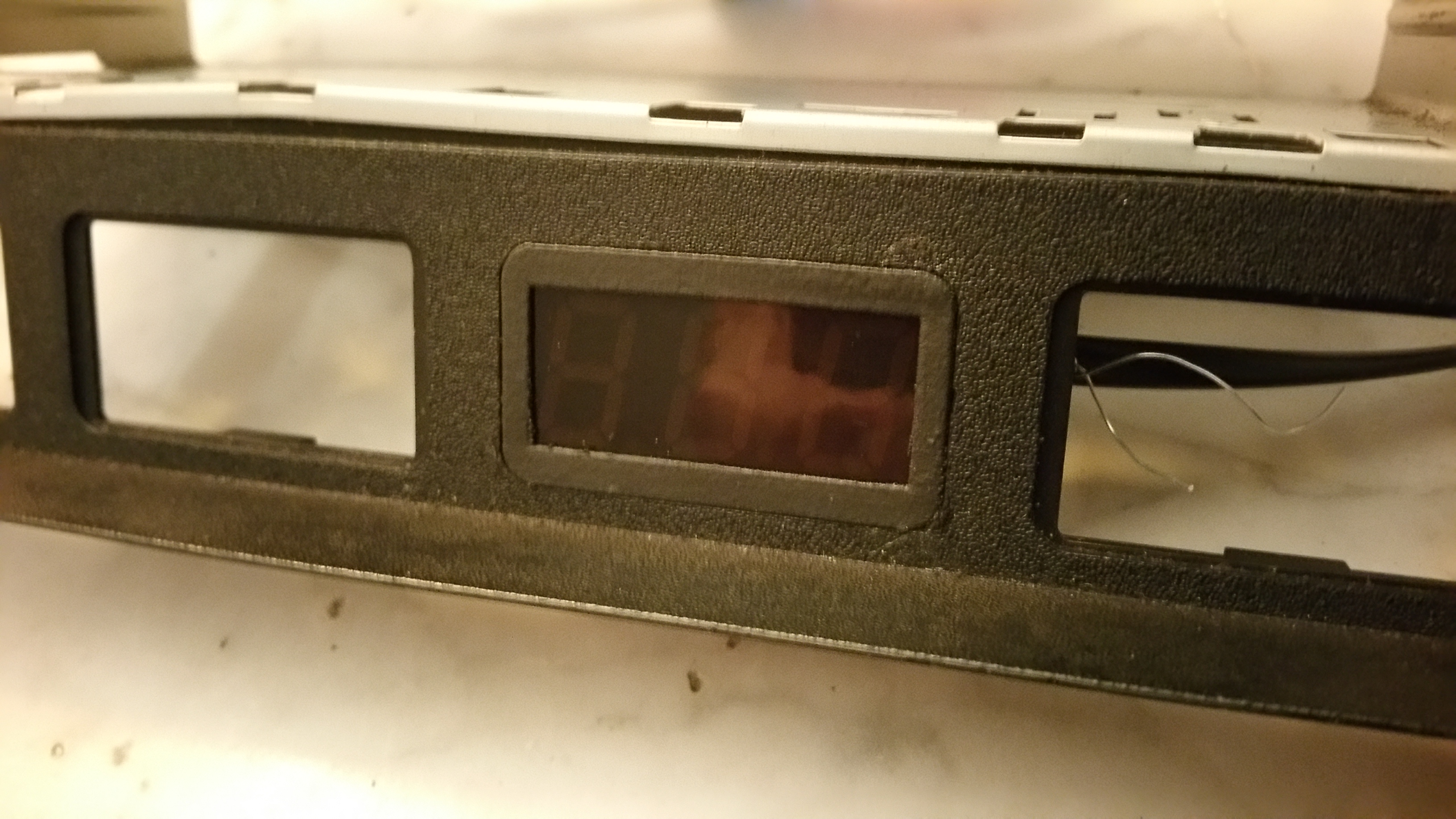

I've finally finished up that wideband gauge project I set out on last year. The only thing keeping it from working was more accurate 3d printing capabilities, so I finally but the bullet and had solid concepts print it out for me. It ended up costing waaaaaaay too much, but sometimes that what it takes to get a good prototype. It isn't perfect, but it's the best I've seen from this technology yet.
I applied a film to the front of the gauge, inserted, and all was in order :) Now to install it in the car next time I'm in FL (I was just there over the weekend, darn!)

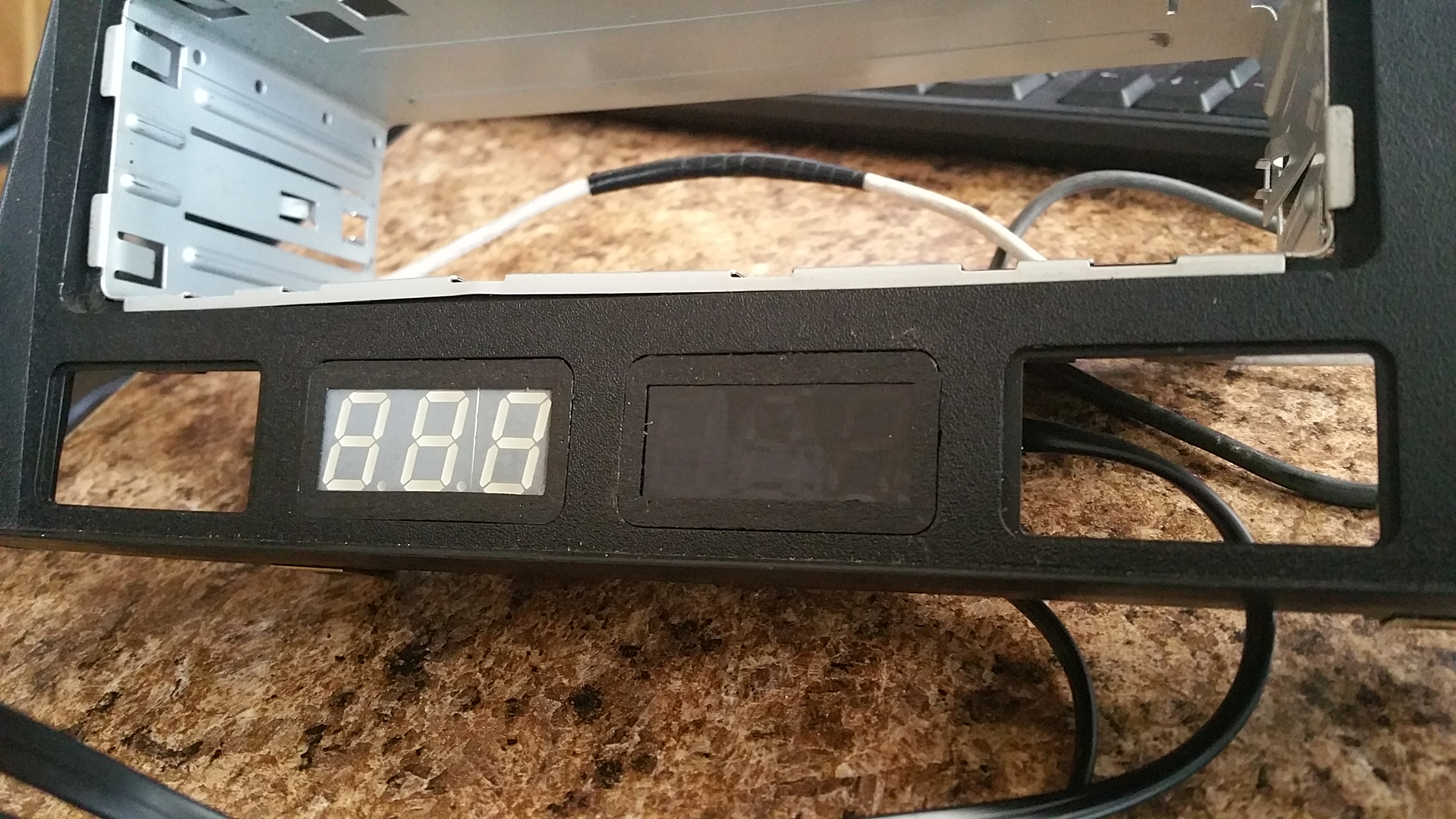

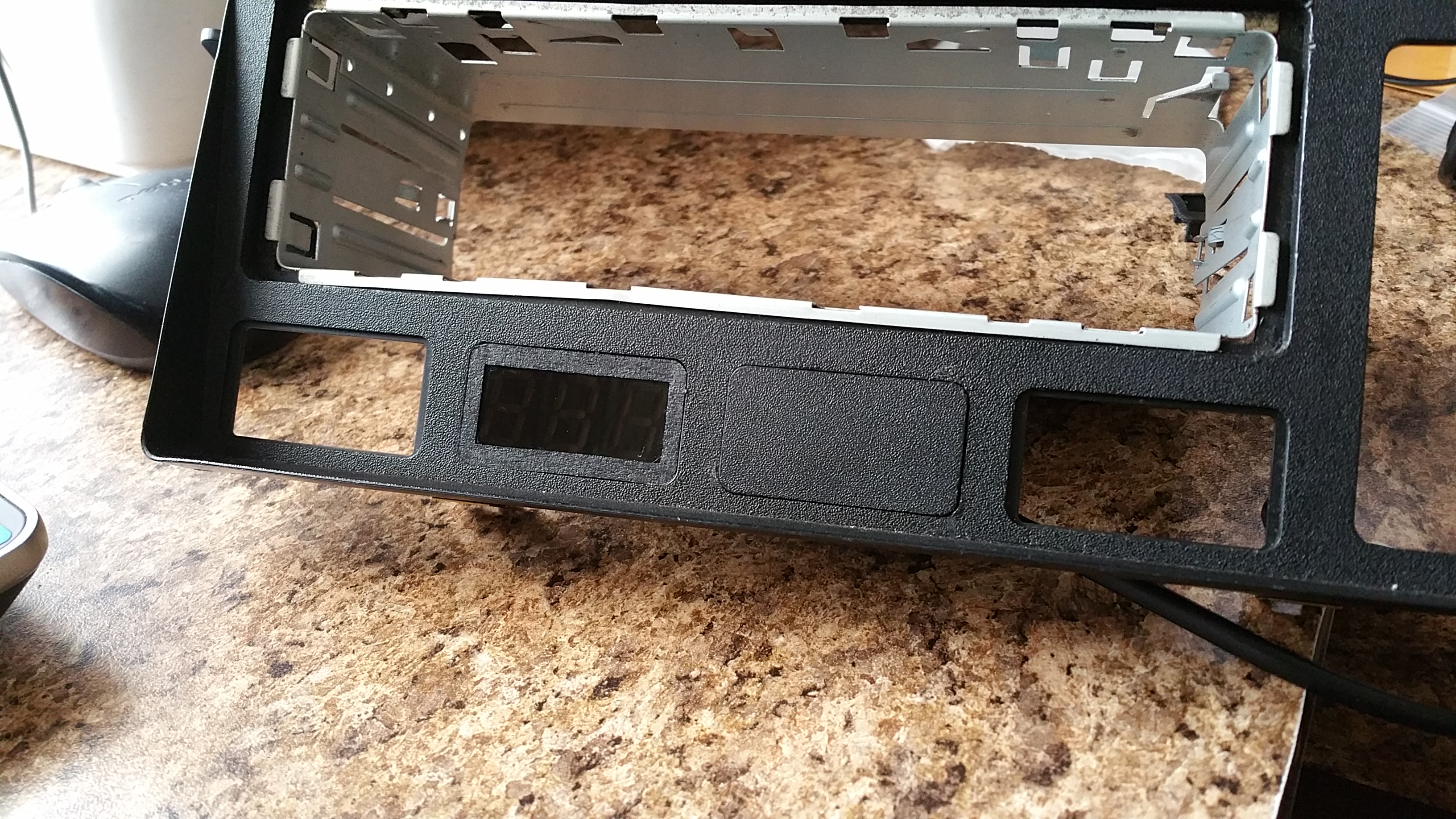

A few more pictures of the wideband display for documentation purposes, and also a few pictures of BMWs from last weekend because why not.
(The toys are all out!)
Re: Chris' BMW Projects

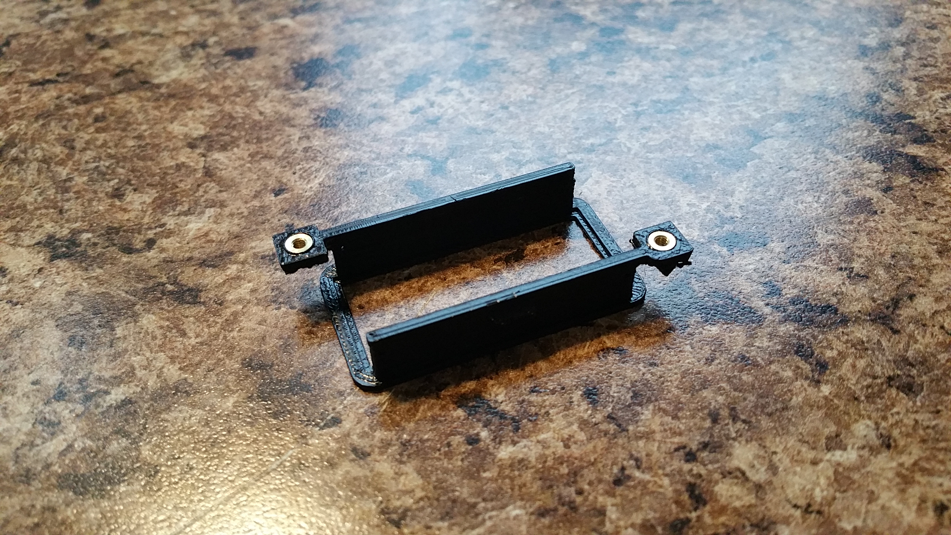

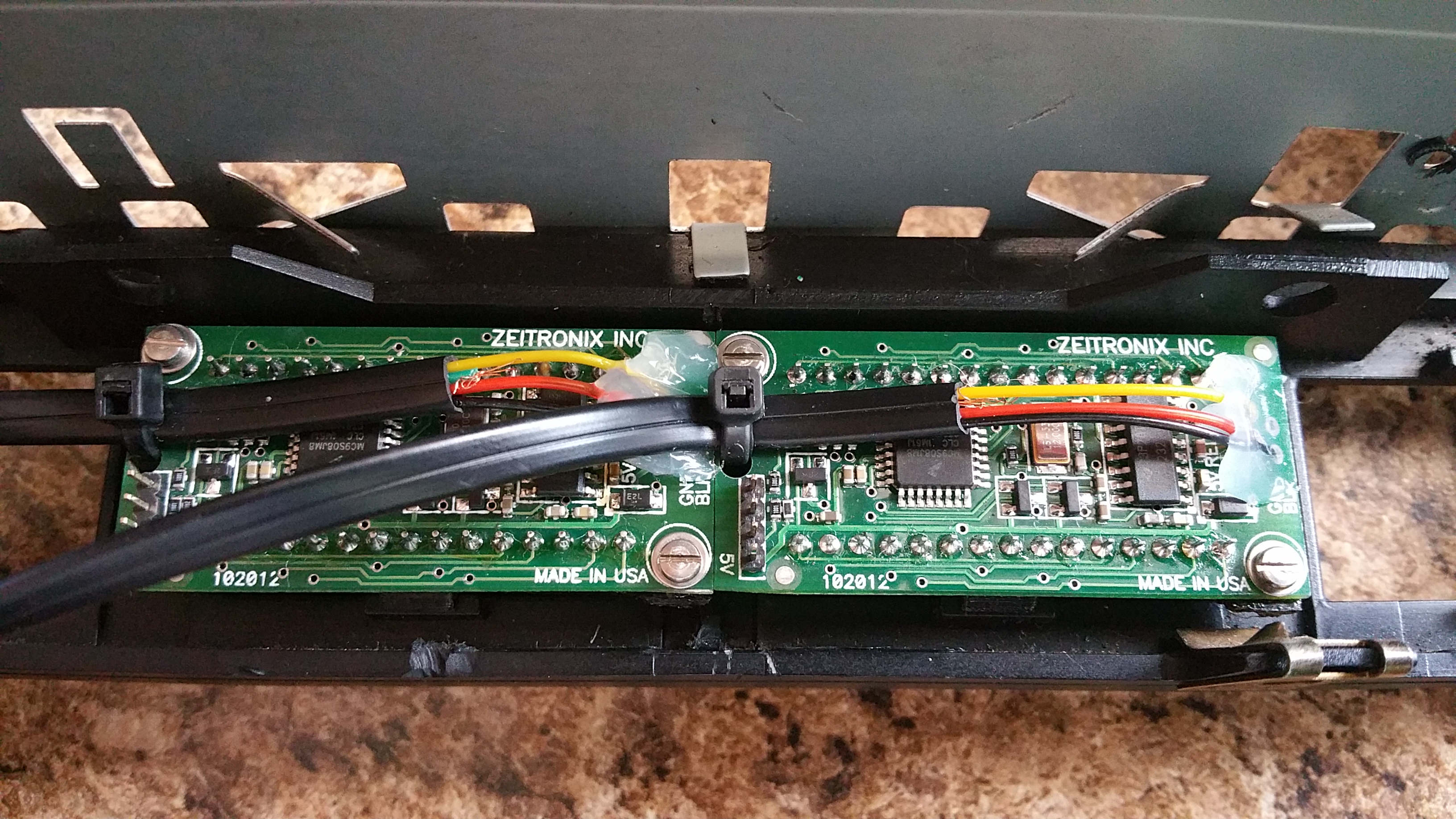

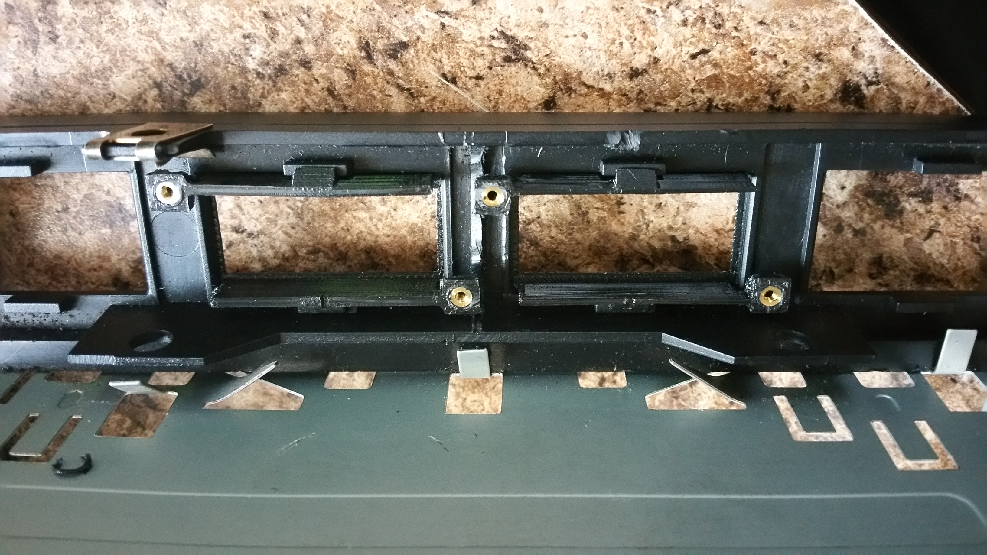

Just wanted to show the finished product of my zeitronix wideband panel blanks for 80s and 90s BMWs. I'm not sure exactly which cars has panels like this in them, but I know they work with e30s and e24s at least which probably means they work in e28s and early 7 series as well. Maybe there are others too.
I was compromising in some areas before, but now I've got a design that I really like and don't feel needs any changes. The panel itself mounts in the dash with two clips. Then the display mounts to the panel blank with screws and brass inserts. When the number display is inserted into the panel, it makes the panel impossible to remove providing for very secure mounting.
Mounting is flush and with fitment comparable to the stock panel blanks. The finish is textured. It isn't exactly the same as stock texture, but it is as close as I can get with this method of manufacturing currently and at the price I can produce them for and it still looks pretty good. It is only noticeably different in how it reflects light at certain angles of incidence. The blank panel next to it is OEM.
Posts: 2144
Is that for the hacker display? Very cool
Yep! If you have an idea for somewhere you want to put one of those let me know and I can probably help you out with a design and make some for you.

Here are a few more pictures
Failures lol
