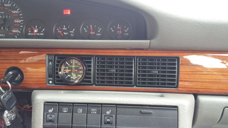

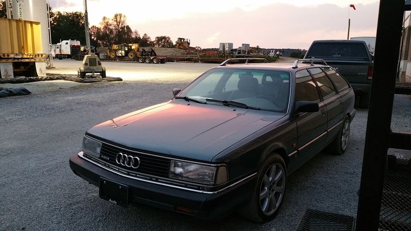

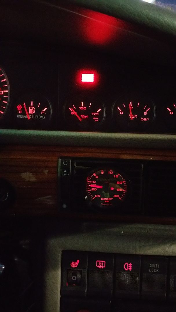

I drove the car for about 50 miles last night in the hills of Ohio and both the cruise control and air conditioning seem to be behaving. I think I mentioned that vacuum line I fixed. I didn't think it would really be the issue, but I guess it was! Hopefully it isn't just the slightly cooler weather or something stupid like that. At one point I thought it wasn't working properly, but I just had the temperature turned up because it was blowing so cold. Sweeeeeeet
The boost gauge is fully installed now with lights and all. I wired it's switched power (for lighting only) to the back of the fog light switch (gray and blue wire for future reference... that is the fog light switch's lighting power wire). I'm happy to report that the gauge matches the stock gauges and switches very well in terms of light output and color! The positioning isn't too bad either compared with the stock gauge locations.
dusk
night

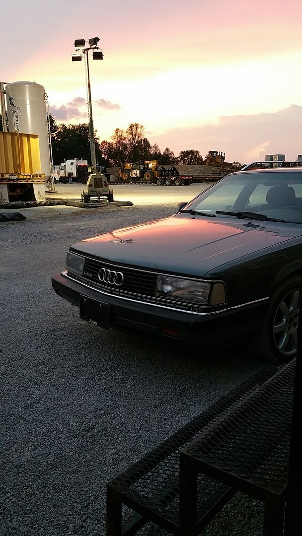

Here are some cell phone pictures I took at the rig the other evening. Not bad right? Too bad my personal laptop is down because of another fried charger. No PS to touch them up a bit.
