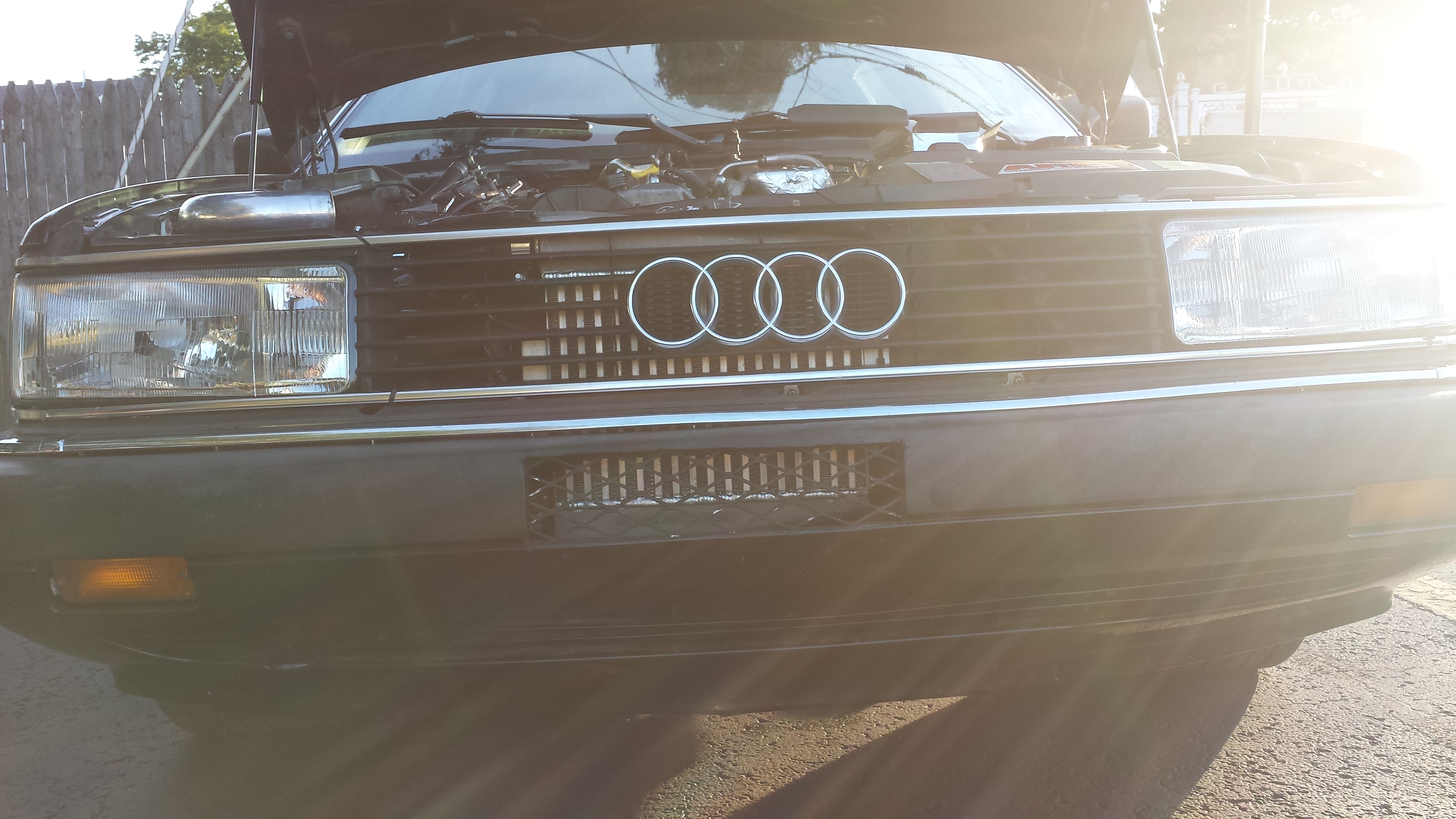

And now for a quick photo carpet bombing
That's the IC with a flat black painted grill to keep birds out.
This keeps people either away, or in today's case, tailgating and harassing-ly following me at an incredibly unsafe distance at 50 mph.
