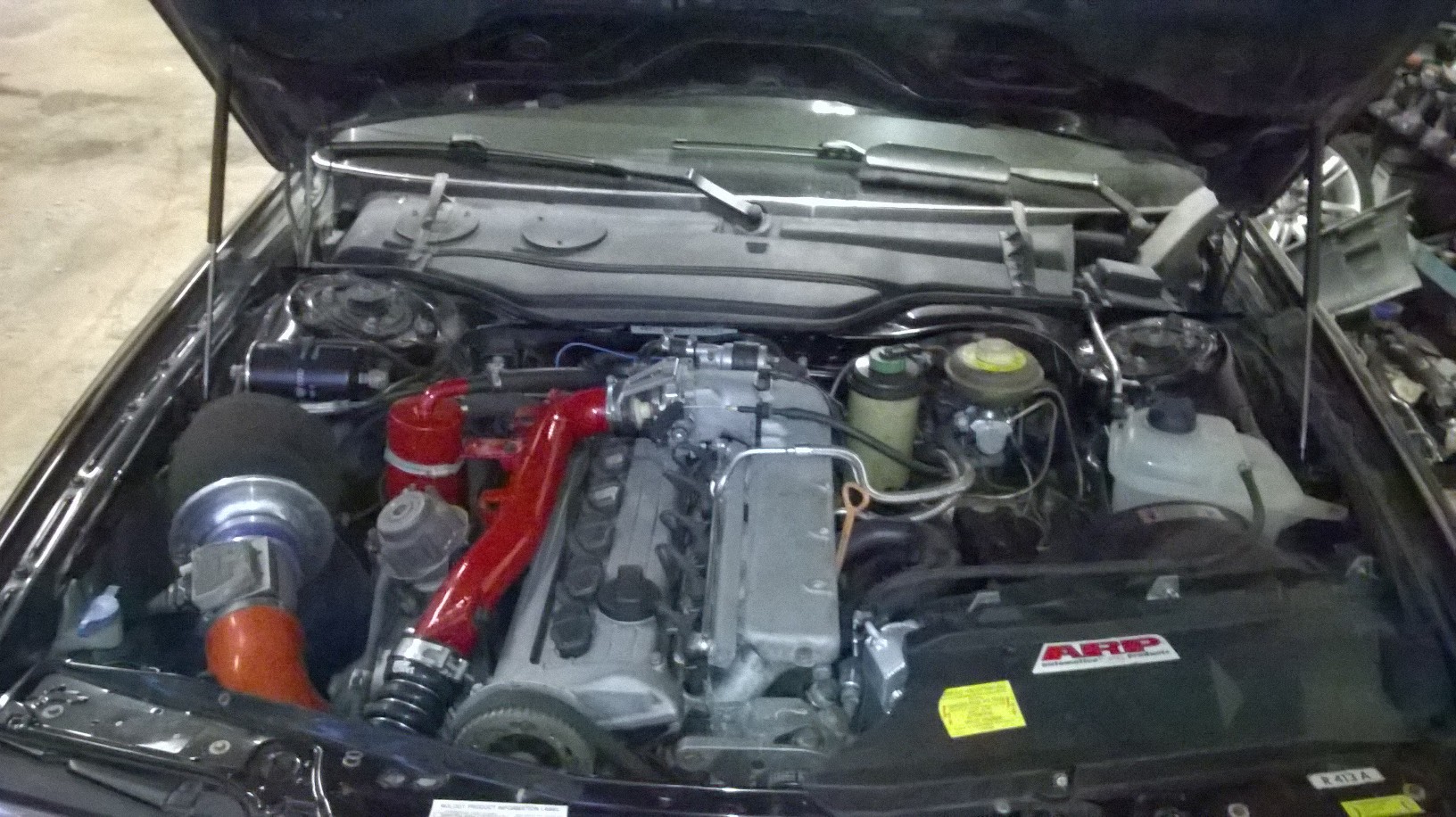

Things have moved on a bit again.
Still need to fix some issues in instrument cluster and assemble the front, but the engine bay is done at least for a while. :)
Got the new full aluminum radiator from ebay:
China made, but seems ok and bolted on just fine.
Had to plug the aux.rad. fittings thought since don't have it.
Repaired the washer fluid reservoir cracks and bought new pump, changed the a/c compressor since the one on the car was busted from day 1 and got a new fuel filter too.
Also painted some bits in engine bay, huge mistake. :roll:
Painting failed miserably, but I'll have to keep the hood closed from now on. :rofl:
Decided not to change the radiator hoses yet after all, 'cause cheapscate. :foff:
This will bite me back at some point I'm sure, but we'll see.

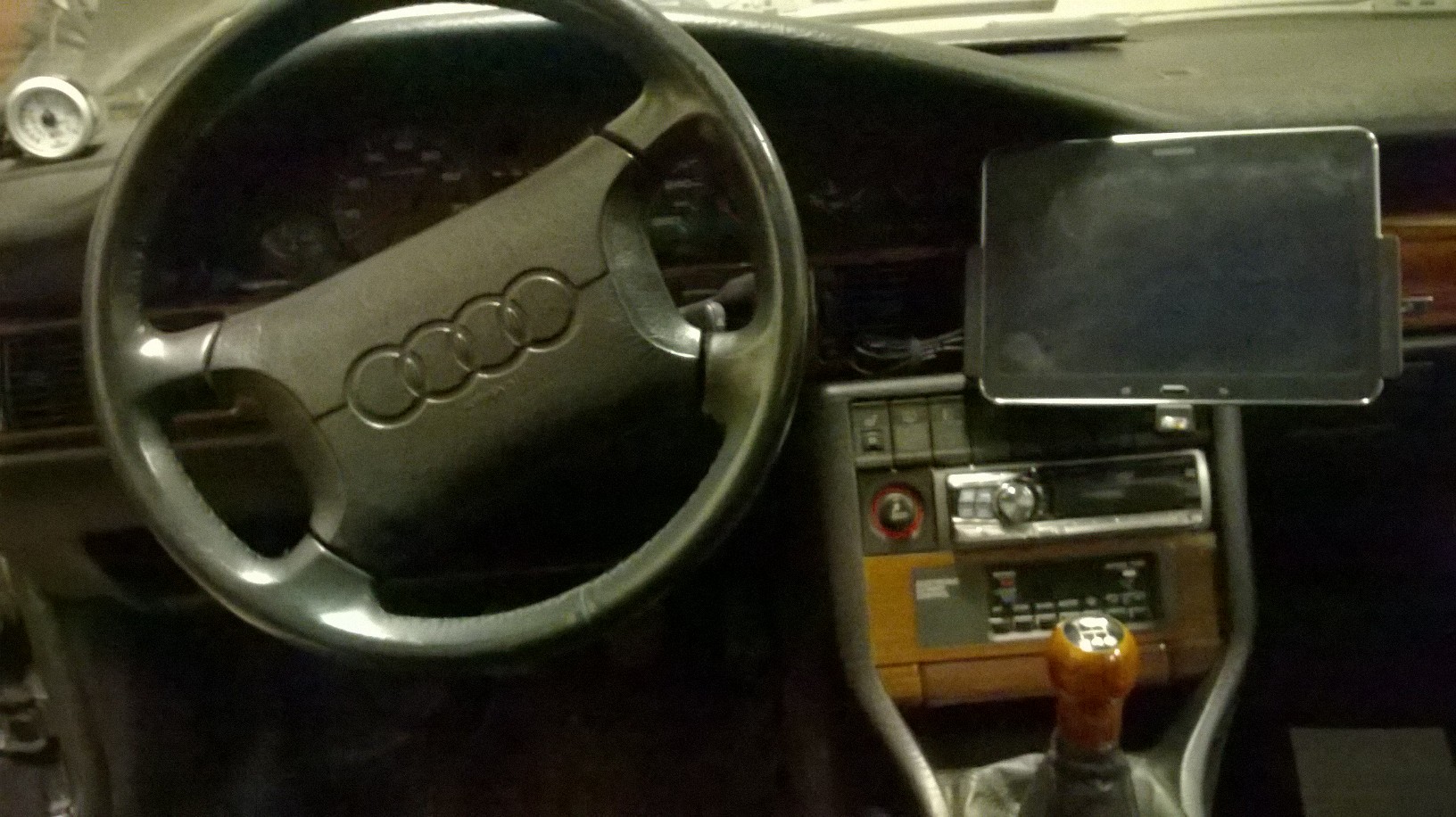

On a side note, I also got a tab mounted in the car with brodit holder as well as finished tampering with the instrument cluster.. 10 inch tab is a bit overkill. :lol:
Got this as vems display but the plans to get the pnp vems seem to go further and further...
That granpa steering wheel gotta go also at some point. Need to find something more fresh with an airbag.

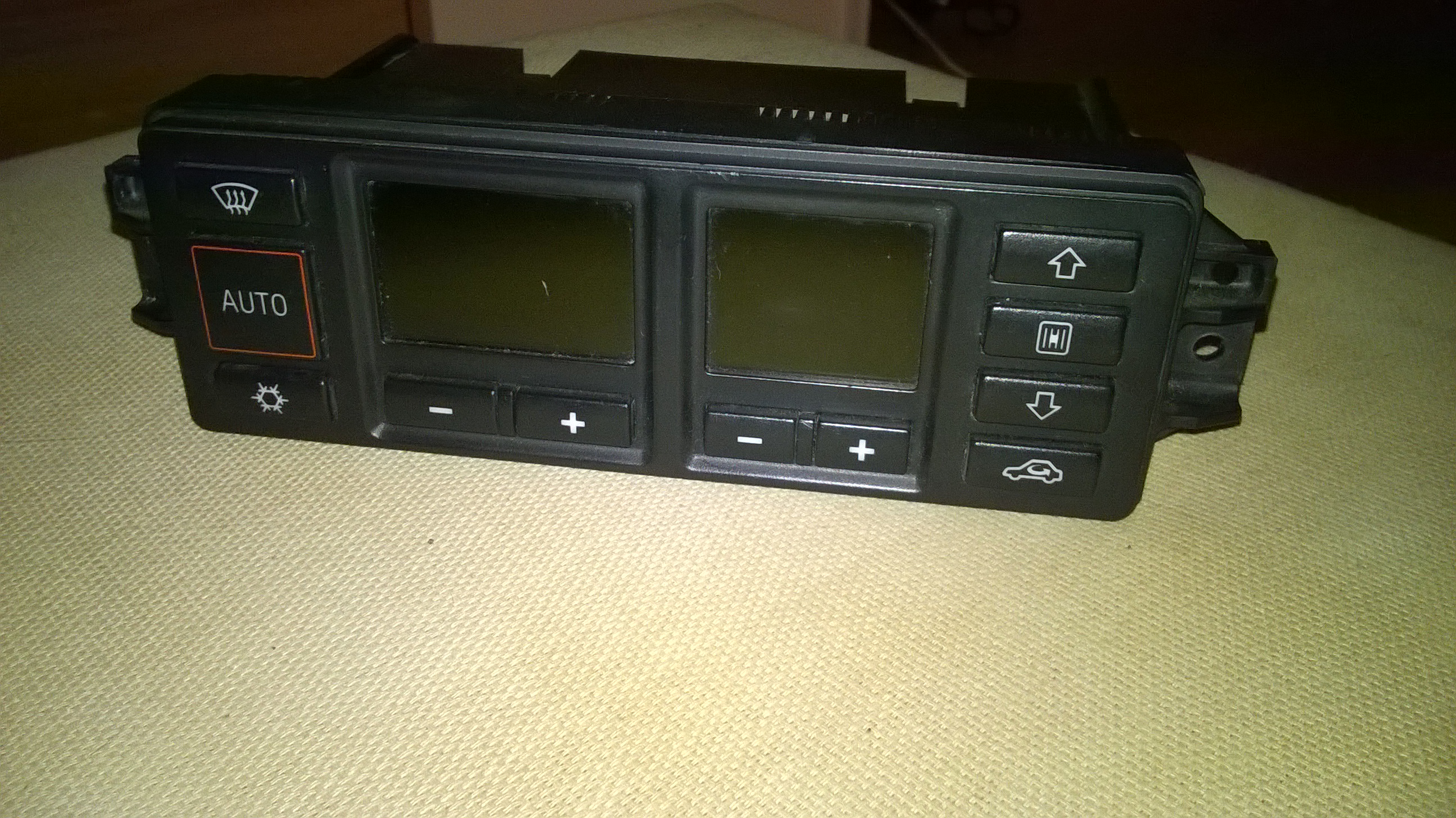

Also got this:
ilmastoinnin näyttö.jpg (1.56 MiB) Viewed 57059 times
A fellow audiclubfinland member sold it for pack of cigarettes. :D :thumbsup:

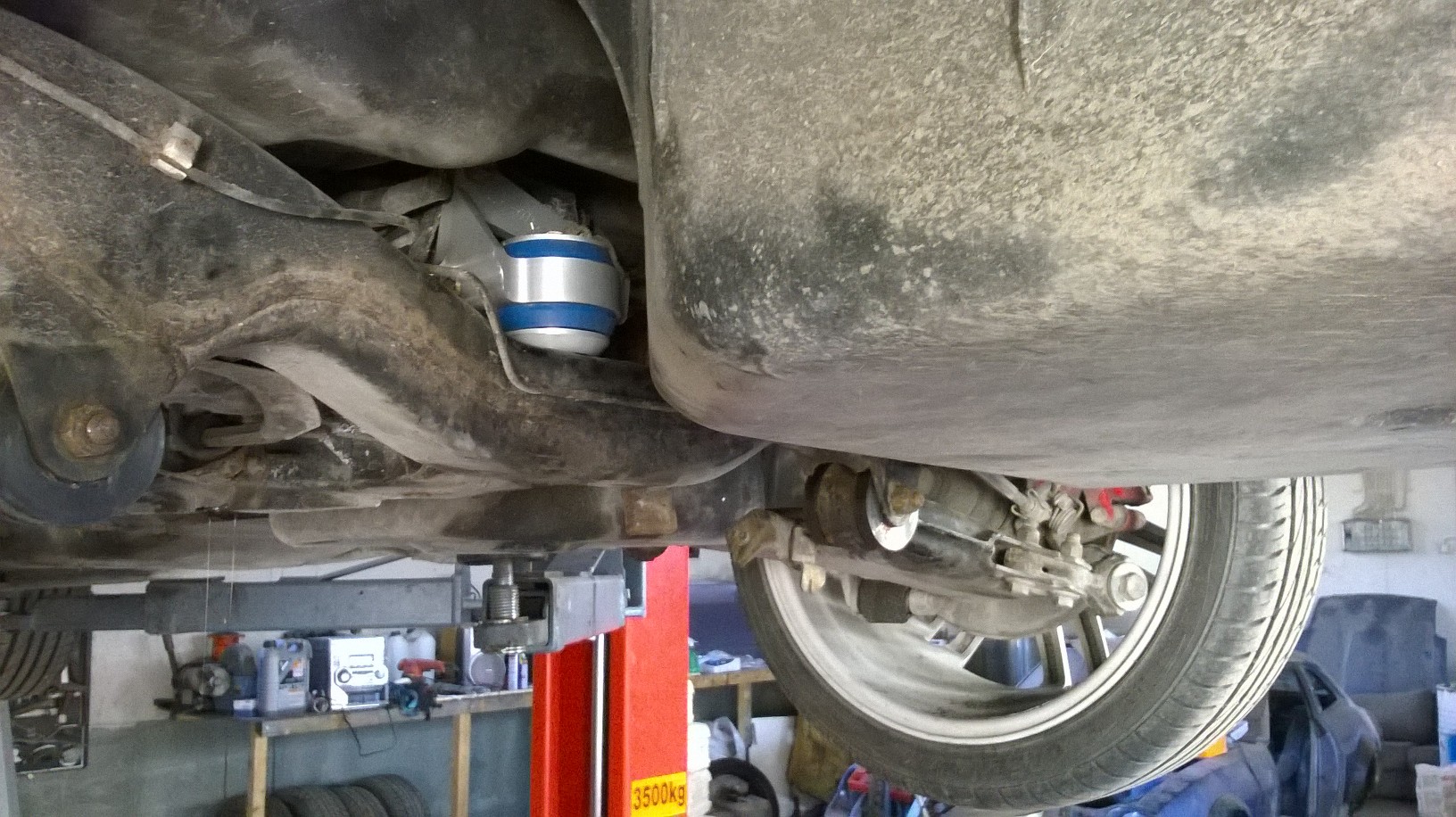

After I (and a friend who did the most work.. :P ) did the bushings for the rear xmember and all the bushes holding the rear diff, the bang that previously could be heard and felt going on and off gas was gone. 8-)
One pic also from the bushing work, the apikol rear diff mount is pretty sweet.
