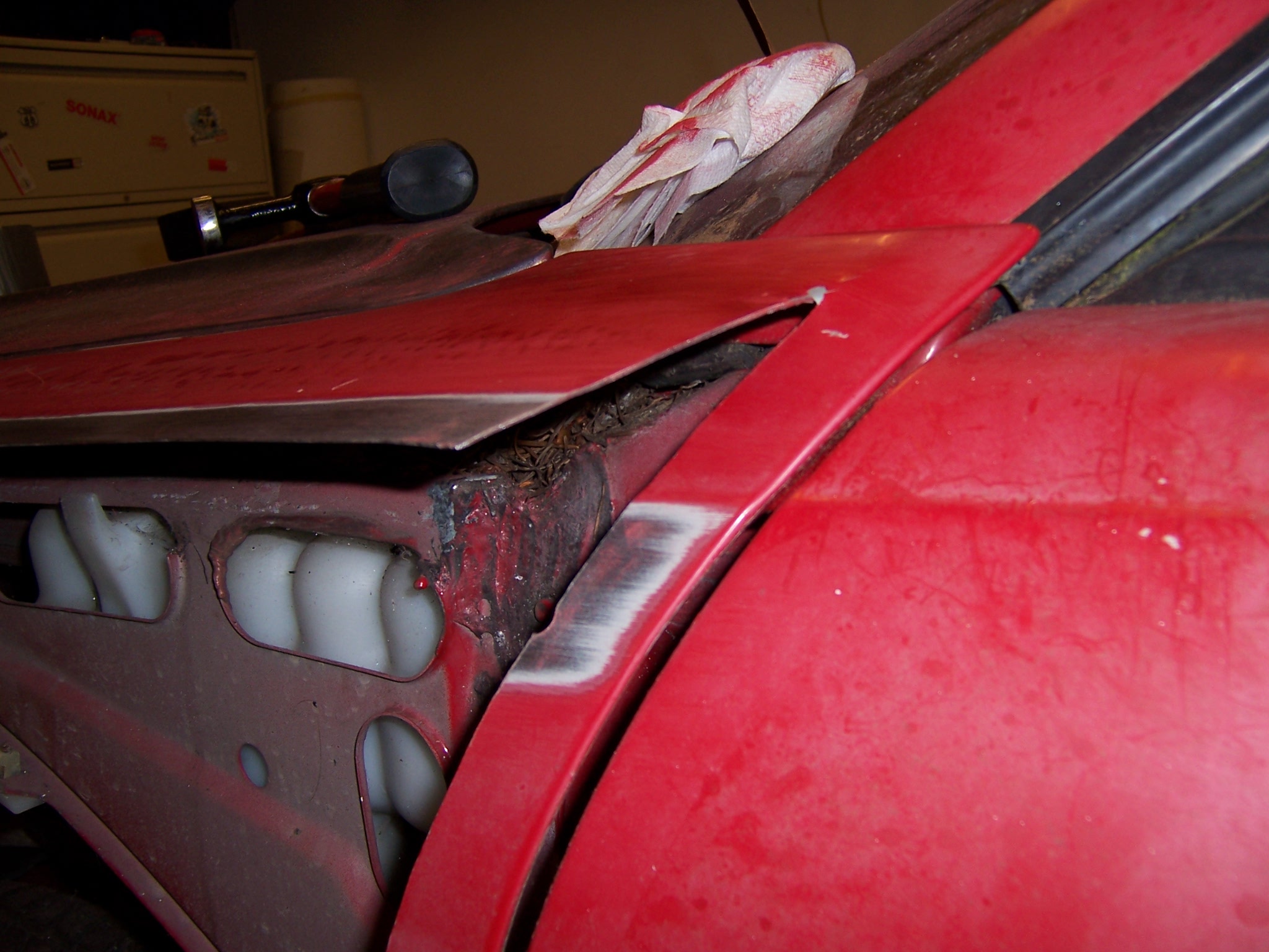

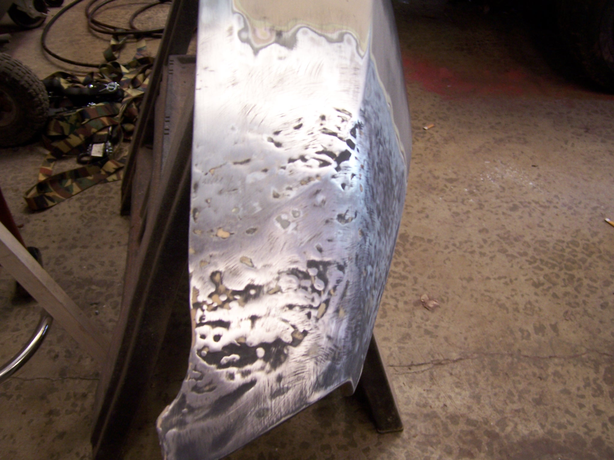

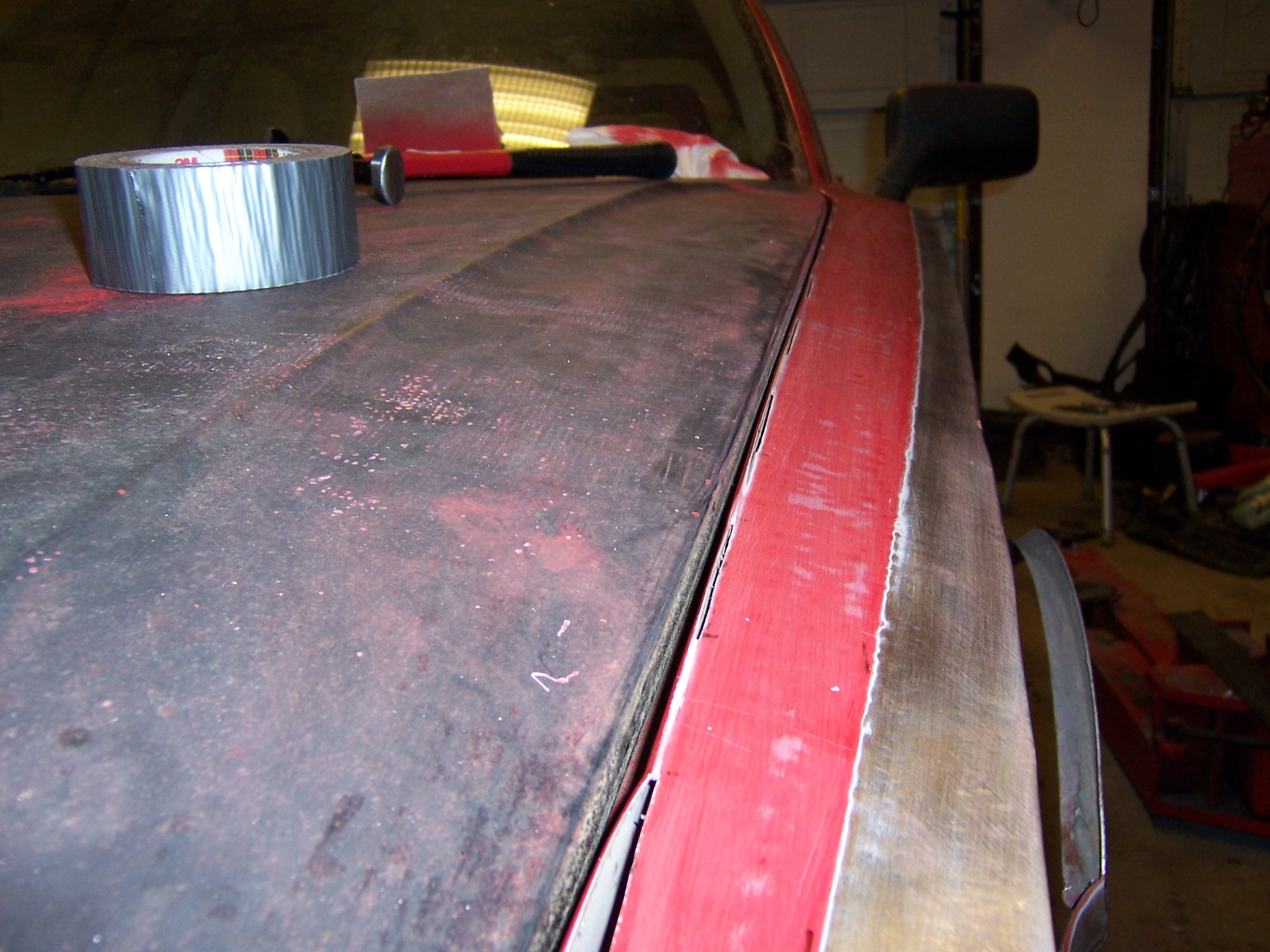

So lining the fender up ala Urq or Sport did not lock right (again with my eyeballs ,other people may see it different). This would have been
the easy way since i would not have to section the fender. Moving the fender up locked way cool but with that came more work. The top
curve of the porsche fender has more of a curve than the audi fender so i brocke its back to make it fit. Also the audi metal needet to come
up in order to keep a good hood to fenderline. Let me state at this point that before i cut int the car i alined all the body panels and fixed
what needed fixing bodywise.
Hammerd straight and pulled up , was not playing well so i made some relieve cut and it started to be nice.

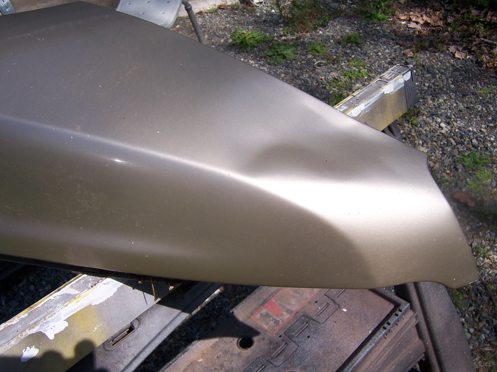

Fixing dent in porsche fender revealed a previous fix.

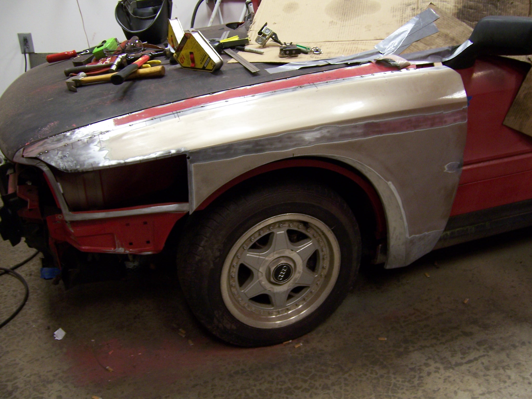

Fender on!!!!!
- audi wide build 020.jpg (524.49 KiB) Viewed 76815 times
Just found the limit on attachments , Now i know for future posts but that also means you guys do not get to see the fender from the
rear view of the car till next post . The opening it created instantly grew on me I LOVE IT.
