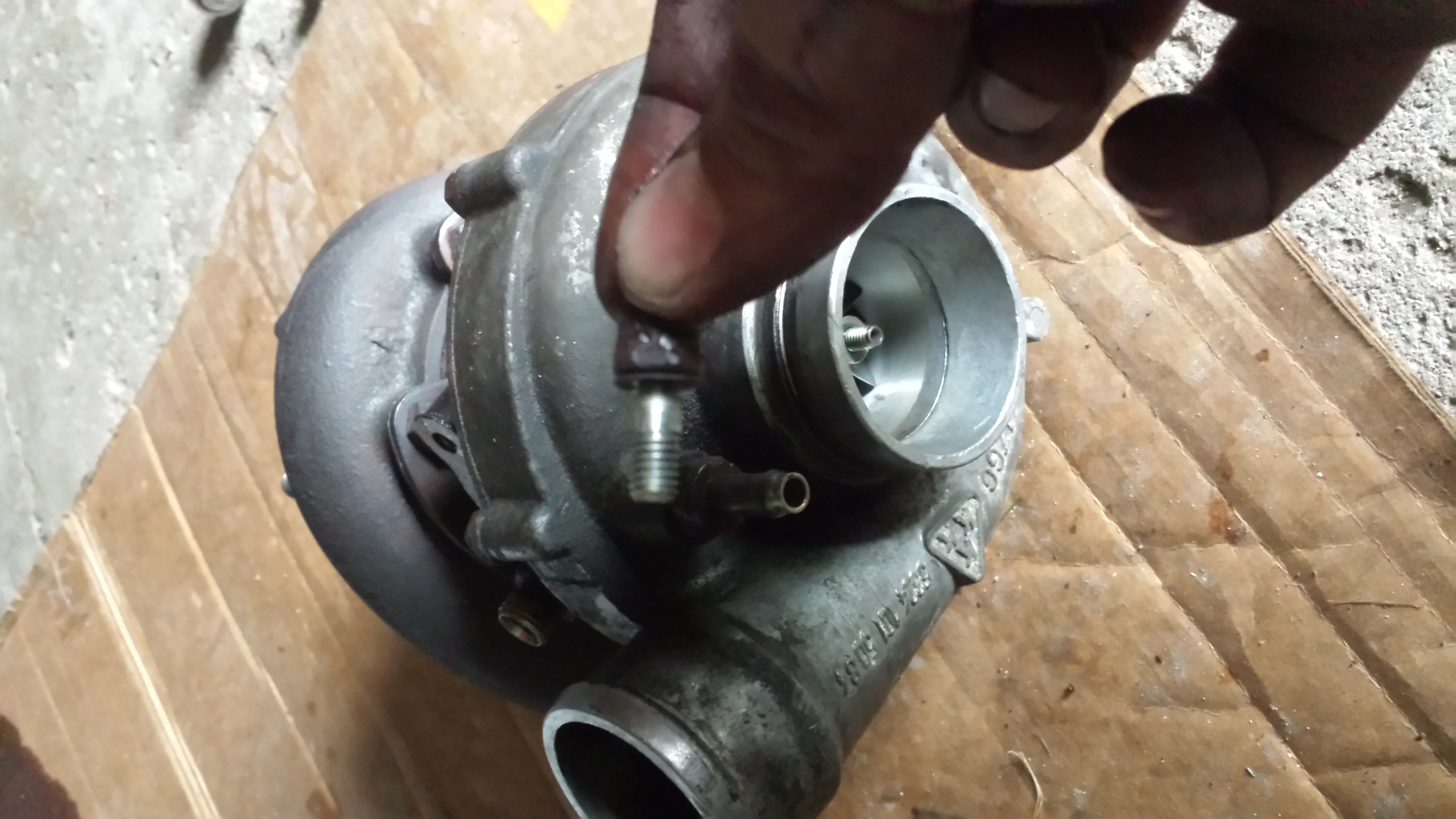

Ready to roll on this. Got the baby k24 out early and sourced updated nuts and bolts for the rust crap in there.
I think I'm seeing a threaded hole on the turbonetics housing. I'm assuming it would show pressure instead of vacuum. I grabbed the k24's in hopes that the threads do in fact exist and are identical.
- 20150529_180023.jpg (1.87 MiB) Viewed 29570 times
It'll show pressure and vacuum unless I'm not imagining what you're talking about properly.
The port is the reference port for the N75 same as the one on the OEM turbo. Just swap the fitting to the hybrid, and hook it up as normal.
Oh interesting. Well the ports reside in different areas of the compressor housing. On the k26 it doesn't exist. On the 24, it's on the smaller portion of the snail shape lol. On the turbonetics housing it is on the straight section of the housing where the IC clamps to it. I'm having a hard time imagining what sort of pressure it will see under ALL cobditions. Looks important for internally gated turbos from turbonetics which it goes directly to the diaphragm thingy of the gate.
Oh very nice. That's cool that the threads will work. I may hack up the cobra head for stock hose ports or I'll run my catch can to atmosphere *GASP* and the same for my BPV I suppose. At least until I figure it all out. Thanks again all
To take full advantage of the new turbo, you really need to upgrade the intake system. Stock size intake is around 2", this uses a 2.75" inlet. Using a 2" intake will seriously restrict the performance of the turbo. That actually why I had the 3" cobra head for it, plan was to run 3" intake pipeing to keep it from staring the turbo or air.
That's perfect since my k&n is 3" ID. I believe I can make this all work
When the turbo isn't turboing88a5tq wrote:I'm having a hard time imagining what sort of pressure it will see under ALL cobditions.
Yeesh all my schoolgirl giddiness made me forget the one rule that engines are in vacuum during idle (as well as the restriction tidbit). Haha thanks chris. That's a very good explanation in deed. You've brought me back to reality. The time is near to installation!

Here's a little info I remember from a while back about the reference port on the comp housing. I'm not entirely certain but I think even at idle there is no vacuum at that port.
I skimmed that but I will read it in etirety at some point. Looks very interesting. Thank you for posting it up

Hmm yes, if the port is at the base of the housing that could cause some differences. I hadn't even considered that. That makes for some good thinking! I was more referring to a tap near compressor outlet.Goldenquattro wrote:http://www.motorgeek.com/viewtopic.php?p=5727
