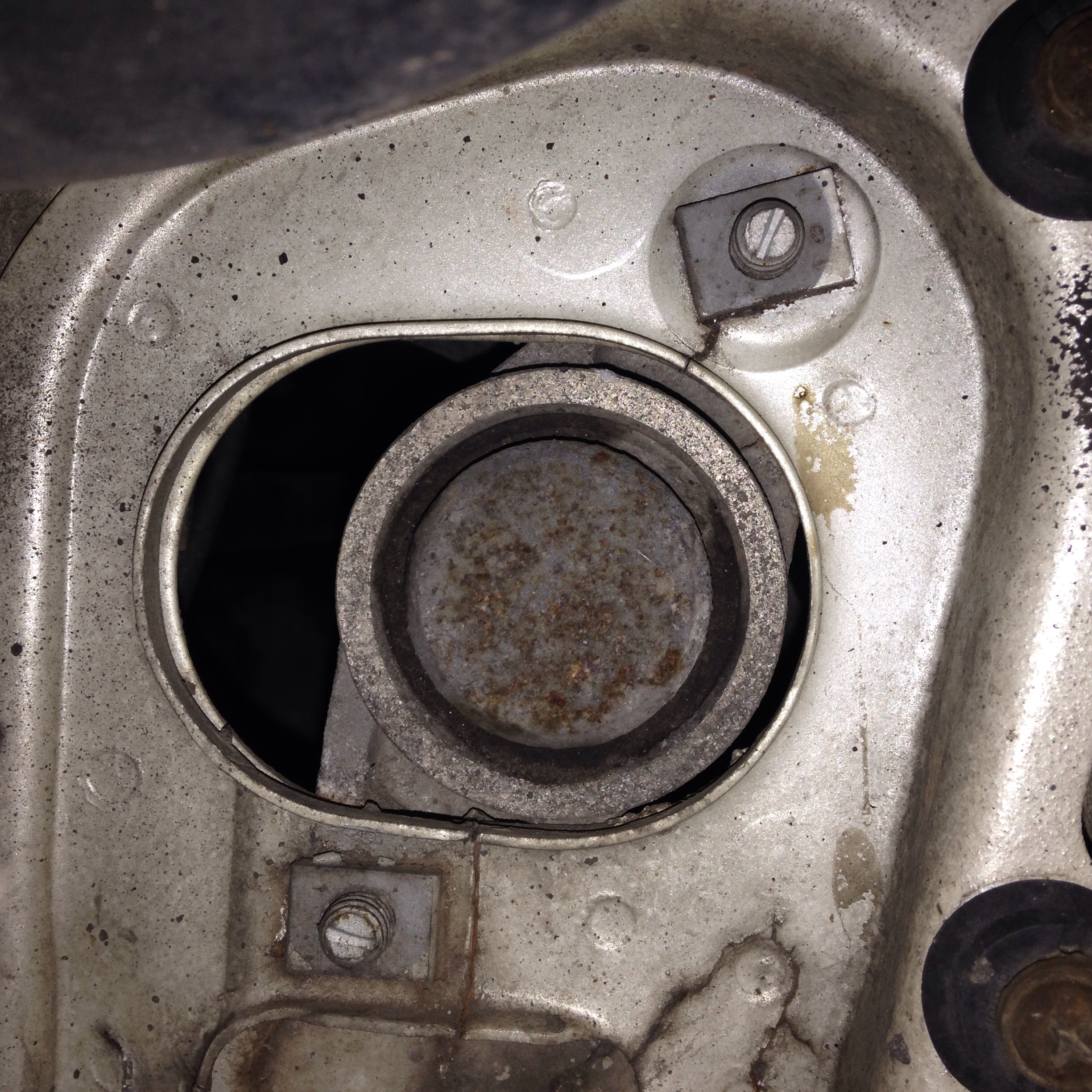

First and foremost, my biggest concern about the car is that I've apparantly discovered the dreaded steering rack mount crack as pictured. If anyone could point me in the right direction I would greatly appreciate it as I can't seem the locate the thread the s2 guy created detailing his fix. My idea on this was to just have it taken care of whenever the engine comes out since I do no welding myself. Other than that it's mostly bad mounts, seals, gaskets, and misc electrical things inop.

I've been working for BMW for a few years now, lol. This is my first obd1 project I've ever taken on, let alone being an old Audi so I expect to have a good learning curve. Ive owned a few vws and daily a mk4 gli. Otherwise, previous cars have been a 338whp wrx and a bolt on s2000 that I plan on selling at some point to help fund the s6 as the build progresses.

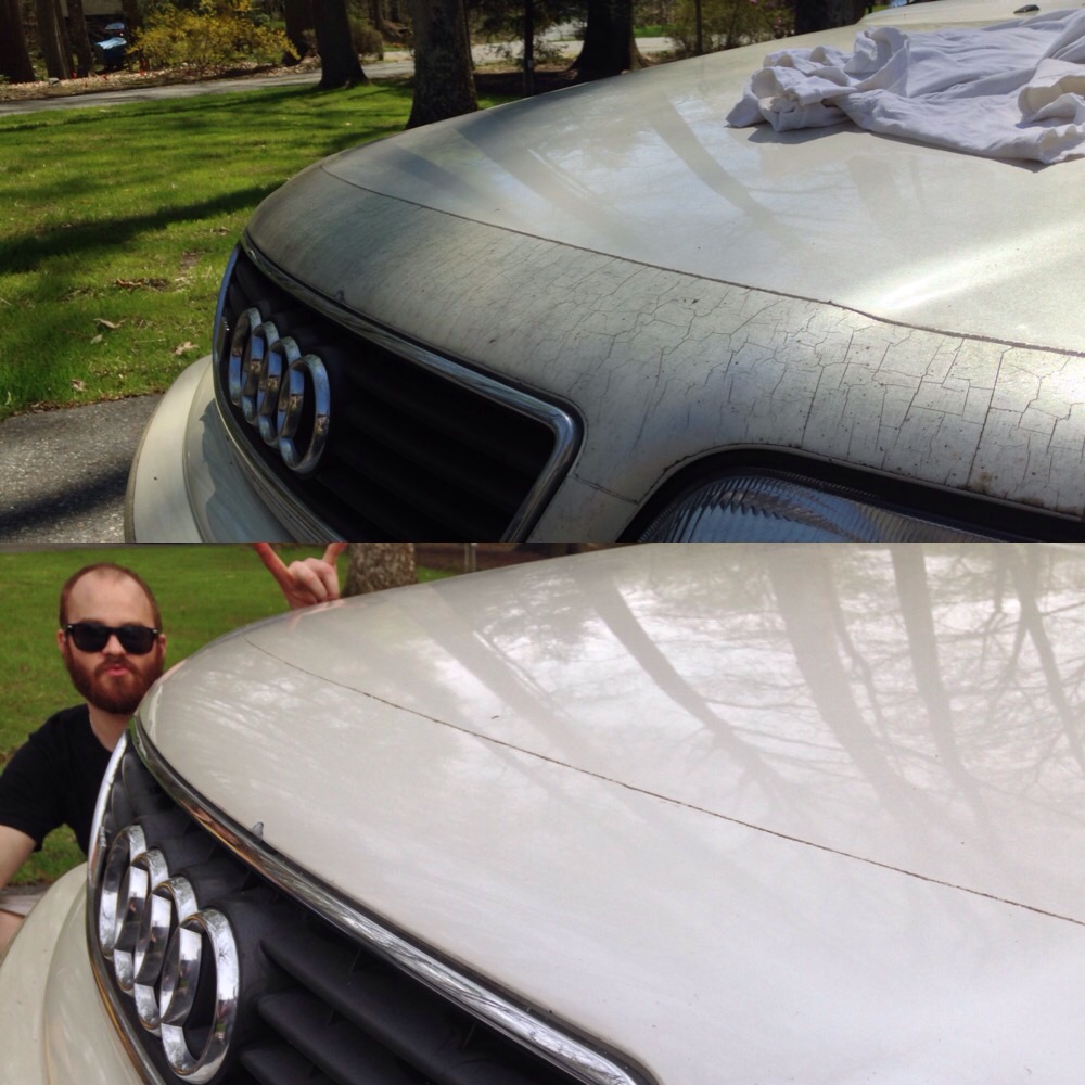

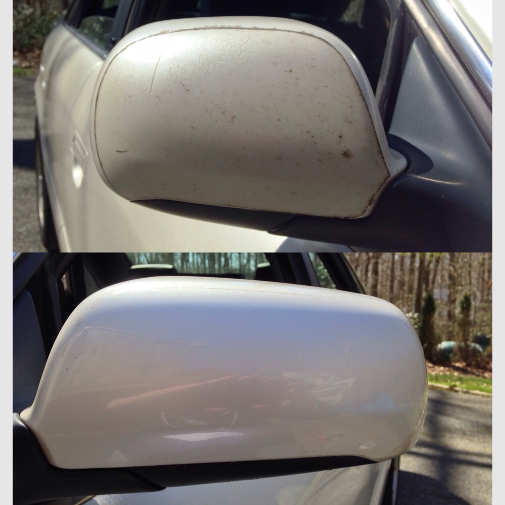

Some pics from this last weekend taking the clearbra off

My buddy thinks he's the shit for suggesting goof off which btw works wonders more than goo gone.

Glad you found your way here, there is a factory repair part for the rack mount. It is somewhere on Quattroworld. I'd save your monies for an EFR setup and an 07K swap if you really want to get serious. Where are you located?

I wasn't planning on reapplying the clear bra, they for whatever reason didn't cover the trim under the headlights or the headlight washer covers so they're chipped to hell and for the amount of struggle it has been taking it off. I never want to do it again. I have roughly 12 hours total time in it and I still have the entire front bumper to go so I'm guessing I'll have over 20 in it by the time it's done.

I had no idea there was a factory repair kit for the rack mount so I will definitely jump on that while I'm taking care of all the other crap. Hopefully when I get back from training next week I'll start ordering the maint items and various mounts that have gone bad.

Here's the clearbra completely off. I ended up using a snap-on pneumatic eraser in the end because the adhesive was kicking my ass and I was about to go jump off a cliff.
