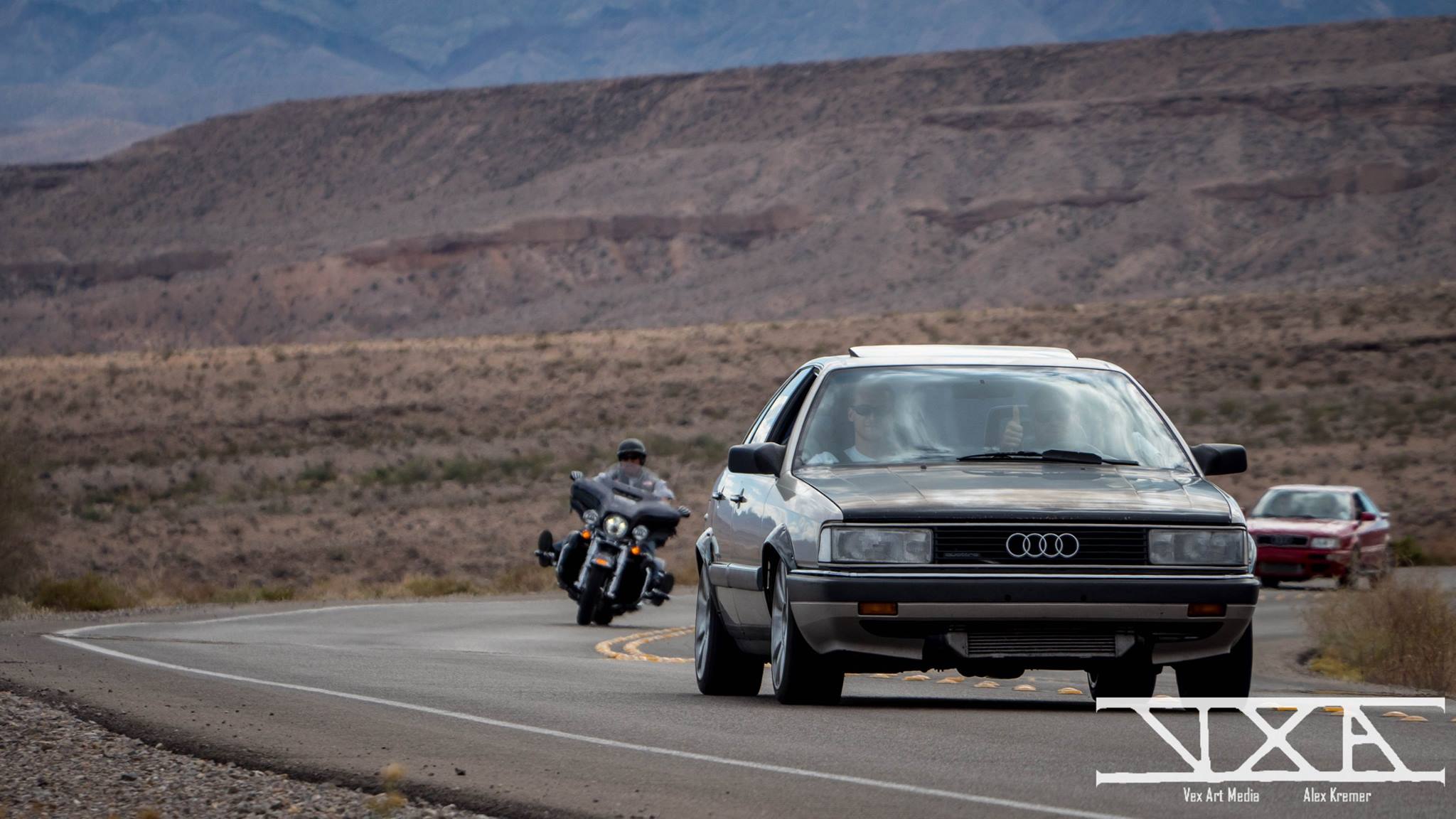

Re: Phil's 20vt 5ktq, Donuts are delicious.
BBQ 2015 was pretty fun.
Alex takes good pictures.
TurdQuat needs bumpers.
First couple minutes into vegas on Friday and the driver side doors got backed into by a 2500 Duramax Chevy. Still waiting on a check from the lady...
Looks way better with those flares compared to how I saw it last.
Thing is fixin to be real sexy with a rear bumper.
