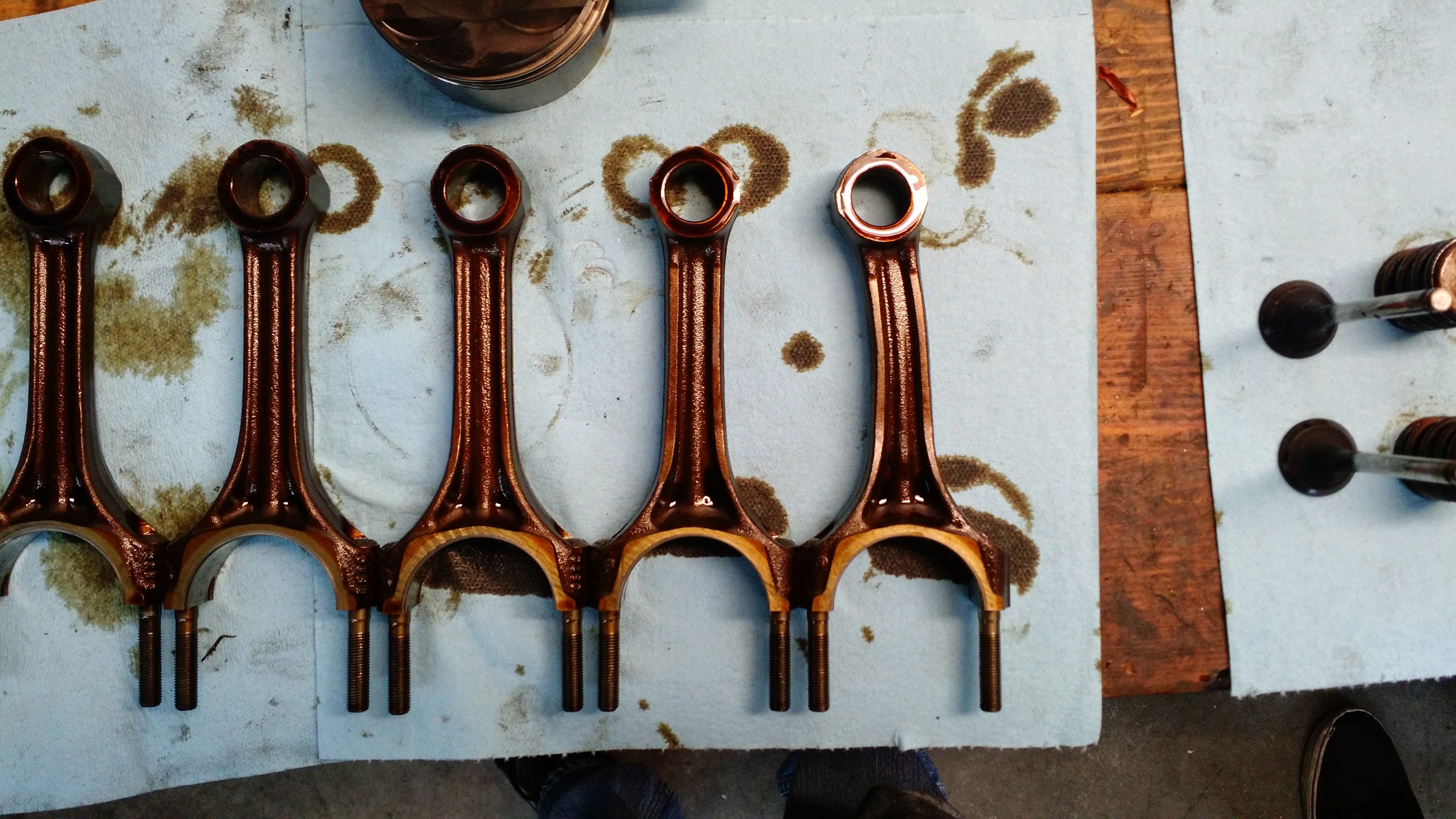

So, some things have been happening.
- IMG_20150201_160650273.jpg (2.19 MiB) Viewed 46258 times
Re: Phil's 20vt 5ktq, Get Bent
"One of these is not like the others"

So. Found a bent rod, found where the gasket blew up, got the steering rack swapped out, found a decimated pilot bearing, rebuilt the head with new Valve seals. Among not shop things, the mule DESTROYED a 335i, had some delish food, Got some fun rides in a quick car, saw some bad-ass projects, and had some fun times with Colin and friends.
Not a bad weekend overall.

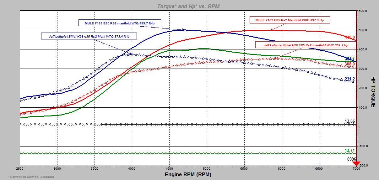

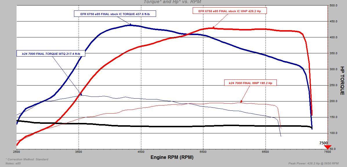

Mule on 6758
and currently mule on 7163

That is hilarious. Hank is going to have to get a new dyno that reads below 2k at the rate this is going.

I should mention, during the destruction of the 335i Colin left it in 5th and just stomped on it and STILL managed to decimate the poor guy. The spool on these things is crazy, and the powerband is fantastic. Neck is a bit sore from the pulls.

Stock ic too. Corn is amazing
Both those pulls were on the stock IC, He managed to fit a bigger FMIC in there recently, albeit a not very good one.

Definitely made a lot of progress this weekend on Phil's car! Could have gotten more done probably but Phil wasn't down here that long and birthday celebrations and hangovers put a dent in motivation. Plan at the moment is a 6758 on the 5K. I've got almost all the parts to start putting it back together, just need to do it! And swap new trans and diff in aswell but that's a one day ordeal.
Dyno numbers were stock IC, The Mule has an FMIC now. (That is probably much too small, but way mo' better than stock)
Destroying the 335I was hilarious. He came up on me at 100+, I was going about 75, he went for the pass and by the time he was half a car length ahead I pulled him like a freight train to ~140. I think The Mule should just be renamed the giggle mobile, because that's what I do every time I drive it...

Those graphs are awesome. So the 6758 spools like a k24 and the 7163 spools very similarly to an rs2. I would really love to see some pump 93 dyno pulls.
Spools nearly the same, transient response is (far) superior on the EFR. Especially the 6758.
