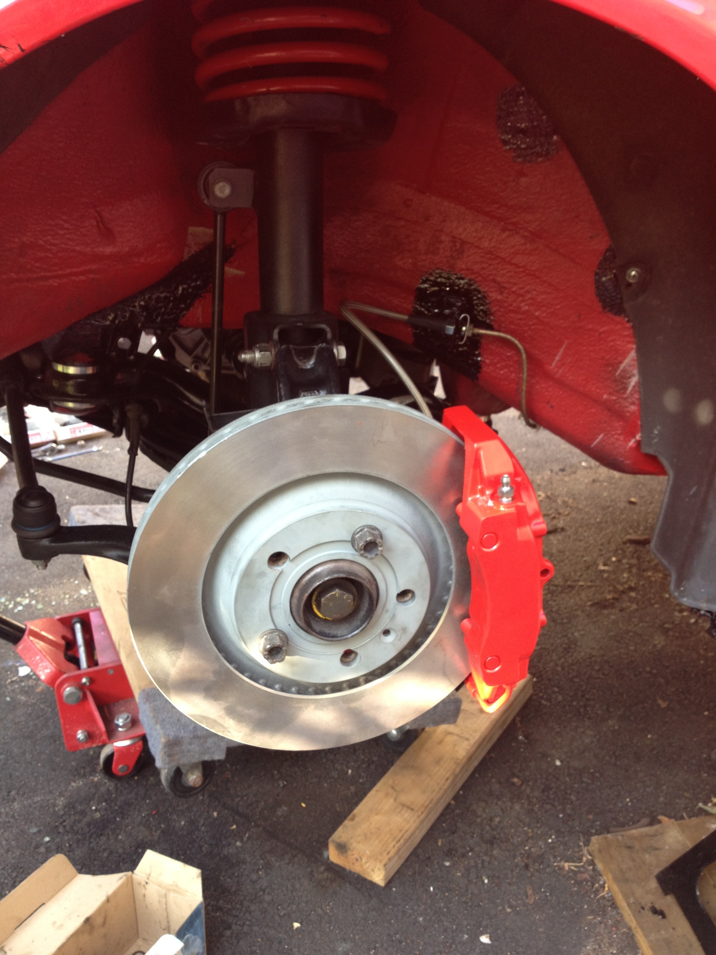

as the title says I'm looking for some wisdom in regards to spring rate for DIY Coil over setup.
I know that Aaron's setup was 650/900lb rate for 4 cyl motor in the coupe for drag purpose.
Please let me know your opinion on the spring rate for daily driving using bilsteins HD shocks. with 5 cyl motor. i dont mind stiffer ride.
my current setup is bilsteins HD shocks and H&R srpings which make the rear of the car very soft. im looking to get very little shock travel movement in the back since my wheels are very close to the edge of the fender.
Best
Sebastian
Best
Sebastian
- Sebastian's CQ91' rear brakes done 1.jpg (2 MiB) Viewed 21299 times
- Sebastian -
