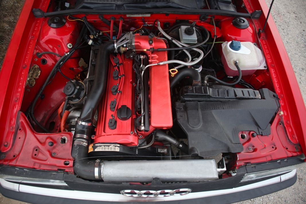

Had a great fall drive on Sunday, we have some awesome roads up here. I organized a little G2G and drive for our local(ish) Audi club.
Real camera engine bay shot:
As per the attached image, you can see that I moved the catch can closer to the block (it's under the stainless braided fuel lines). Bad idea. I definitely have way more oil shooting out there. So I got all concerned and did a compression test, 160+ across the board, #4 and #5 were slightly higher at 162ish and 165ish. The gauge was pretty inaccurate. I didn't have the throttle open, didn't think about that at the time. Anyway, I'm happy enough with those compression numbers and I'm sure it's just that there is a ton of pressure down in the CC and it's pushing oil up into the catch can, especially around corners. I've said this many times before.
Anyway, I need to change this setup. I just posted in Casey's thread and I'm thinking of doing something along those lines. I'd like 2 vents on the valve cover and the block vent to go up into the valve cover as well.
