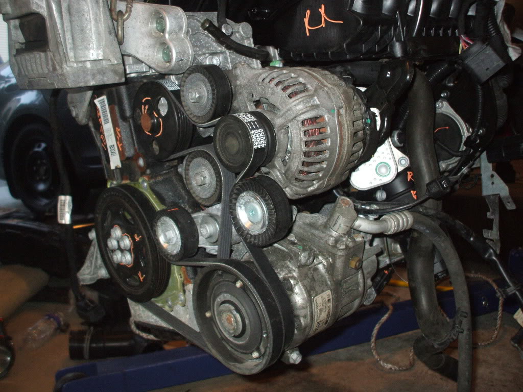

Okay so here's my next dumb question...
I made an inquiry about an engine that's available locally out of an '09 Jetta. They said that car does not have a p/s pump on the engine, it's electric.
Is that true of all years, or just the later engines? Is there a clever way of retrofitting a p/s pump to an engine that originally came without one?
Eric Law
Noisy Cricket
Posts: 225
Joined: Sun Mar 24, 2013 11:19 pm
Location: Cleveland, OH
Re: Basic 07K Facts?
Post by Noisy Cricket »
I don't think the accessory drive layout would allow for a power steering pump. Every 07K that I've seen in the wild has had electric steering, including '05.

Ah, I think I figured out what caused my confusion.
In this photo:
07K belt setup DSCF9921.jpg (157.16 KiB) Viewed 116211 times
...I thought the pulley in the upper left area was the PS pump. But maybe it's the water pump?
On a related note, how much do you guys suggest budgeting annually for replacement of serpentine tensioner/idler pulleys on these motors? ;)
Eric Law
Old, but all Beetles and some 11-12 Jettas had PS pumps up top. They make an intake manifold a chore though.
Posts: 2142
Yes, the most upper left pulley is the water pump.
