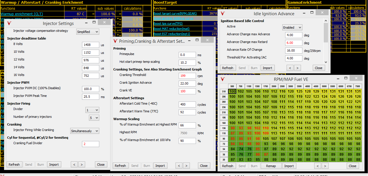

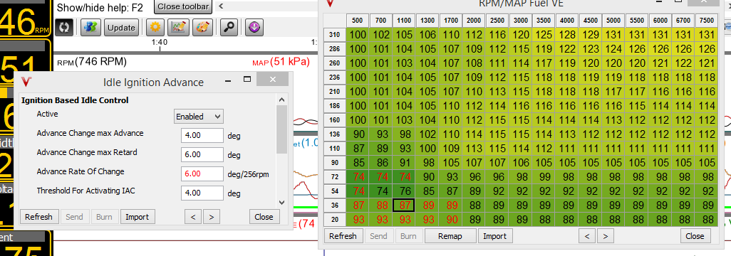

I set the MAT/TPS Table on the lower right cells a bit leaning out since i noticed the a/f become richer once the MAT ramp up.
i think i got all sorts of issue.my friend tried to remap and play around the VE table and set the ign adv rate of change from 16 to 6/256rpm.the injectors pulsewidth seems more steady than before.my Deka's PW is 2.0ms. too low?I have 5bar FPR,max
injector DC is 93% on 29psi of Boost.I will need to get bigger one for E85 soon.
Anyway,i heard some slightly knock when WOT at the top end around 6-7K RPM on E85.Too much advance on the top end?
my lambda target is 0.80.

Your entire timing map is very advanced. +6-10* higher than mine in almost every cell. I still highly doubt you got E85 to detonate at .80 lambda though.
Being 31-33* advanced at idle is probably also causing some of your idle issues. I'm around 20* there.

Re: Idle problem on Deka's 630cc.
No, that's pretty normal. 15-20* there on a stock AAN tune. If you use idle ignition advance that effects the actual advance at idle as well

i tried to give it more advance gradually from past and now we found the max advance on E85.I have some slightly detonation
on the top end let's say upper right of the table when WOT.i'm going to dial the ignition back at some point.
