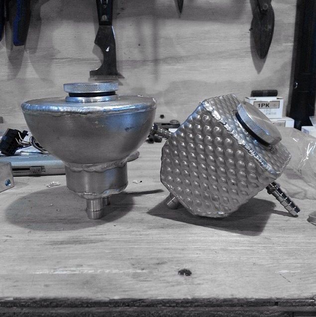

So. I want to make a custom aluminum brake fluid reservoir, just so I can powdercoat it :)
But, before I do that. I need to know if the cap needs to be vented somehow. There is a dude who makes custom reservoirs and when I asked him if he vented the caps he said no. But, I must ask the collective here regardless so I don't end up not having brakes at 140+.

We did. But those options are all killing the idea I'm shooting for here. As pictured above. There are plenty of caps available as pictured above. But I'm still up in the air if a vent is needed. Those I posted. Don't vent. And are on many cars. And they don't have issues. But they aren't drag cars. So I want to be sure here.

Good info. But. I now need something to weld onto the top of a can. That will accept that cap.
Or. I use the cap and threaded bung I have. And drill a wee hole in the cap and get a diaphragm underneath it.

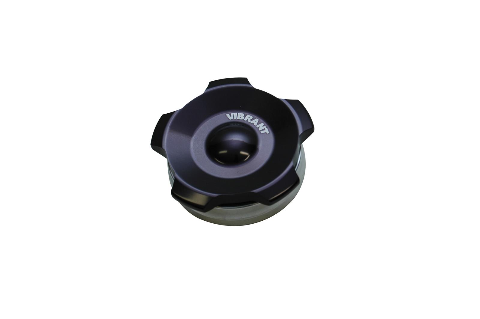

so now, you are looking for something like this: (this one is steel bung, aluminum cap)
Art Morrison rear end filler cap assembly.
https://www.artmorrison.com/rearends.php
EDIT: actually, something like this then.
http://www.summitracing.com/parts/mez-pn6550

That's precisely what I have. The vibrant piece.
