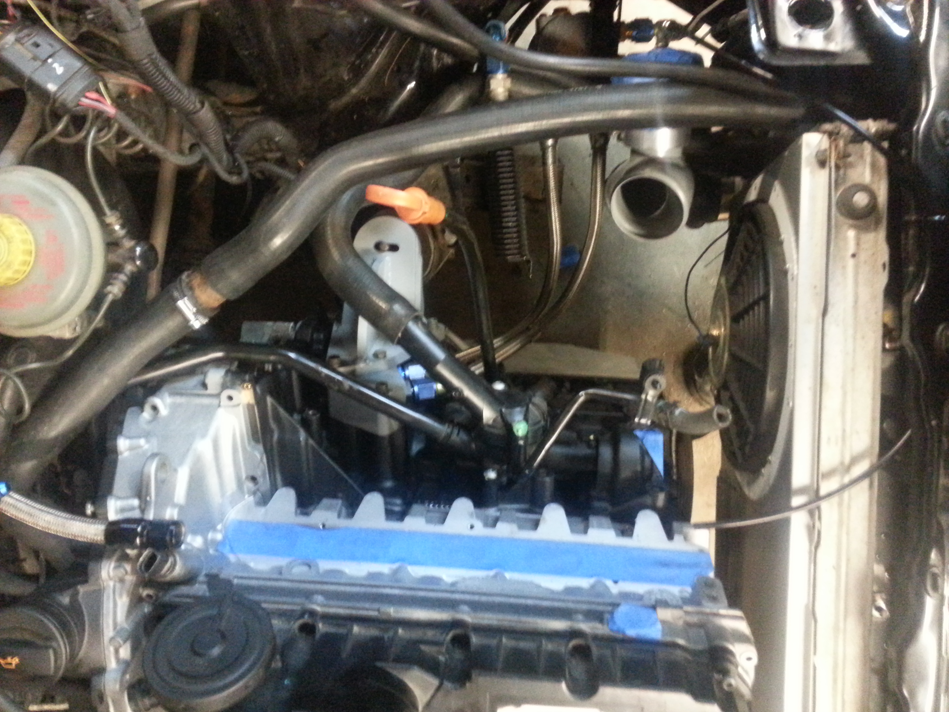

Not that it looks like it could go any higher, but is the turbo oil return above the oil level?
glibobbo21
- Posts: 659
Re: Jim's 07K 84 Super HX40 4kq 83mm engine building:-D
on the oil line return...debateable. It worked for 1.8t's all this time. Also you can fit a garden hose inside of mine. :-D
If the line starts getting backed up because it is below the pan level, it will naturally start to flow back into the pan as soon as the level in the line gets higher than it is in the pan. It is simple physics and fluid mechanics (assuming crank case pressure and oil drain line pressure are similar). Hydrostatic pressure will ensure that your drain works fine.glibobbo21 wrote:on the oil line return...debateable. It worked for 1.8t's all this time. Also you can fit a garden hose inside of mine. :-D
loxxrider wrote:If the line starts getting backed up because it is below the pan level, it will naturally start to flow back into the pan as soon as the level in the line gets higher than it is in the pan. It is simple physics and fluid mechanics (assuming crank case pressure and oil drain line pressure are similar). Hydrostatic pressure will ensure that your drain works fine.glibobbo21 wrote:on the oil line return...debateable. It worked for 1.8t's all this time. Also you can fit a garden hose inside of mine. :-D
I always thought this, but never knew how to say it like an engineer... haha.

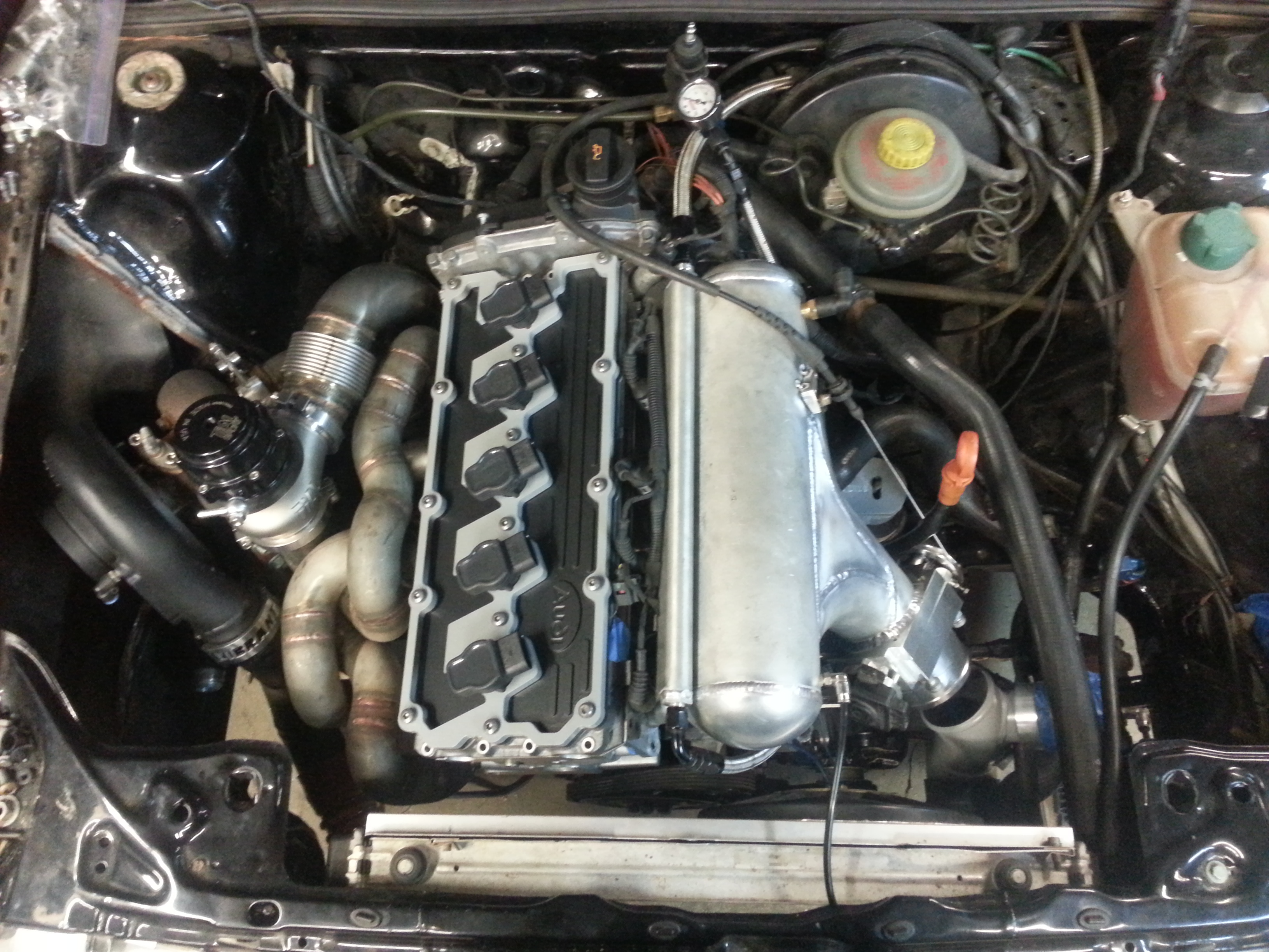

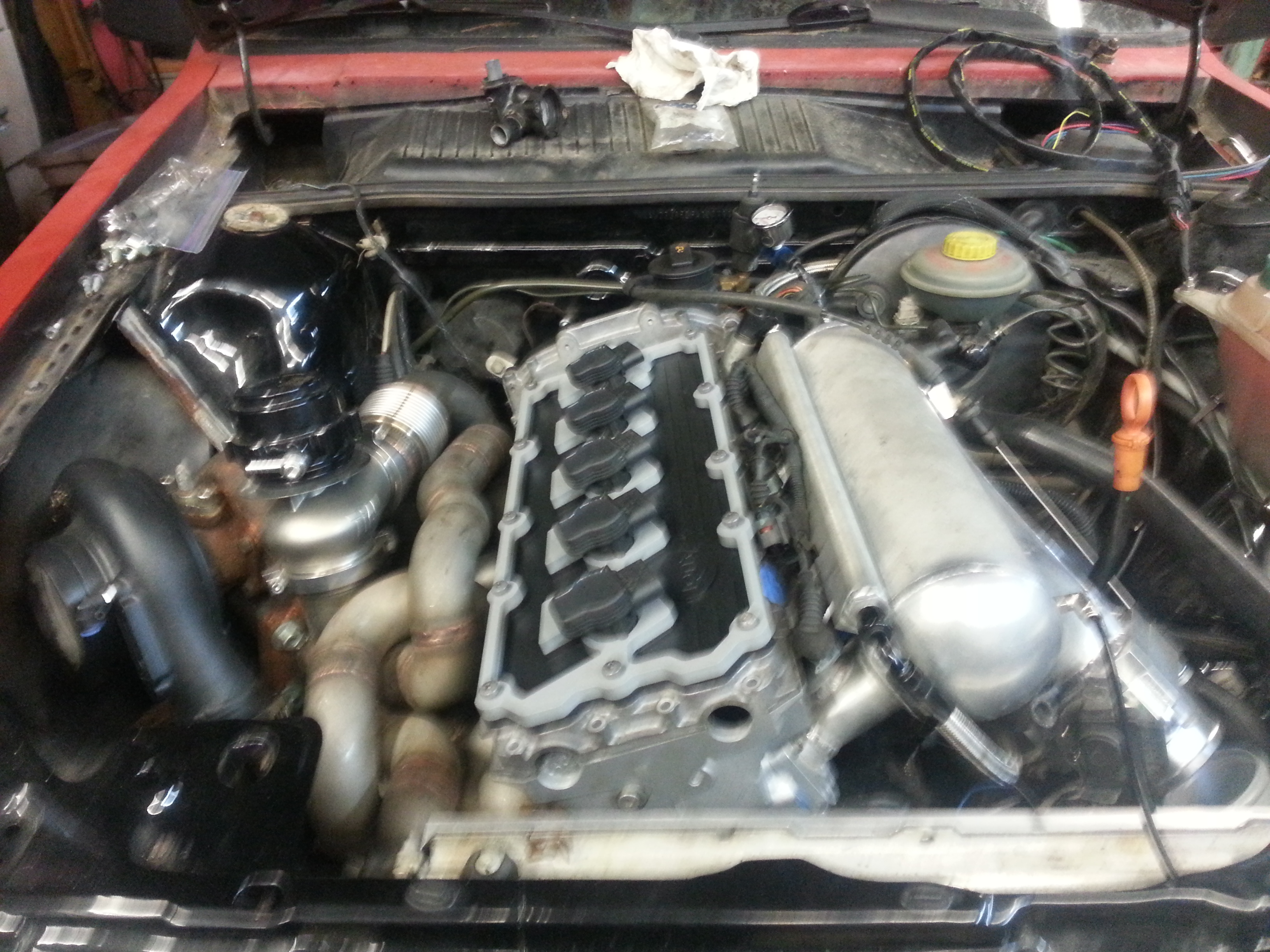

It may look close to done, but with my luck itll probably have to come back out next week. Haha
Not sure how i should coat the IM...
Match the IM to the VC and coat the fuel rail to look like the coil spacer.
