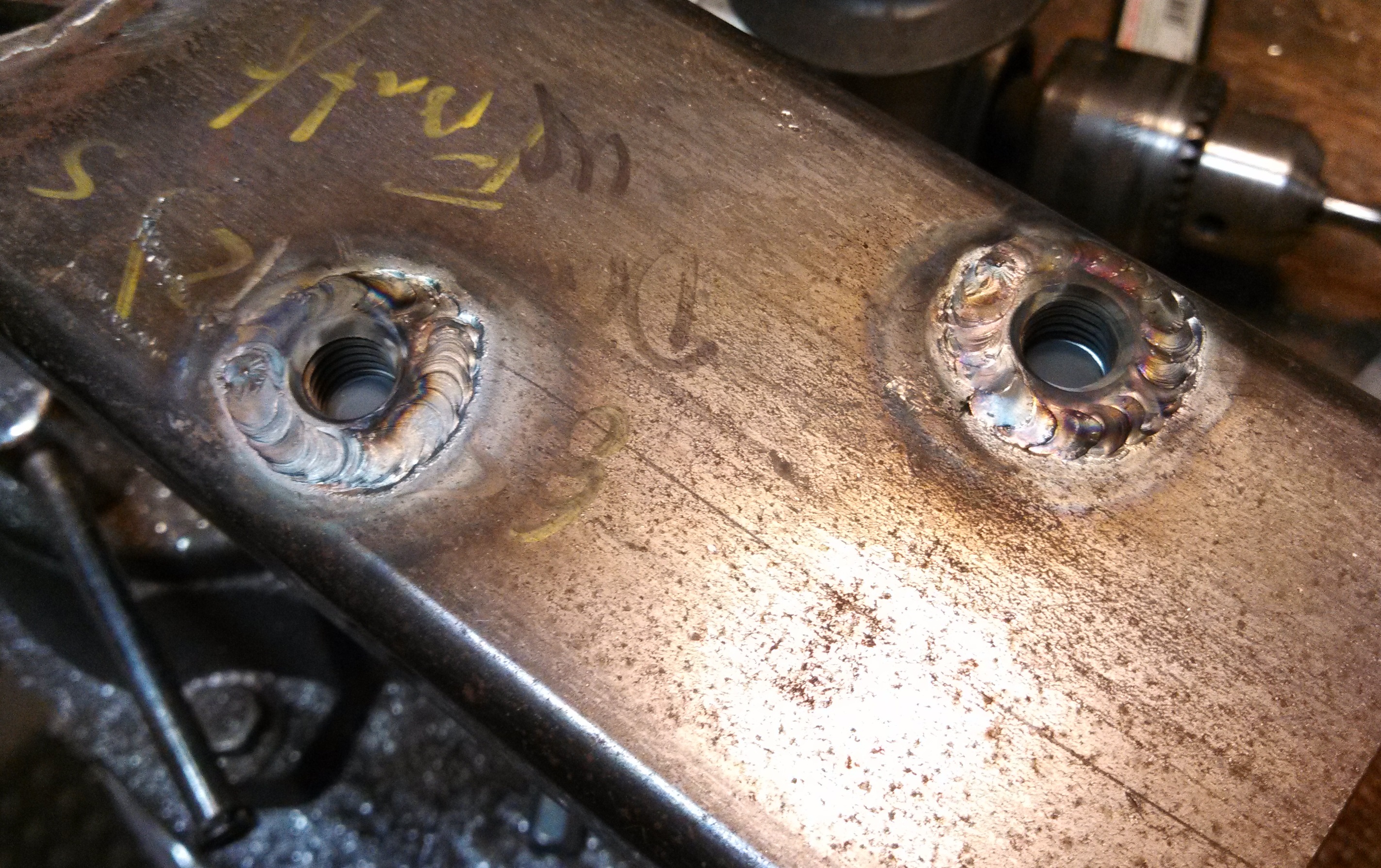

And here is the rear removable member again. Its attached via 2 m10’s. there is a m10 coupler nut welded in the 1x3” tube in compression. The mounting flange side is a 10.2mm hole for the coupler nut to butt up against and the backside is seam welded to the upper part of the 1x3” tube.
Pics!
rear sf removable member holes done.jpg (1.84 MiB) Viewed 45952 times
rear sf removable member holes done2.jpg (1.58 MiB) Viewed 45952 times

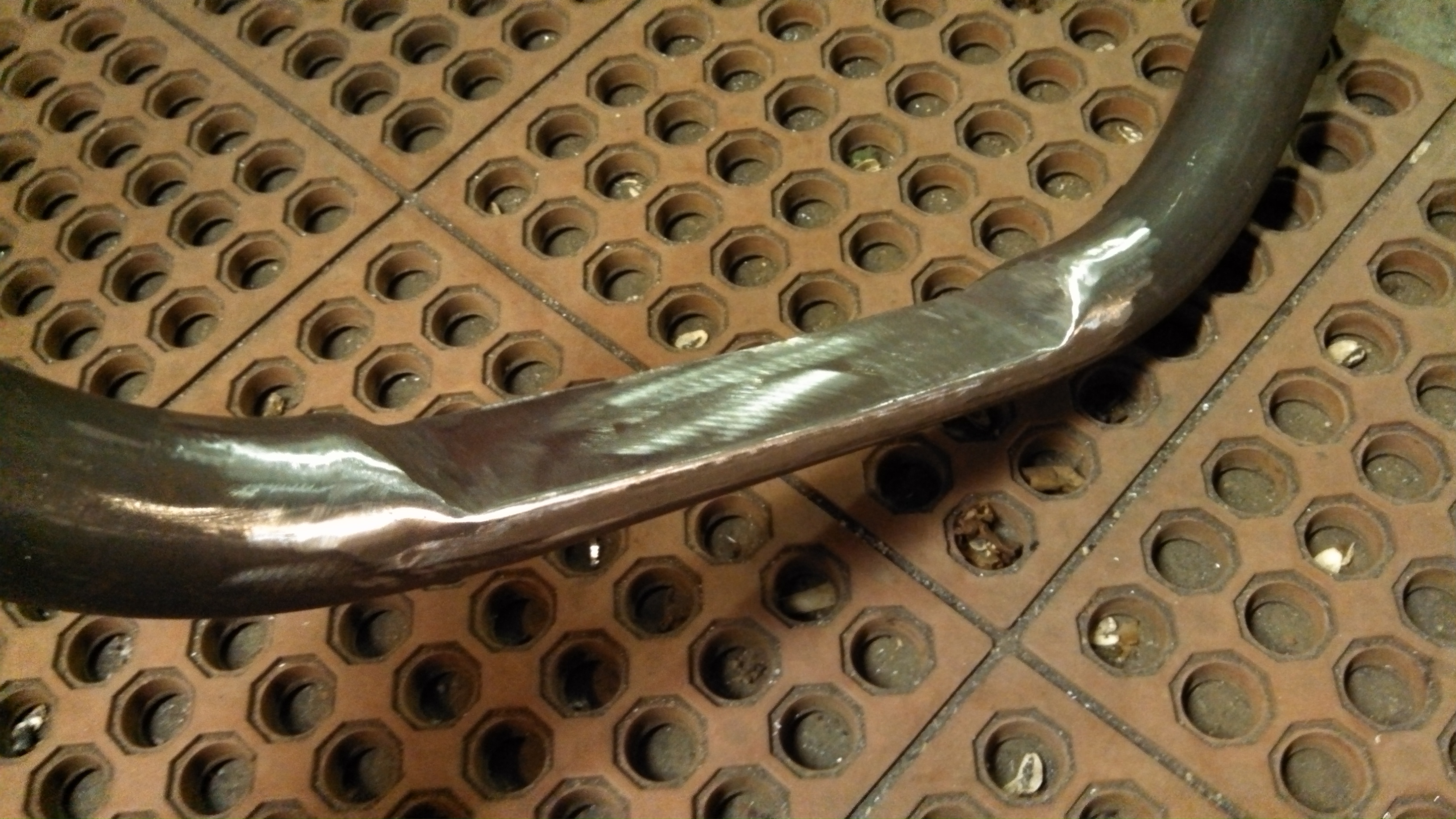

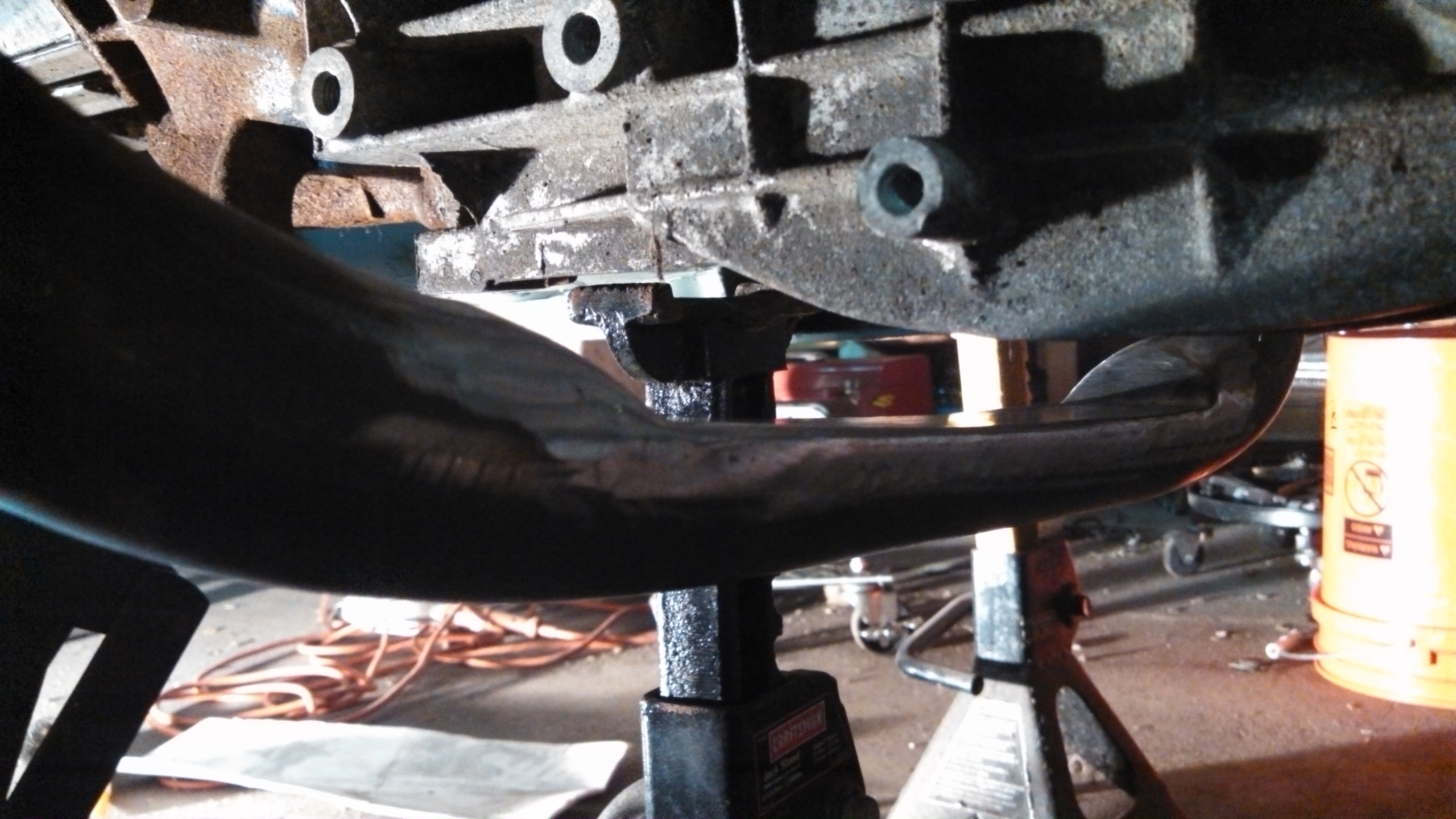

UPDATE!!!
Let’s get caught up. I’ve been working on the subframes and they are coming along nicely. The front is definitely more challenging to fabricate than the rear. The rear diff output cups are much more centered between the SF mounting points, so the c-arm mounts will be much easier to make. Then there is the front, with the engine/trans mounted lower and rearward. This puts the front output cups much further rearward and it’ll just be more difficult to make the front c-arm mounting tabs.
Here is the front transverse member of the front subframe, finished welded and reinstalled.
front sf front transverse member.jpg (1.2 MiB) Viewed 45848 times
front sf front transverse member2.jpg (1.19 MiB) Viewed 45848 times
And here is the tranverse member that will go under the bellhousing. The trans is mounted pretty low, so I relieved the tubing and used a thick plate and some endcaps, welded it up and flappered it reasonably smooth. I’m just holding it in the pic, and might trim the bottom of the bellhousing fins down a bit.

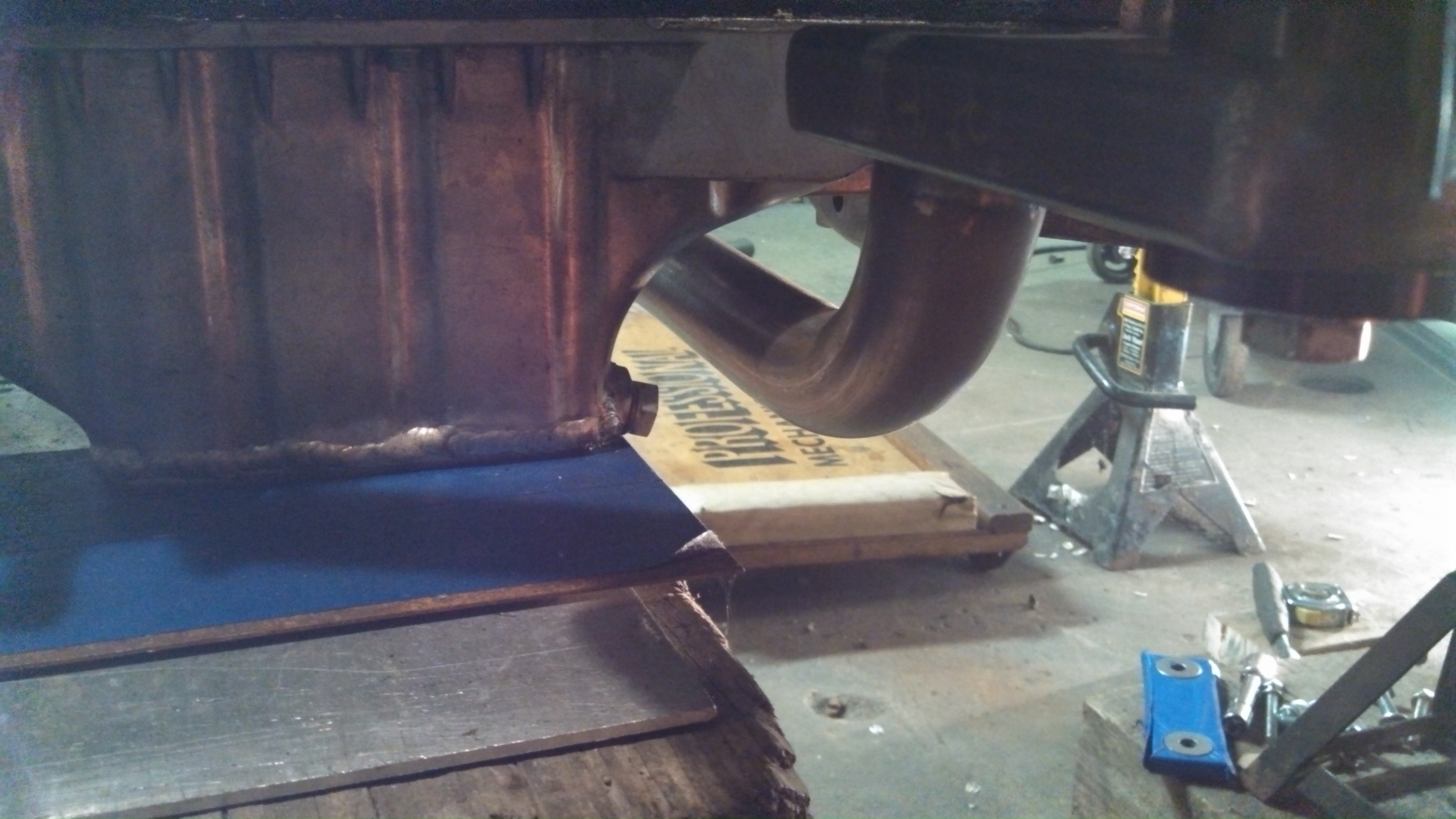

front sf under trans relief.jpg (1.5 MiB) Viewed 45848 times

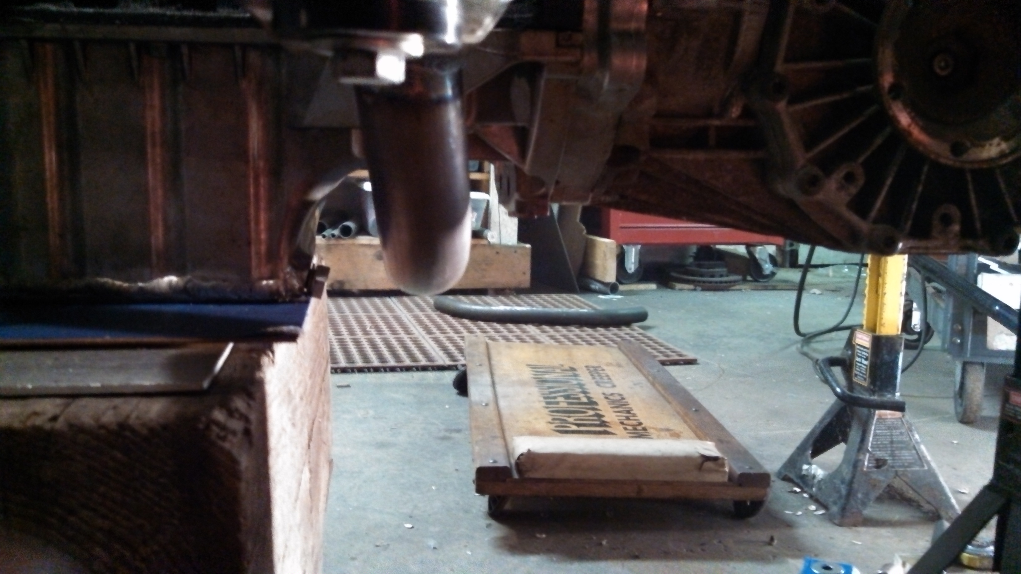

front sf under trans relief to be mounted.jpg (1.41 MiB) Viewed 45848 times
And lastly a pic of the top of the coupler nuts that were trimmed and welded into the rear subframe to mount the removable piece.
rear sf removable nuts welded.jpg (1.83 MiB) Viewed 45848 times
