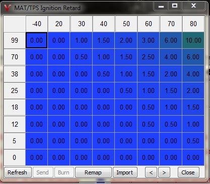

Thanks Matt. Here's the mat/ign retard table I'm running. How much more retard are you thinking? I haven't messed with this table much. I made it more aggressive than the basemap was, but...
Re: Road trip! Going to Cali from Colorado...
I just went through mine, and I believe I took out another degree, or more depending on the cell. I didn't go crazy but definitely more aggressive than stock.

When you leaving? I'll see if I can get a ss before then but your table looks good if you took out another degree over the base map. If you're not getting too bad of pinging, that table plus a degree or two out in the higher boost cells should fix the problem.

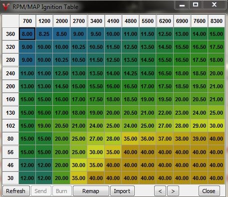

Tuesday. This is what my timing table looks like too:
I can see where I can take out some above 102kpa/3400rpm. I was going to drop boost from 22psi to 15 or so...

What does MAT/TPS ignition retard have to do with altitude change? That table is fine as-is

Regarding timing...thinner air means less compression, which = slower burn, so more ignition advance is ideal at altitude. So yes, pulling back the timing a few degrees would be your best solution. You can adjust the table or TDC after the trigger, it accomplishes the same thing.
