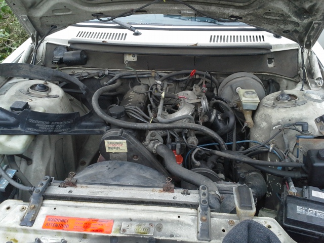

Clean the engine bay
Sandblast/powdercoat manifolds, etc.
Replace and odds and ends in the process of cleaning

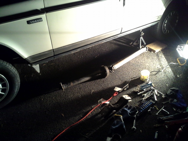

Let's run through the driveshaft rebuild:
1. Disconnected the driveshaft intact.
No-wheel drive conversion complete!
Pretty simple, made some half-assed alignment marks that mostly wore off during cleaning (luckily there are arrows etched into the two shafts), dropped the crossmember (sandblasted and powdercoated as a sort of test by vt10vt) and
2. Disassemble.
Separating the two sections is simply a matter of sliding the splined shaft on the rear section out of the front section.

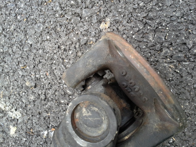

The u-joints were a different story. One of the rear joint's bearings/cups was completely failed and seized into the yolk.
The spider took a beating.
Here you can see where the rollers inside the bearing were smashed into the spider, pretty wild IMO.
I tried to press them out with two different vices and a socket, no luck whatsoever. Tried hammering them out, nothing. At this point I was nervous about damaging the driveshaft components and running out of options so vt10vt came through with a connection at a machine shop and he pressed them out no problem for cheap. :hail:
So, here's the rear section with the new joints:
I was stupid and in the process of trying to get the c-clips out with a variety of tools other than the proper one I broke both ends off of one, but getting that out was the only complicated part.
Luckily we had a precisely 3 1/4" c-clamp (because it barely fit over the yolks) that managed to press the new cups in brilliantly.
