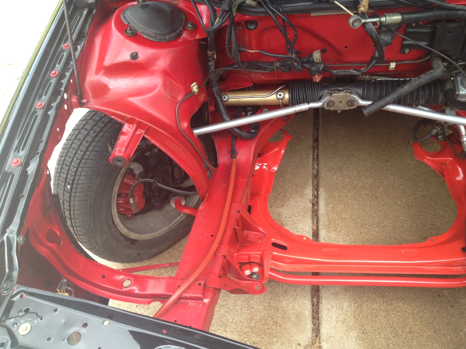

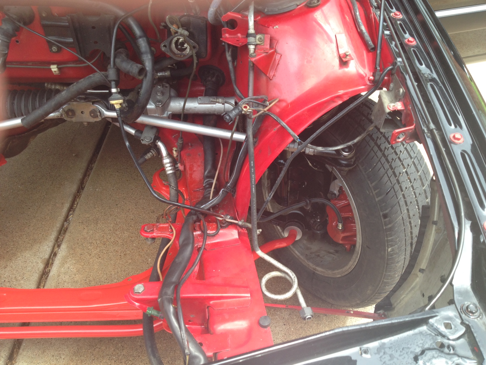

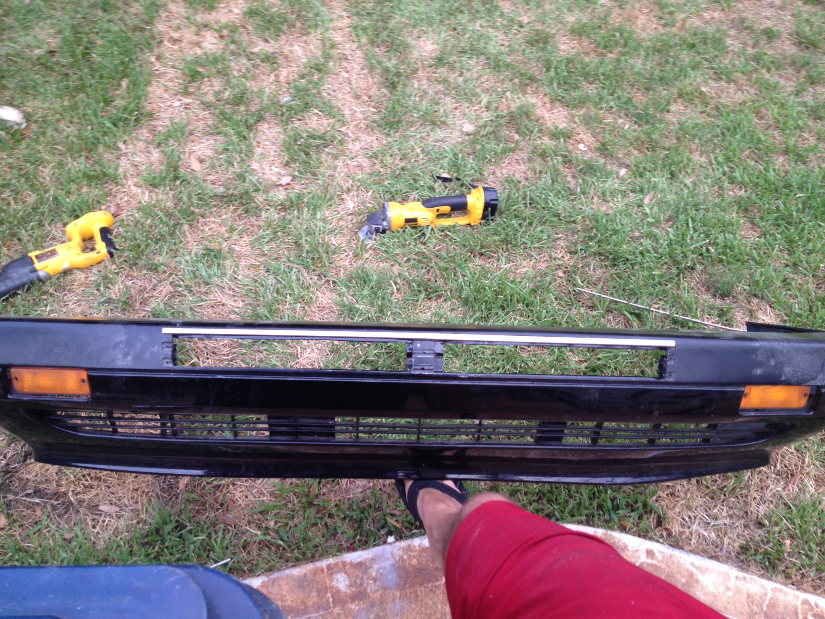

I finally got the car rolling again this weekend. I would hate to have to change out the rack in pinion in this car with the motor/trans/exhaust still in the car. I'm ordering a new set of wheels and tires on Tuesday from Discount Tire and then I should be ready to ship the car to Hank.
Two weeks later, 10 cans of degreaser, busted knuckles, 20 rolls of paper towels, two scrub brushes, two cans of brake cleaner, two cans of WD40, a little powder coating, and I finally got the engine bay cleaned up.
I removed the ''bomb'' , hydra boost, and ABS module. I'm really hoping for an engine bay where I can at least reach my hand in to work on something if I had to.
And I really, really, really hate oil leaks. I am hoping I can run a different power steering fluid. I hear that you can run some other fluid that is less likely to leak than mineral oil. Supposedly it is a little thicker and is less expensive. The recommended fluid by Audi is for cold weather and I will never have to worry about that.

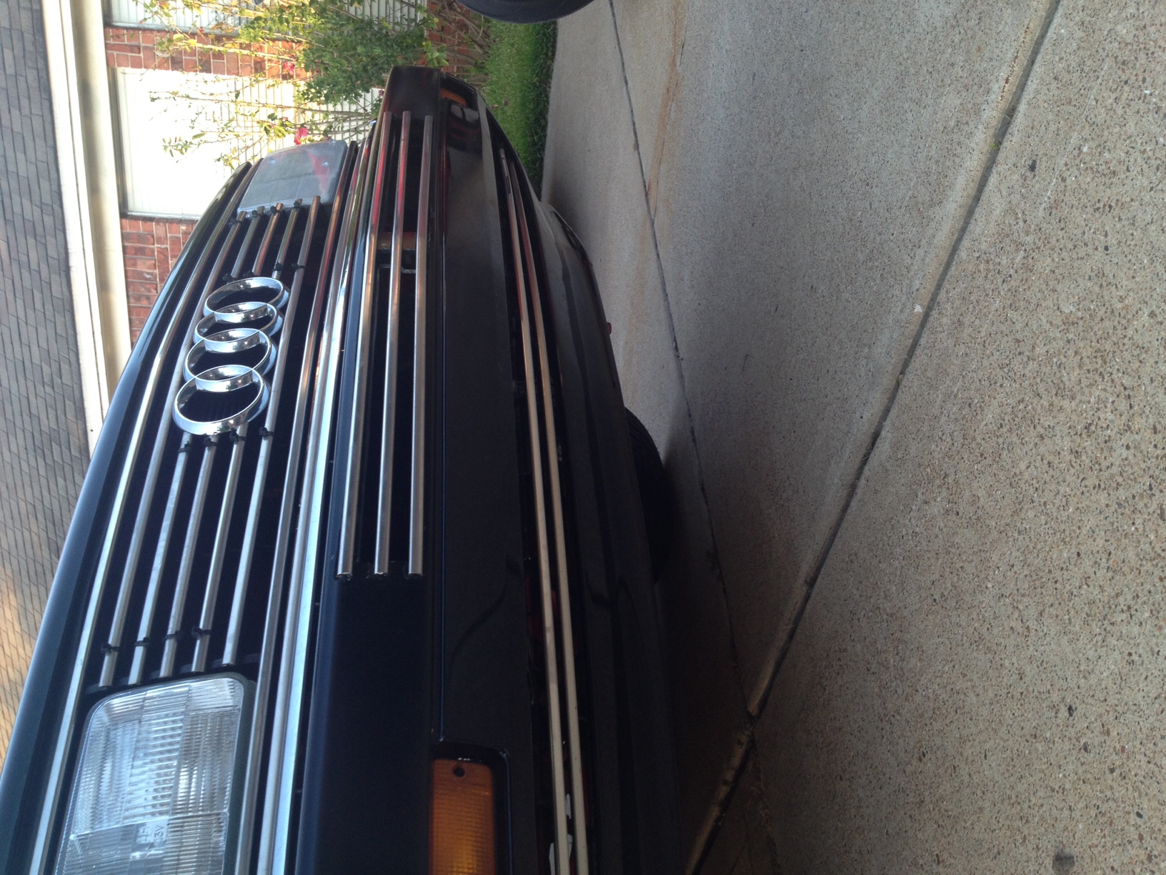

I also finally finished cutting out the area of aluminum bumper reinforcement where I added the billet grille. This should help add some air flow to the intercooler.

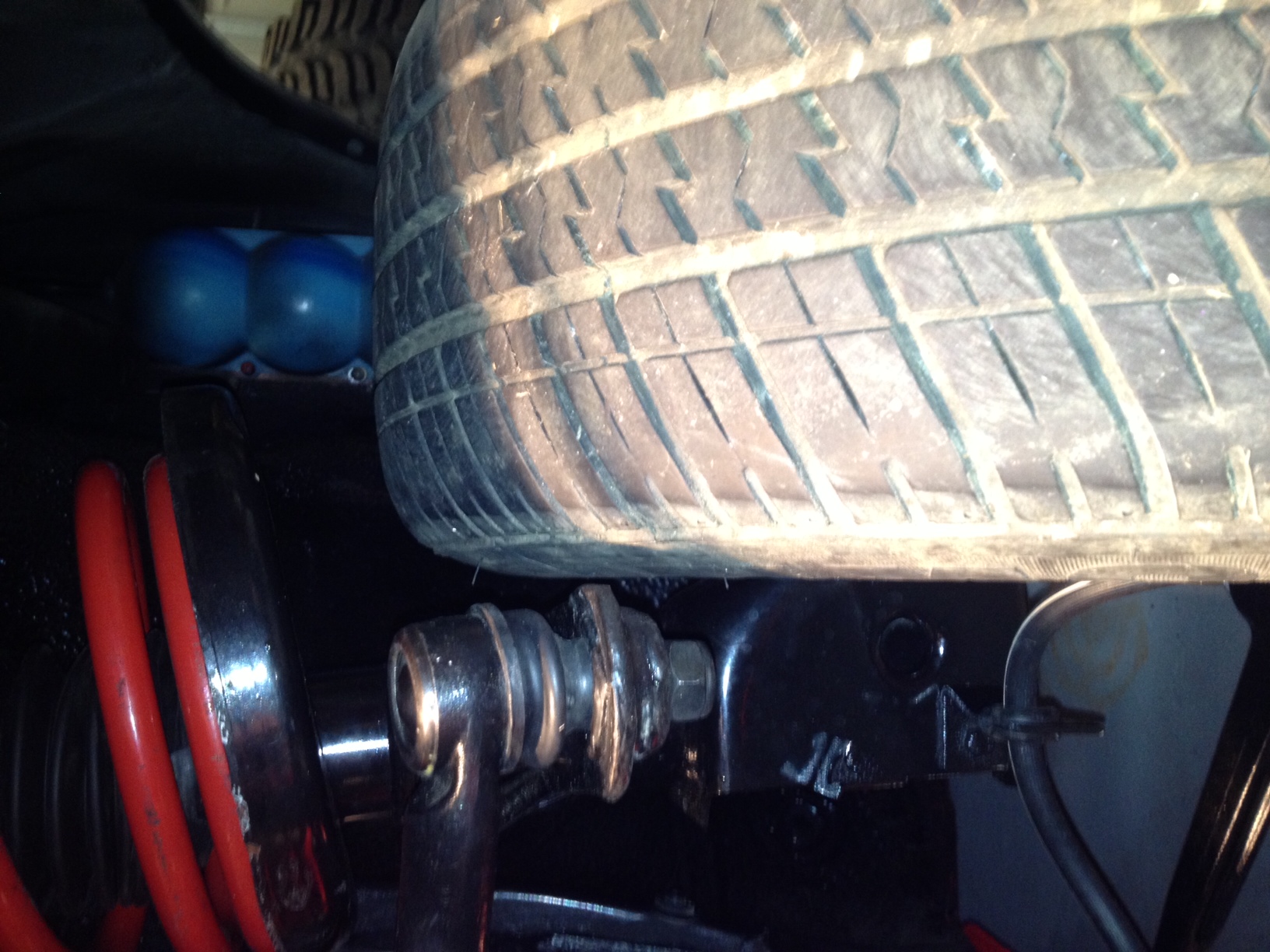

I snapped a picture to give an idea of just how close the tire runs to the steering arm. These are factory size 15'' wheels with factory tires. Not much room for play. Discount said they know the right size wheel and tire combo to go to 17''. We will see when they come in.
wheel tire clearance.JPG (574.05 KiB) Viewed 37176 times
Re: Josh's 2.5 200QT
We can rotate those steering arms in slightly as well, which would pick up a little more offset/tire width capability.

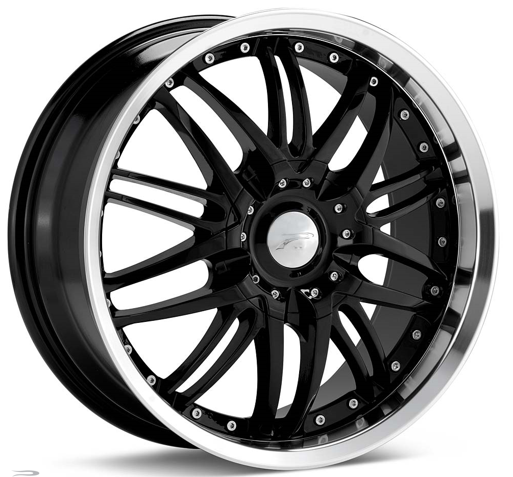

I got impatient and want to get this car shipped out. I'm tired of researching wheel and tire combos and digging through forums. I ordered a set of 17''x7.5'' 5x112 with a 40mm offset. They are Platinum Apex, Black with a machine lip. There are heavier than I wanted but not as heavy as the ASA ASR1's. I got new Goodyear 225x45x17 tires and new wheel bolts. Discount Tire should have them in by Saturday. The only thing that I have to research is my hub centric rings. Discount said they would find them tomorrow, but I want to make sure they are right. They guy at the counter seemed pretty new on the job. If these don't fit right, he said they would take them back. He will mount one tire on the wheel and let me take it home to fit test it before mounting the rest.

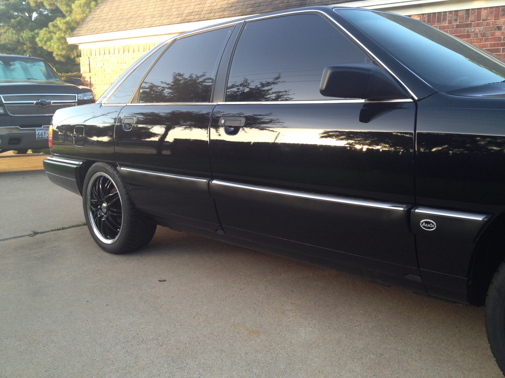

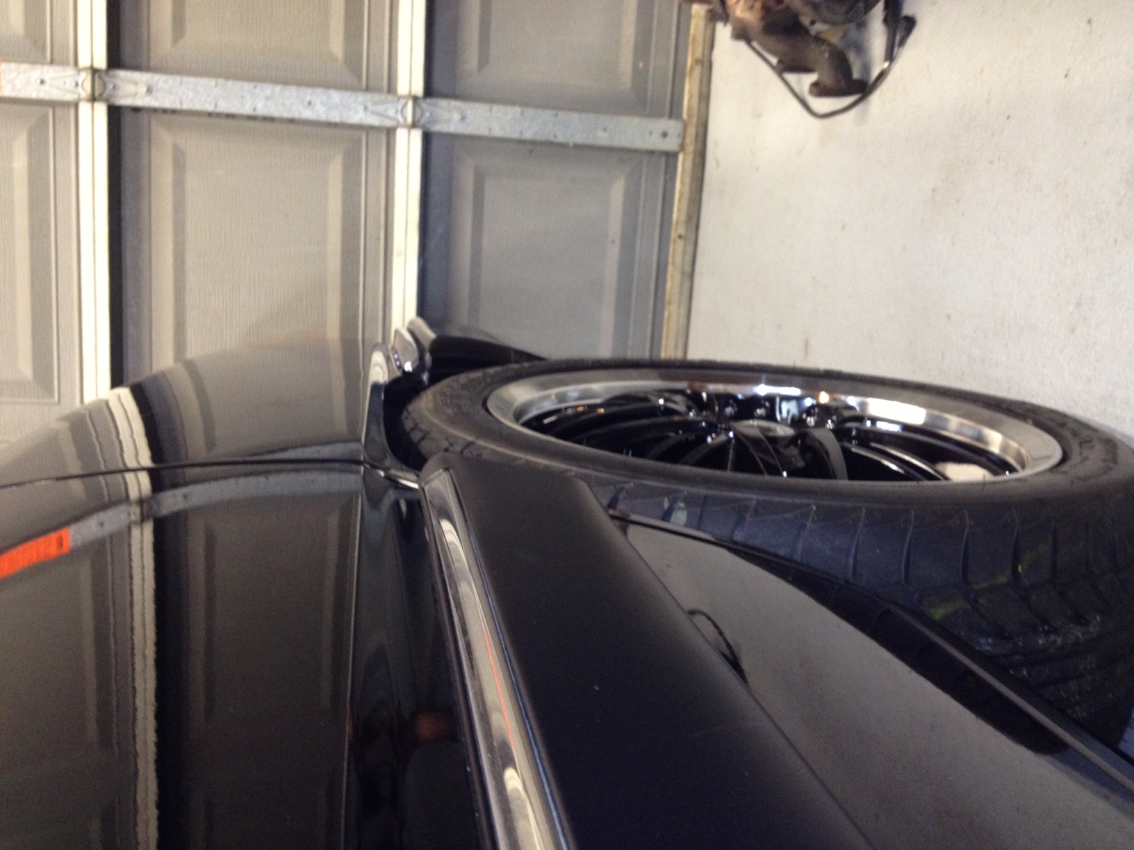

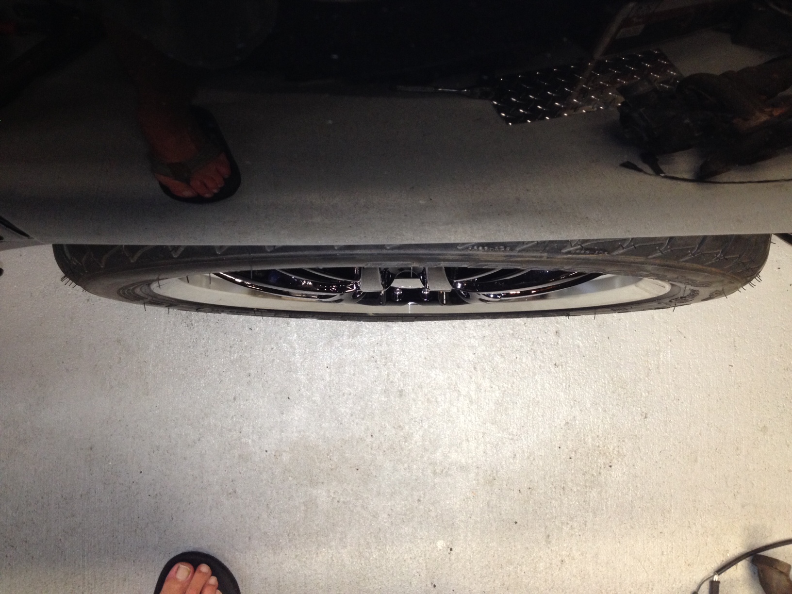

Post by 2.5TYPE44 »

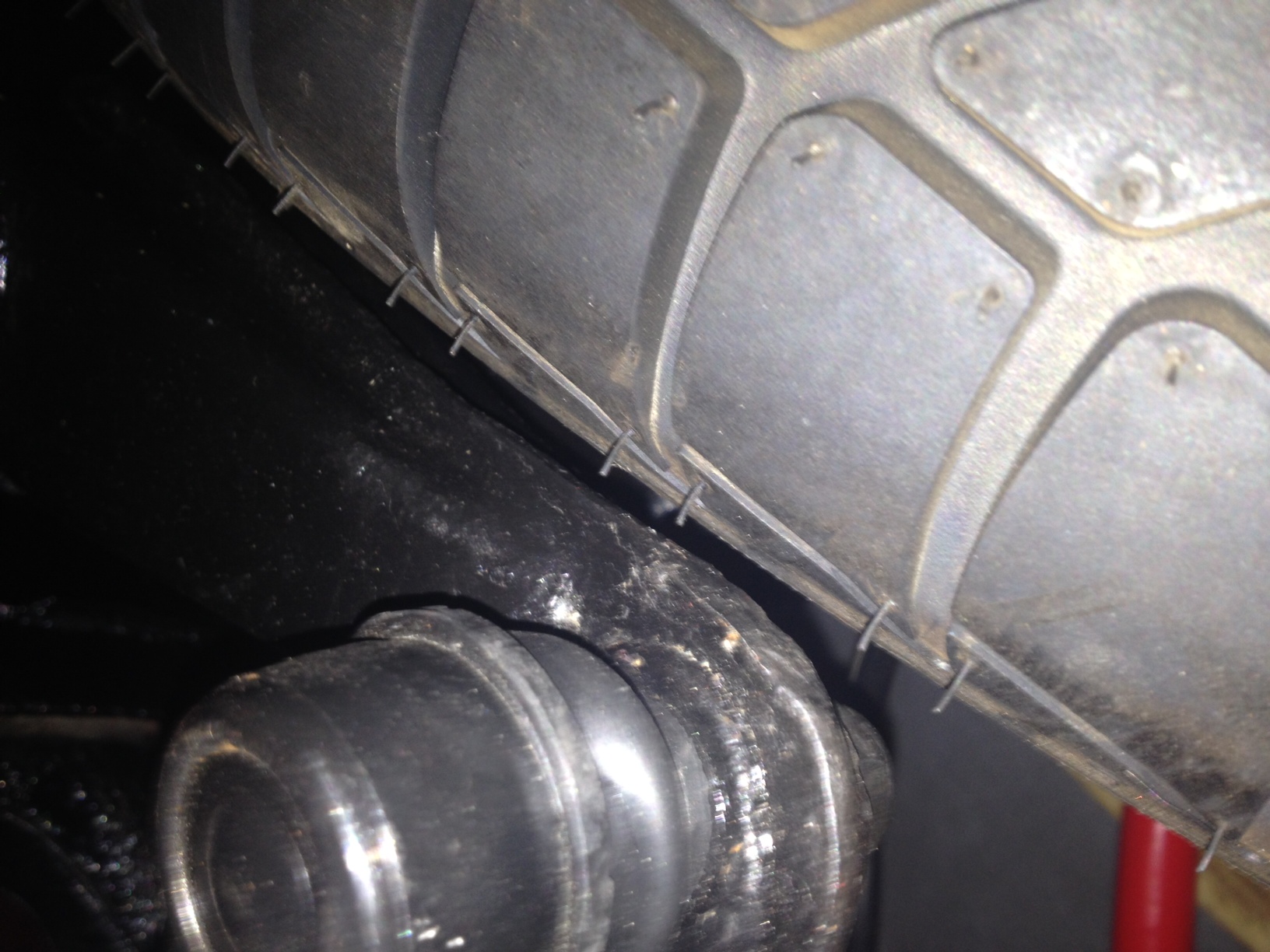

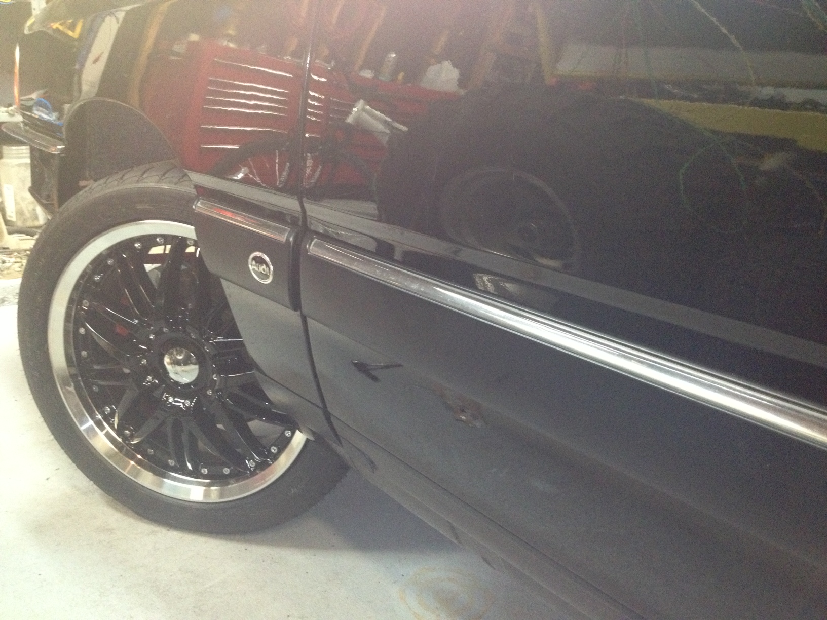

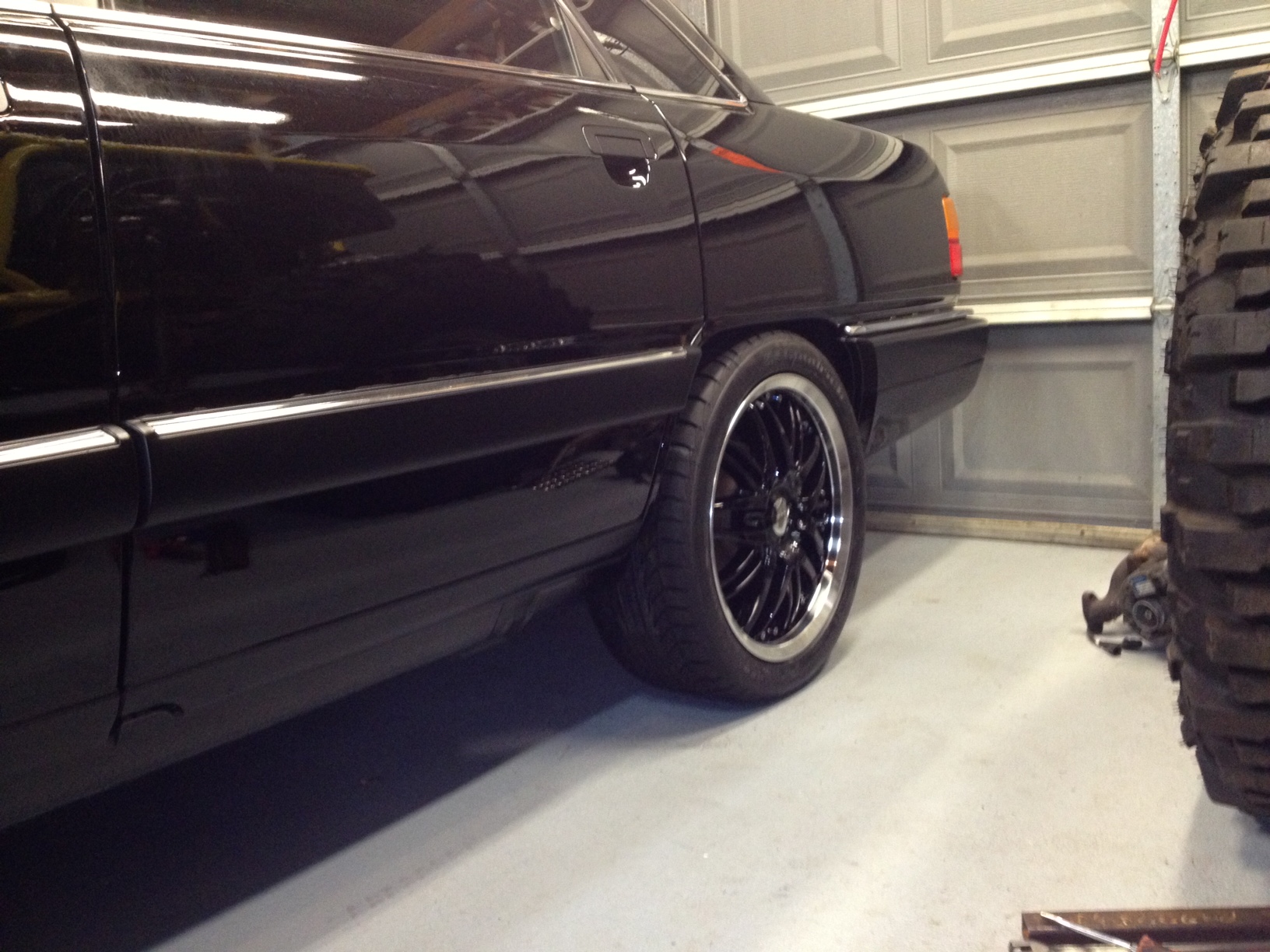

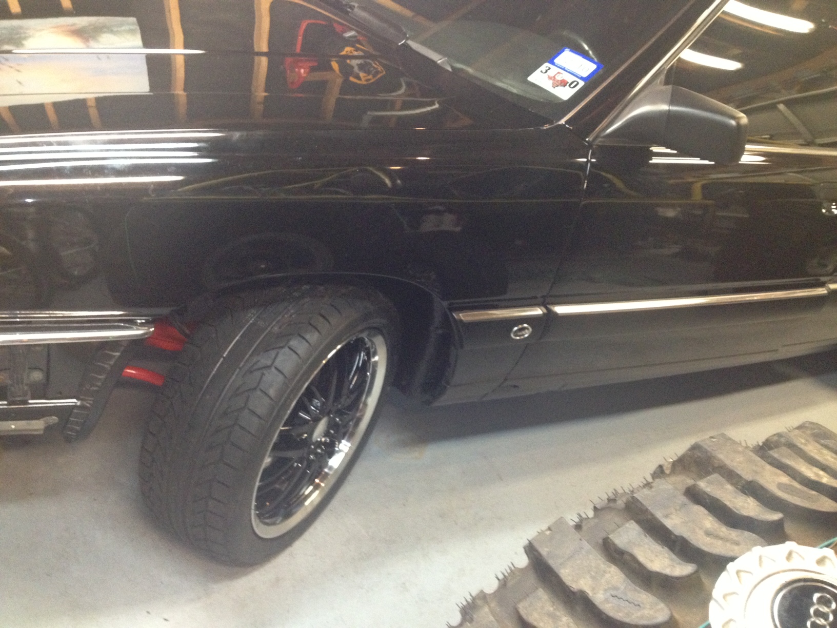

The wheels and tires came in and I guess this is where I should have done more research. So if anyone that owns a 20 valve 200 body style, they can check this out for reference. I ordered my 5x112 wheels in a 40mm on a 17'' wheel and 225x35x17 tire. IT DOESN"T WORK. If you really want to cut up the rear fender, it might work. But after bolting the wheel and tire on the rear and bouncing on the rear suspension, the rear fender was landing on top of the tire. (not by much). The fender is double walled and is about 10mm thick from outside to inside. So I have returned the two rear wheels and ordered the same wheel in a 48mm. The front wheels and tire fit perfectly with 40mm. I will have the same size wheel and tire but will have to suck the rear wheels in 8mm per side. ''Staggered'' The new ider wheels and tires still just barely clear the steering arm in the front but should not be a problem. I think these wheels match the car pretty well.

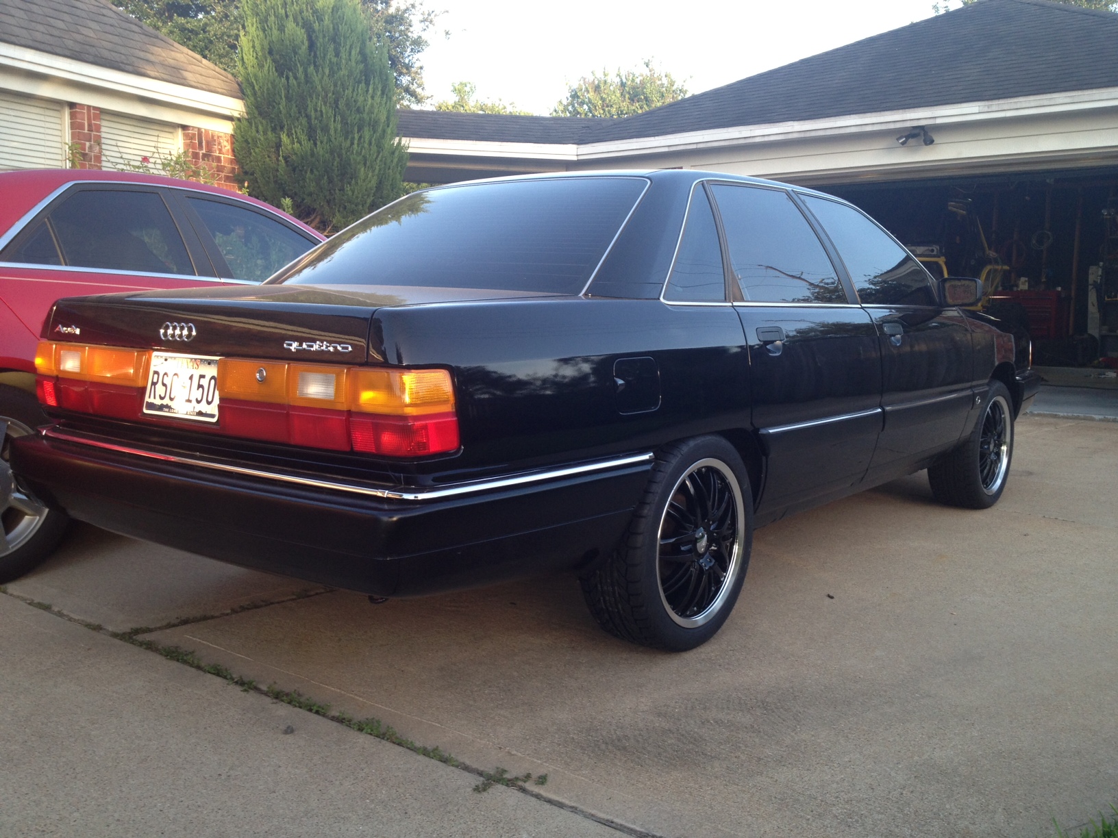

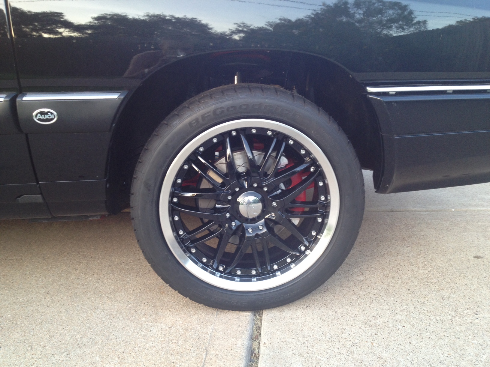

I finally got the wheels and tires. I have room for larger brakes now and hopefully I will need them :) I can keep playing with so many different things that I want to do to the car, but getting it running is more important. There is a bad ass engine and trans waiting in Las Vegas (Iroz Motorsport) and this car needs to hit the road. I can't wait to see it squatted down lower where it needs to be once the weight of the engine and transmission in. It looks pretty stupid sitting so high in the front. I still haven't done the upper portion of the grille which is why I still have the black zip ties. It can hold off until I start driving it again.
