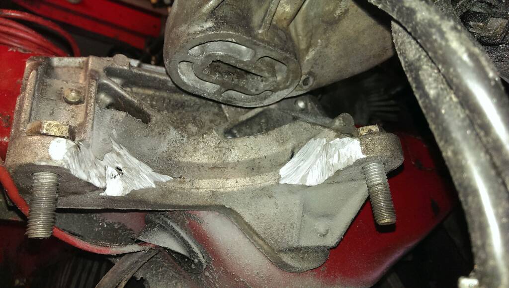

Spent a good amount of time bolting it onto the bell housing... Had to cut this off we I had totally forgotten that UrS blocks need this dowlpin removed in order to mate up to the 6speed 01e...

Whooooops...oh well..

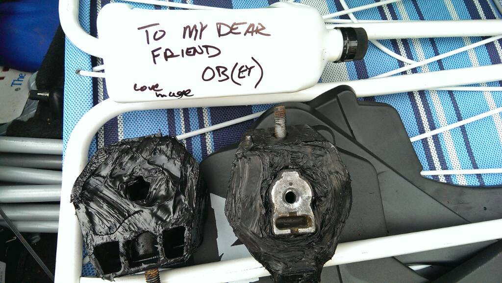

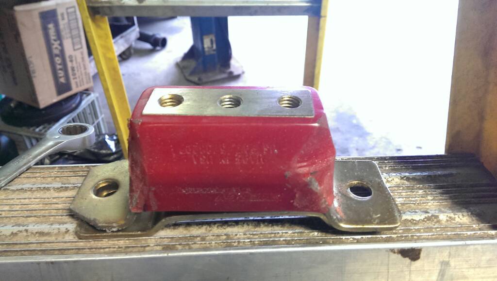

Not yet... I did pick these up locally in the meantime along with a rubber snub to compare...

mushasho wrote:
Toph wrote:Whooooops...oh well..
Did the snubber arrive?
Man that's an ugly goopjob. How many bevs did Mage have before slathering those things together? Maybe not enough.
Actually I needta talk to him, I might do some Bimmer subframe bushings that have cavities and was thinkin of doing the SlaterMount/MageMount/AnybodyElseMount trick to 'em....
JC
2003 M3Cic TiAg
2002 540iT Sport 6MT LSD TiAg
1995.5 Audi S6 Avant (the turbobattlewagen - now with Moar RS2 Billety goodness)
Re: A tale of Rubí... Block bolted up awaiting mounts...w/PI
haha fukhed.
The only improvement on this design would be if I had a welder capable of welding a face plate to completely lock in the rubber. Good news is those were wire brushed, and set with 3 separate layers over a period of 96 hours. The beautiful tinsel gloss is a nice 3M paint that is washable and will protect the actual 3M window weld through the snow and salt.
Run some neoprene/rubber washers under the nuts for silky idles!
but yeah... I was drinking.

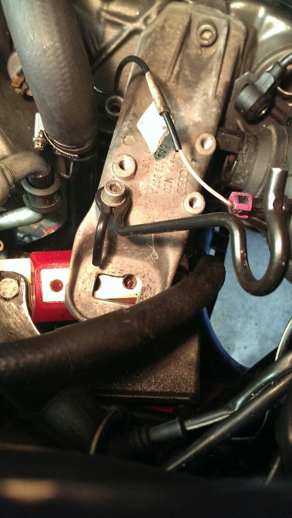

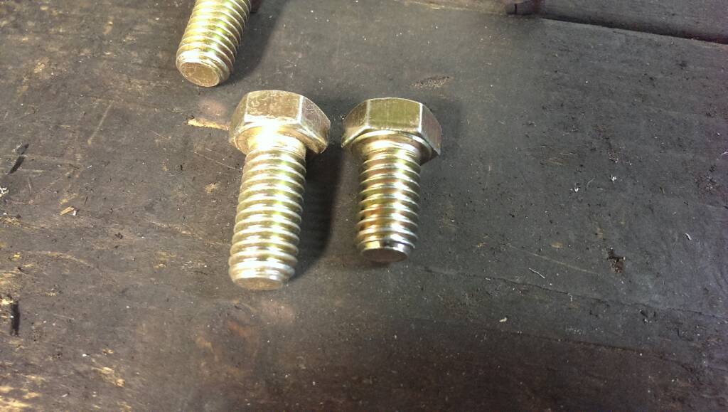

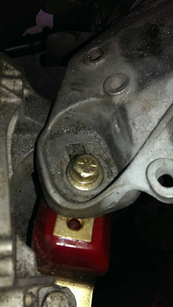

One thing that's a must was to use 1" bolts as opposed to the supplied 3/4" that come with the mount...

mushasho wrote:Spent a good amount of time bolting it onto the bell housing... Had to cut this off we I had totally forgotten that UrS blocks need this dowlpin removed in order to mate up to the 6speed 01e...
you know it just pulls out with a big pair of channel locks right?
Not on this one for some reason...

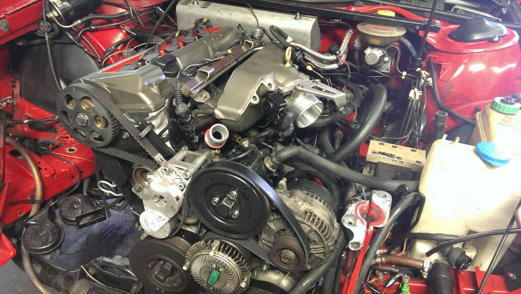

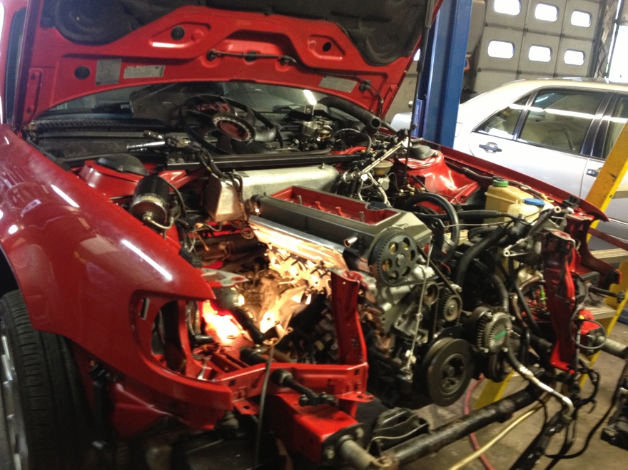

Quattro-JC wrote:Dropped in on to add my useless oversight to the process today... things comin' together!
Obes I suspect without the Mustang Mount side project you'd be drivin around tonight! :D
Hey, "no radiator in the way" shot for Ed... Didn't see snap that...

mushasho wrote:Not on this one for some reason...
Not enough muscle.. or big enough channel locks .. or both :D

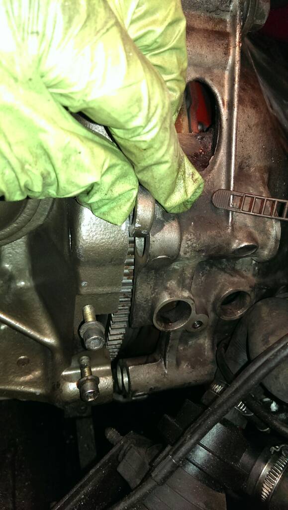

Almost...

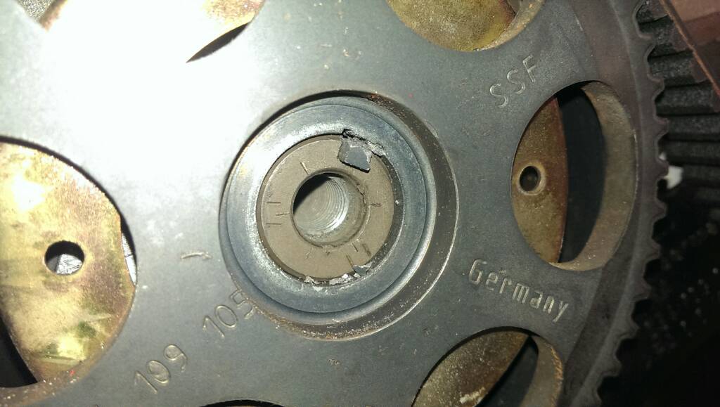

These suck...
DuBistS4
Posts: 76
Joined: Sun Mar 10, 2013 8:32 pm
Location: Westchester NY
Re: A tale of Rubí... Coming along...w/PIC
Post by DuBistS4 »

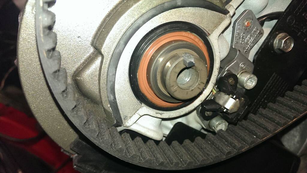

lol I broke mine too by turning the motor over by hand without torquing it. I dont think the key way is meant to handle any load what so ever.....its purley there for locating it. My car survived the dyno without a proper keyway in it anyways. But im still looking for a replacement....
Ended up with this...
Toph
Posts: 314
Location: NH
Post by Toph »
Bah, that's no good...but at least you have the replacement there, and it looks like the cam is ok...just a speedbump!

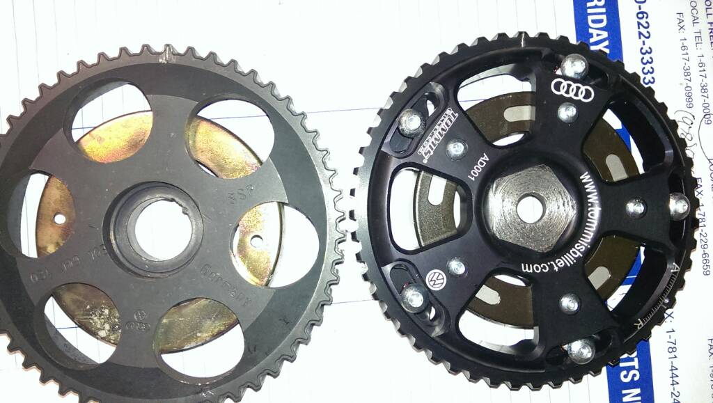

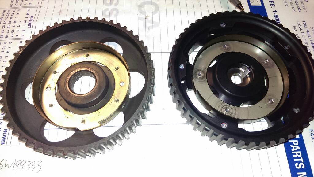

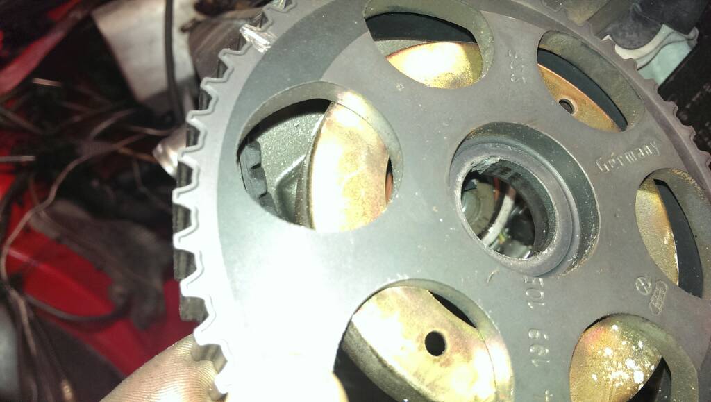

It looks like the adjustable cam gear has no key way, is that correct?
'94 UrS4 Red/Black
Vems
Lightly modded head
-Will
DuBistS4 wrote:It looks like the adjustable cam gear has no key way, is that correct?
