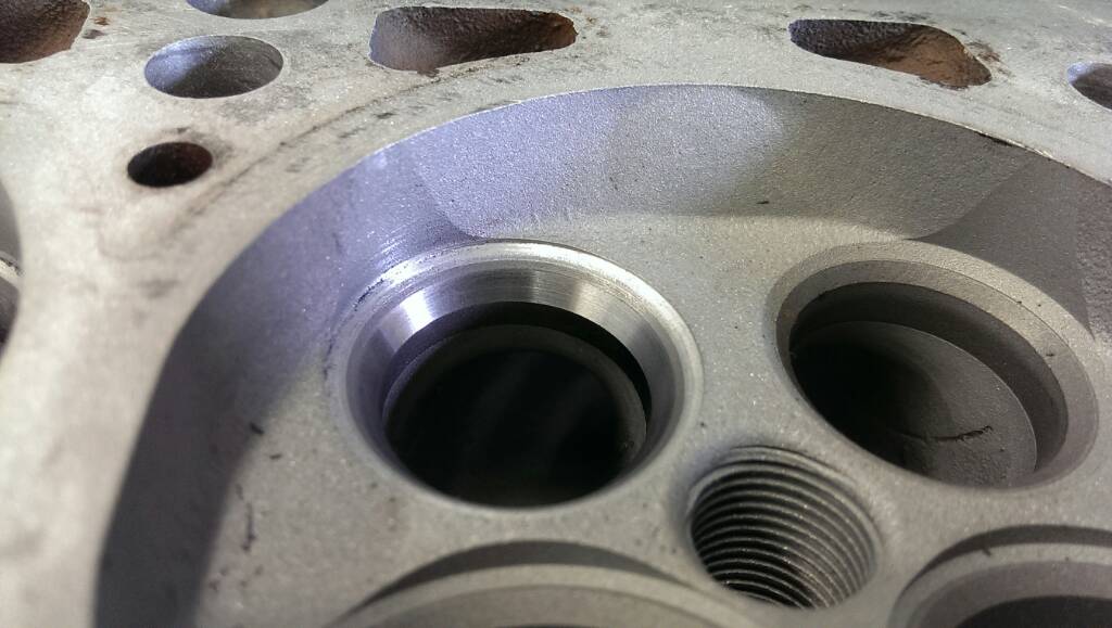

Well, as usual with any build, a hurdle has risen... The machine shop cutting the seats calls me in to have a visual inspection of what he's encountered with the head.
I prescribed cutting the OE valve seats to accommodate larger valves. They go ahead with one exhaust seat and finds that our seats are the same size as the valves and when cut the valve itself doesn't rest on the seat but protrudes into the aluminum portion around the seat as well.
Is this normal? Usually seats are larger than valves and allow for cutting but it doesn't seem like the case on our AAN heads... If I need to reseat the head, I'll just slap my old head on it and run a stock port as I'm not about to spend another grand on that...

Re: A tale of Rubí...PTE5862 .64 a/r Received, Head Rebuild
Post by DuBistS4 »
.5mm oversized? My valves went in with no issues like that, but they were only .5mm oversized.
'94 UrS4 Red/Black
Vems
Lightly modded head
-Will
Yeah +.5mm
Yours went in without a recut?
DuBistS4
Posts: 76
Joined: Sun Mar 10, 2013 8:32 pm
Location: Westchester NY
Post by DuBistS4 »
No they were recut but everything fit correctly.
'94 UrS4 Red/Black
Vems
Lightly modded head
-Will

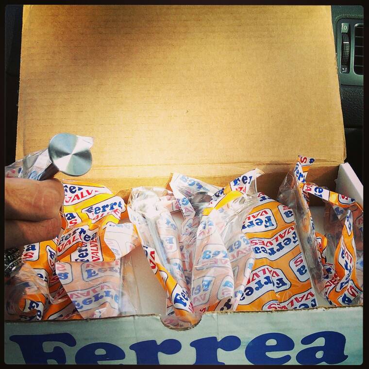

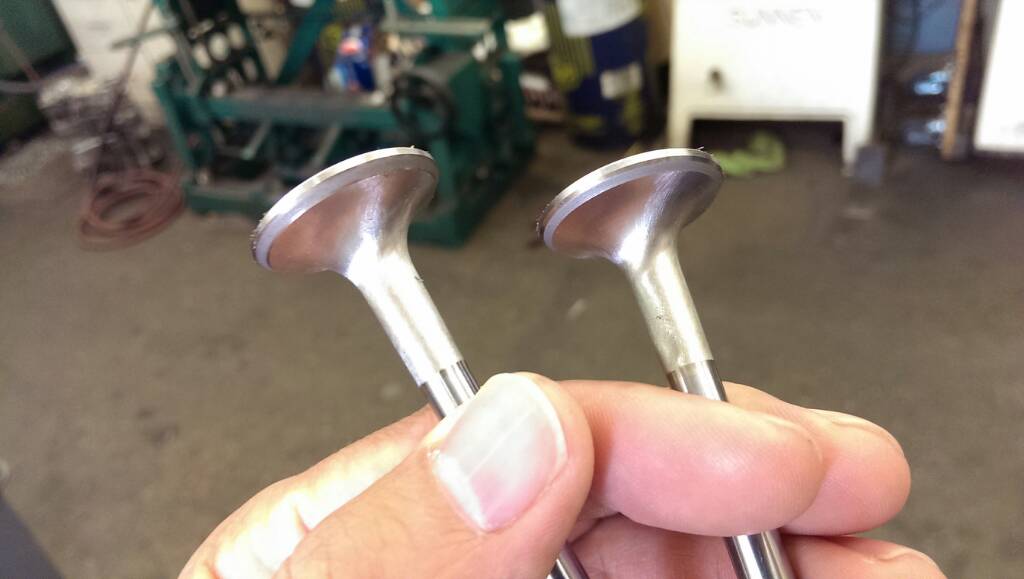

Intake valves (10) F6030
- stainless steel dish face
- 32.5mm head diameter
- 6.96mm stem diameter
- 2.6mm tip length
- 95.5mm overall length
- 15? Super Flo. Radius Groove +0.5mm oversize
Exhaust valves (10) F6028
- 28.6mm head diameter
- 6.93mm stem diameter
- 2.8mm tip length
- 98.3mm overall length
- 22? Flo. radius groove +0.5mm oversize special alloy

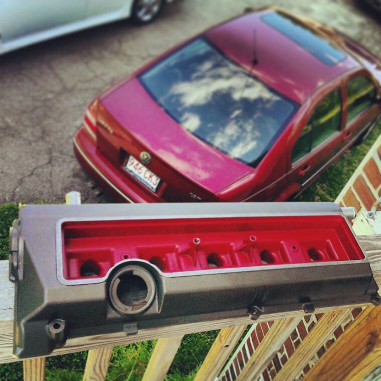

Re: A tale of Rubí... Valve Cover
Finished the valve cover paint scheme...
Post by da_trem »
Odd..I'll be using the same brand/size valves as yours..my head is also at the machine shop this week. I'll let you how it comes out.
Looking at your projet makes me think of mine, almost the same build as yours!
Looking great!
-Dave
95 Audi S6, VEMS, BW S362
00 Volvo S70 T5M
da_trem wrote:Odd..I'll be using the same brand/size valves as yours..my head is also at the machine shop this week. I'll let you how it comes out.
Looking great!
-Dave
Thanks Dave.... The approach we're taking is perhaps the most sensible in terms of $$ vs Gain... This being said I might just go stock port on upgraded exhaust valves.
