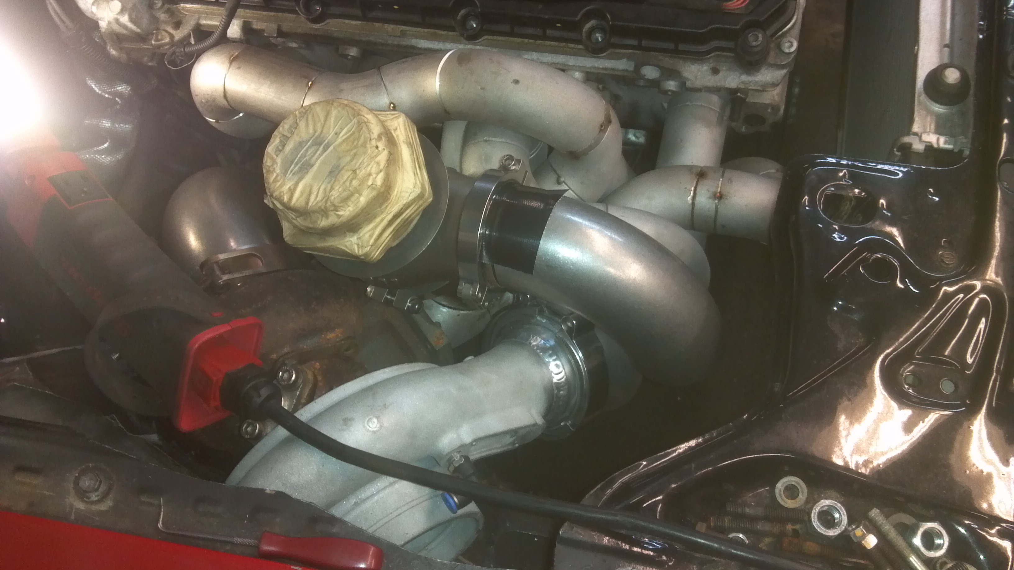

Heres a couple new shots...
Fits like a glove....a very big glove
No im not polishingy housing. Lol. I ground down the lip on the intake to weld a 45 right onto the hx40 comp housing to get the future joint location to a safer(cooler) location away from the header. I dont know if itll be a vband or a silicone joint yet, well see. The comp housing also had a casting seam on it so i just wanted to smooth that off, a bump next to "holset" and volvo. Still on the fence about the "vulva" mod. :-)
Thats it for now
Thats it for now

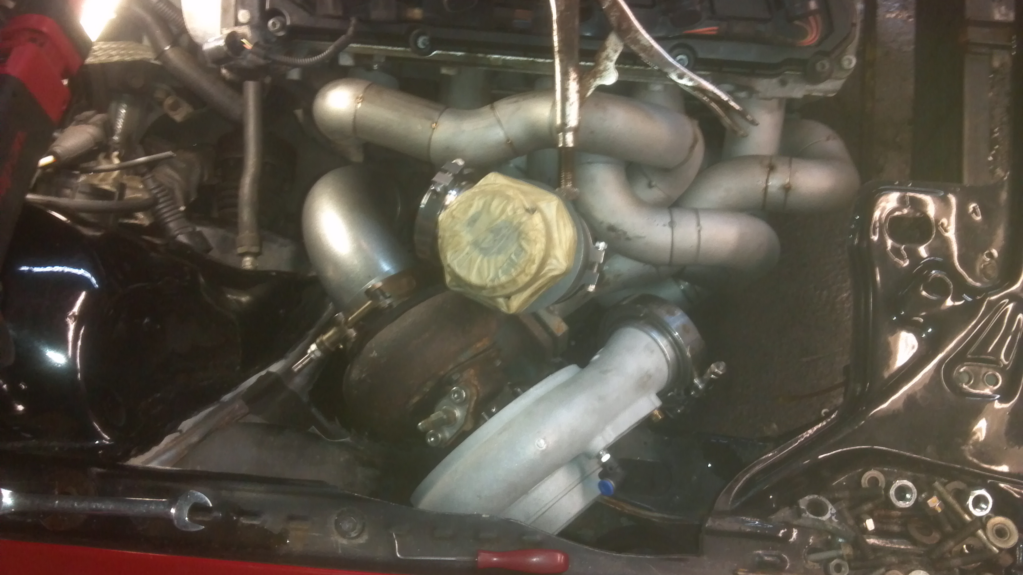

SO..got the primaries all finished. I'll report on lengths when it comes apart to be welded. 4 is def a bit short and everything else is prob -/+ 1", I figure its better than any old 20v turbo manfifold thats non tubular.
about a 1/4' to hood. 1/2' now
holset housing blended to 2.5 pipe size. Its getting a oringed vband joint.
back to header business..plenty of room! ha!
hope you enjoyed the show...

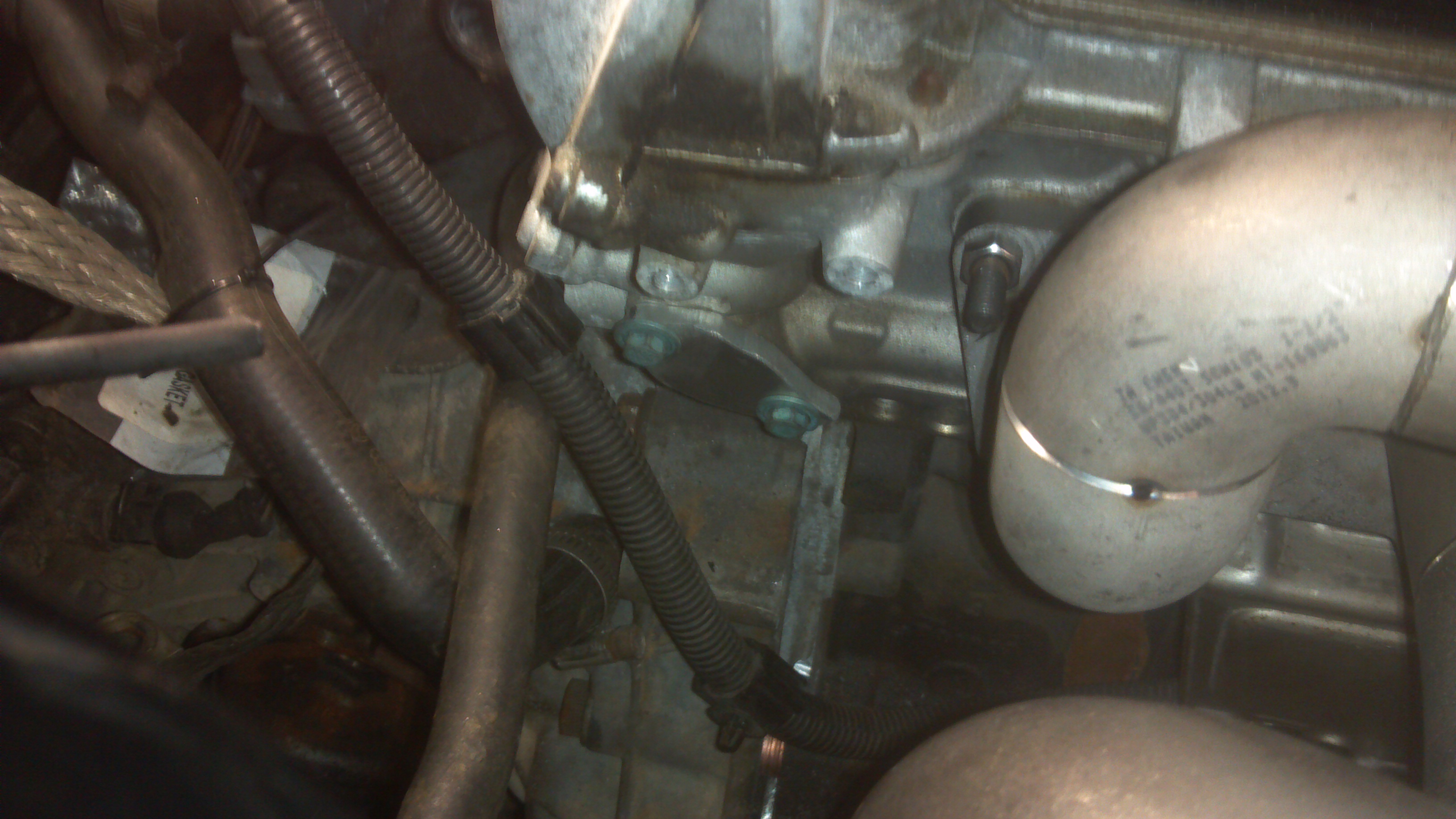

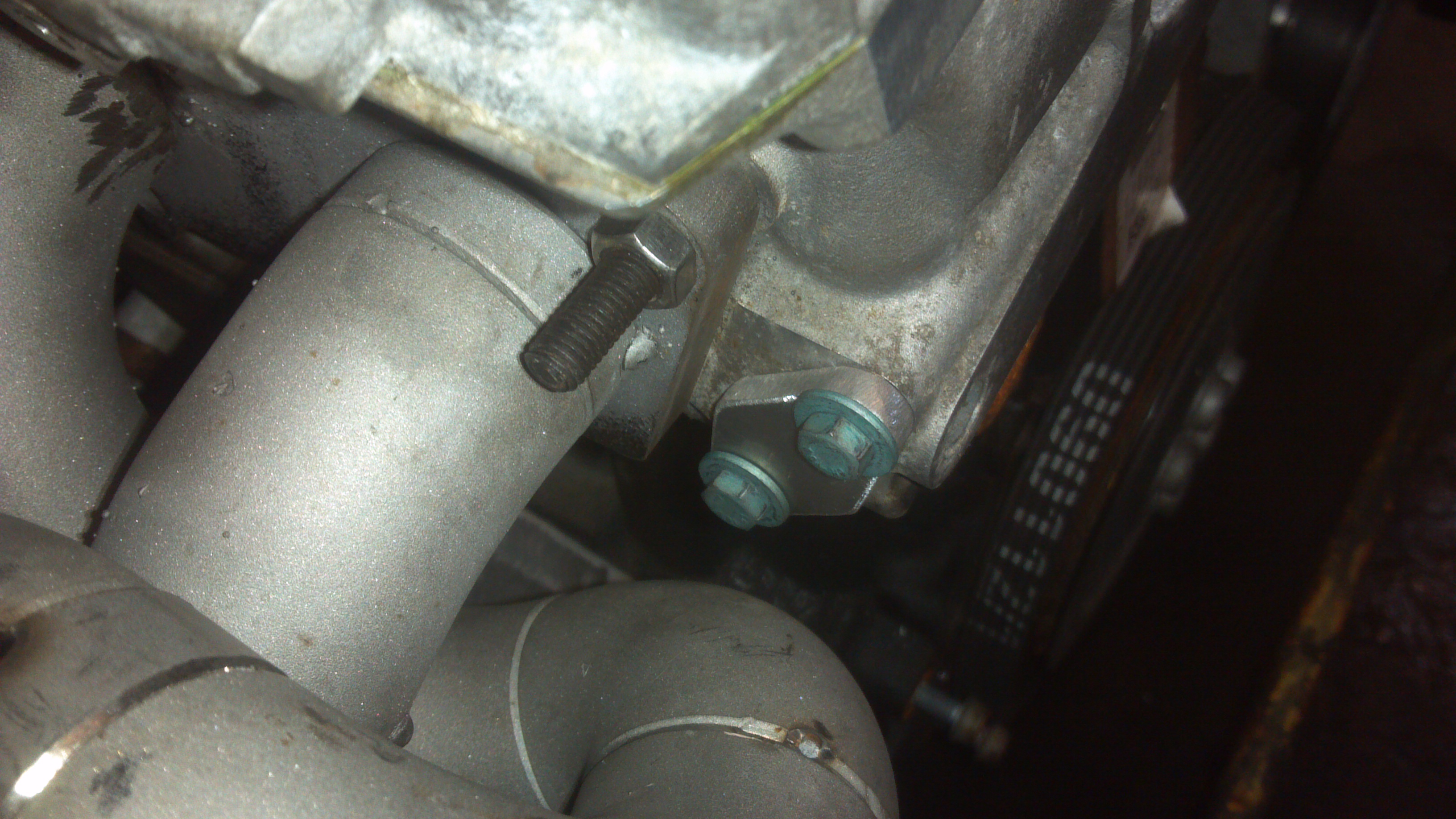

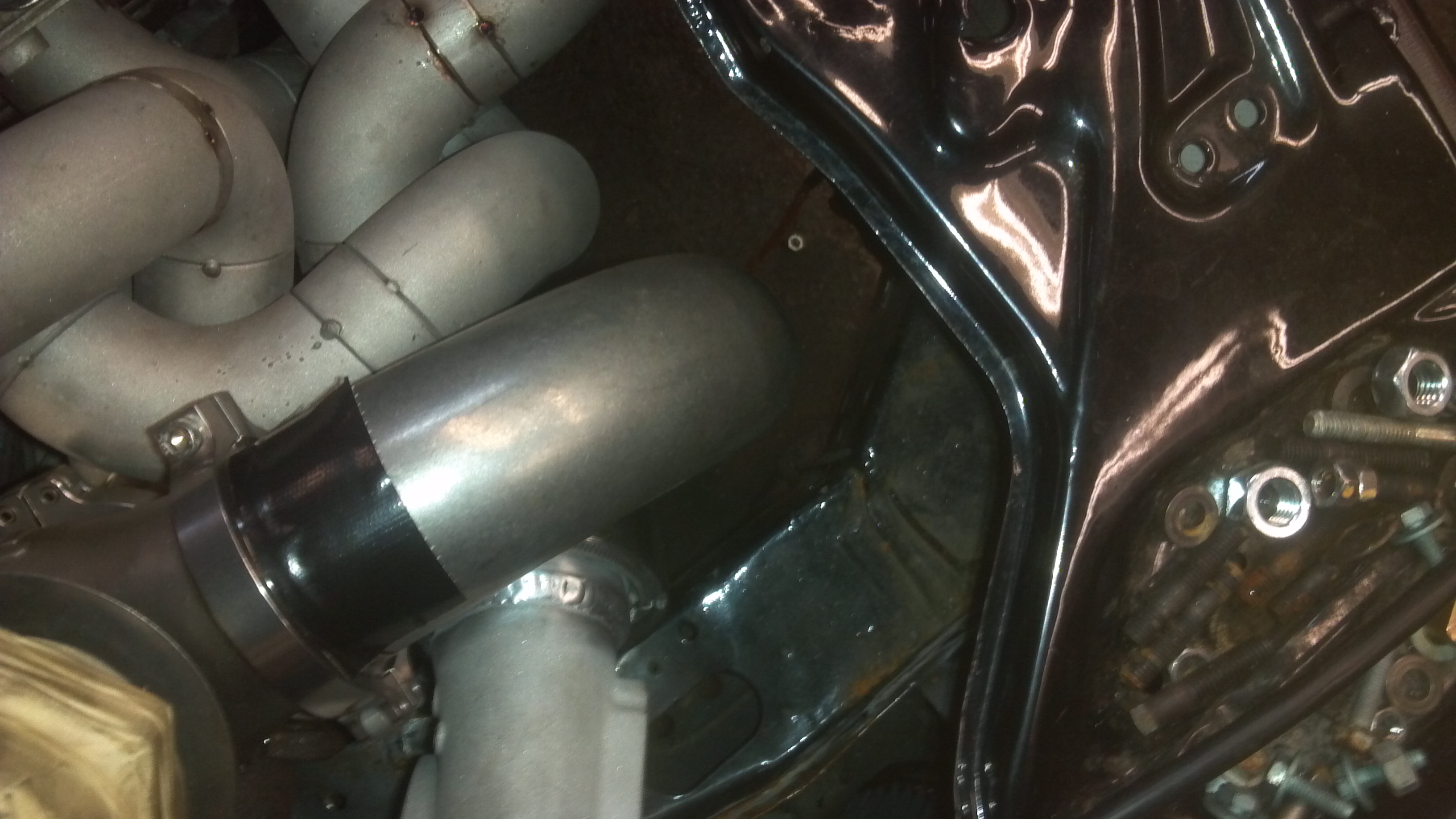

Small amount of progress...
- Other egr blockoff :-)
- 2013-04-12_17-36-28_777.jpg (1.07 MiB) Viewed 37218 times
- Egr blockoff
- 2013-04-12_17-36-22_854.jpg (1.51 MiB) Viewed 37218 times

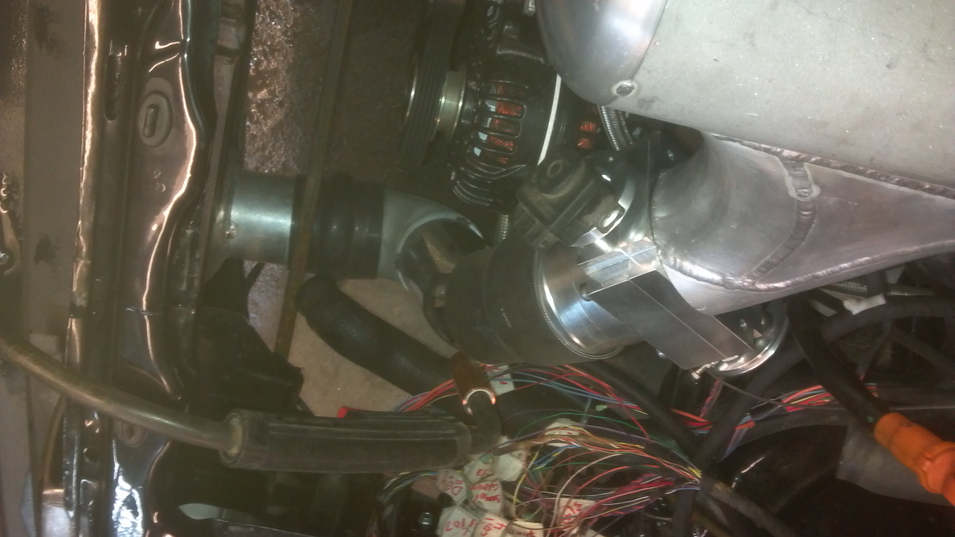

- Drivers side boost piping (3 inch)
- 2013-04-12_17-35-35_201.jpg (874.02 KiB) Viewed 37218 times
- Diff angle
- 2013-04-12_17-34-07_235.jpg (883.25 KiB) Viewed 37218 times
- Bit of dp progress
- 2013-04-12_17-33-48_62.jpg (762.47 KiB) Viewed 37218 times

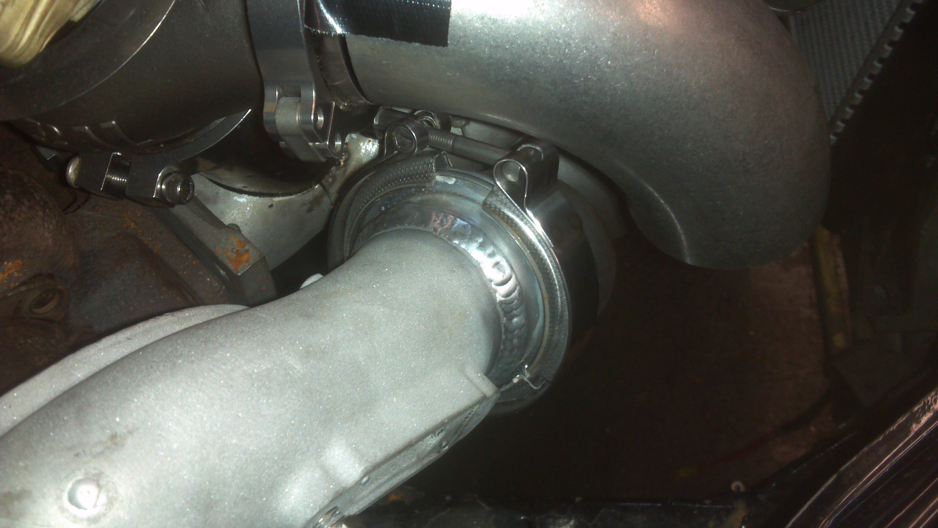

So i need to order a 2.5 45 deg alum bend. Aldo need to order fans for the rad, two 12" wont fit due to the 4" IC core. Before i can go further on the dp/wg tube i need the header welded. Then wg tube, dp, axles, oil pan, drain line fans....ummm more welding lol. Most the fab is done on the car besides the WG tube. Just a shitload of final welding to do. I think the car will be driven with low boost unbuilt for carlisle. I really want to drive it there and doubt ill have funds/time to build the block.
- Ryan welded my vband onto the hx40.
- 2013-04-13_20-17-44_144.jpg (1.18 MiB) Viewed 37203 times
- Plenty of room. ;-)
- 2013-04-13_20-16-11_70.jpg (975.11 KiB) Viewed 37203 times
- Screamer pipe mode. Engage.
- 2013-04-13_20-16-06_622.jpg (1021.04 KiB) Viewed 37203 times
